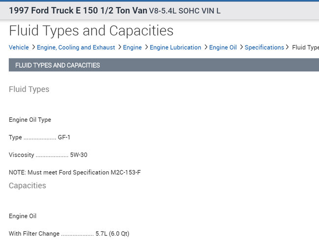

Hi, where is the oil fill cap located and what would be the best oil to use?
Mar 24, 2019 at 3:14 PM
SCGRANTURISMO
  • 4,897 POSTS

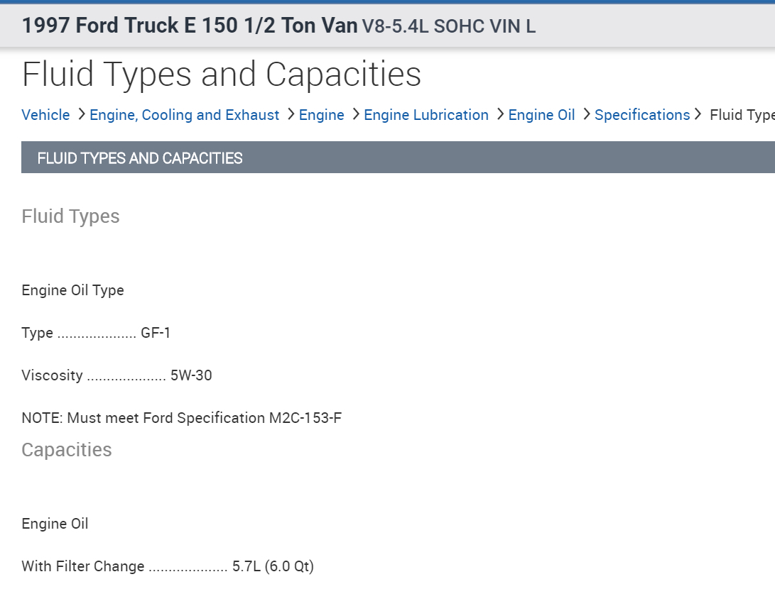

The oil fill cap is going to be on the right hand of the engine. It is located on the top, in the middle, of bank 2's valve cover. I have included all the other information that you have requested in the diagrams down below. Let us know if we can help you with any thing else.
