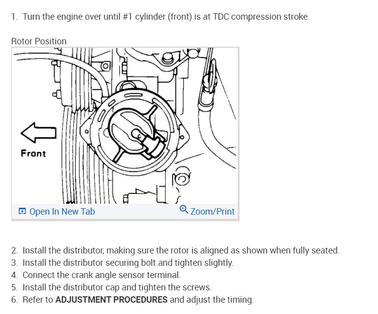

I need to know where the crankshaft sensor is located on my truck.

The crankshaft angle sensor is inside the ignition distributor. Here is an image of the location in the diagrams below. Check out the diagrams (below). Please let us know if you need anything else to get the problem fixed.
