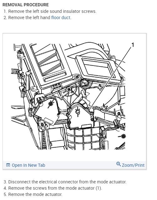

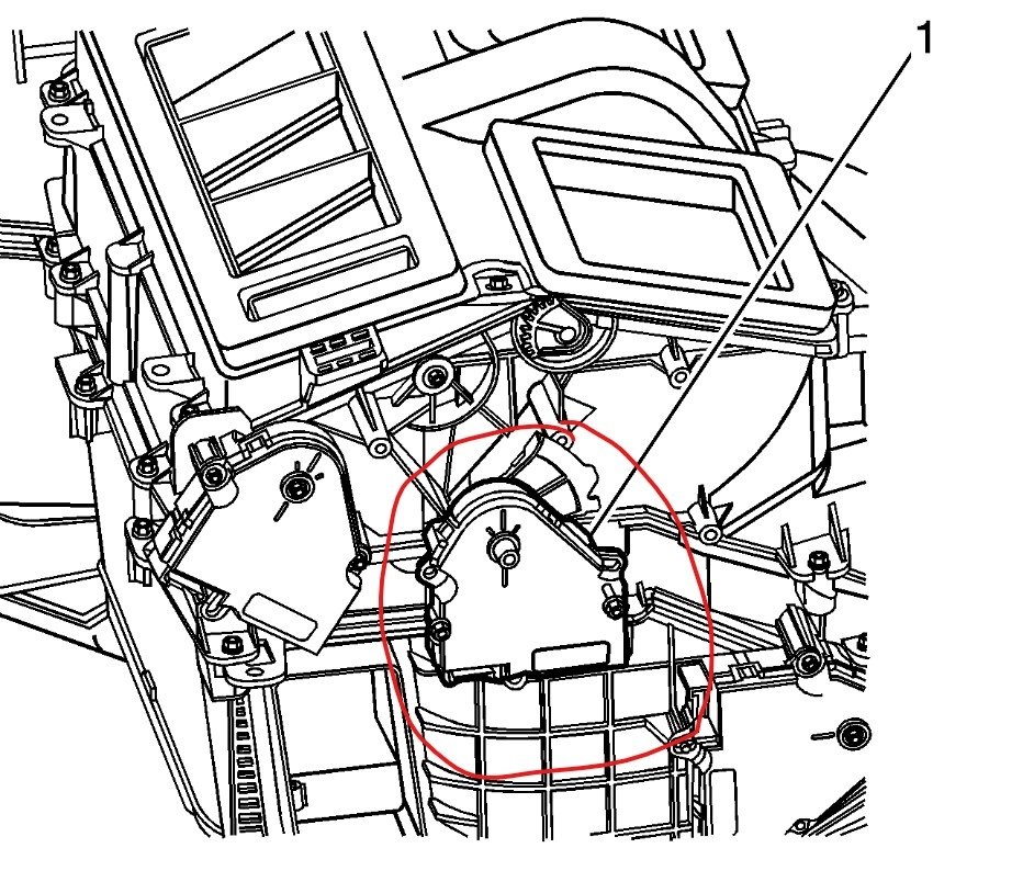

My air is stuck on defrost, blower works, heat and A/C. Just can't switch to main vents.
May 28, 2022 at 2:32 AM
STEVE W.
  • 15,389 POSTS
Okay, that would be the mode door actuator. It's actually not hard to replace on that truck. Setting in the driver's seat it is up in the dash above the gas pedal. To access it you need to remove the sound deadener panel above the footwell. Then you can look up and find the actuator mounted to the end of the HVAC case. Remove the electrical connector and the screws and remove it. Now to install the replacement reverse the process except it will come in Bi-Level mode. You need to adjust the doors to match that before you install the new part.
Now you need to calibrate the system. To do that without a scan tool you remove the HVAC fuse B for 20 seconds. Now plug it back in and start the engine. After about a minute you are done.

Can't "look up" and see the actuator, only a corner of it, and cannot be gotten to. Probably need to remove radio.
Aug 8, 2023 at 9:30 AM
STEVE W.
  • 15,389 POSTS
Depends on the actuator. The mode door is about the only one you can access easily. The rest require the removal of the instrument panel to access them.

Did all that still will not change from vent air will go to defrost but still blows out front vents?
Mar 16, 2026 at 3:22 AM
STEVE W.
  • 15,389 POSTS
OK either the new actuator isn't installed in the proper position to move the door fully, or the door inside the unit is damaged. Did you adjust the door to mid travel before installing the actuator? You put it in the middle and the actuator should do the rest. If you can move the mode door manually you can test if the door itself is OK, with the actuator off move the stem, can you select defrost, vent, floor? Do the vents turn off? If not the door linkage or door itself might be damaged and stuck in bi-level. Trying to move it manually will tell you.
