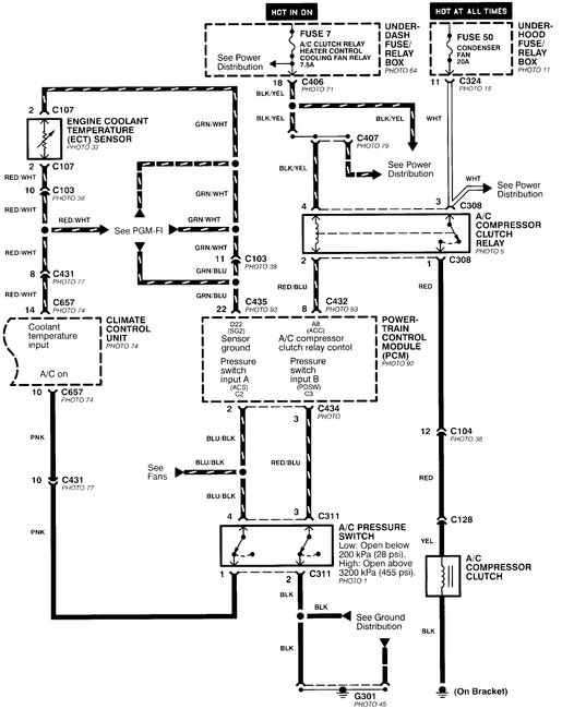

A/C blowing hot. The A/C was working this morning and this afternoon blows hot.
Jul 21, 2017 at 9:22 AM
STEVE W.
  • 15,399 POSTS

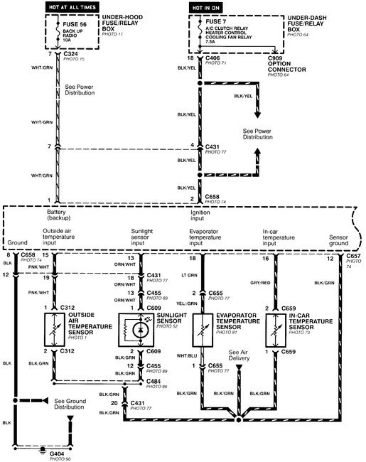

That car has a few items that will stop the AC from operating if they fail. The AC clutch relay is just one piece.
Check fuses 7 in the dash fuse/relay box and 50 in the under hood relay box. The AC relay is in the front of the engine compartment near the upper radiator hose.
