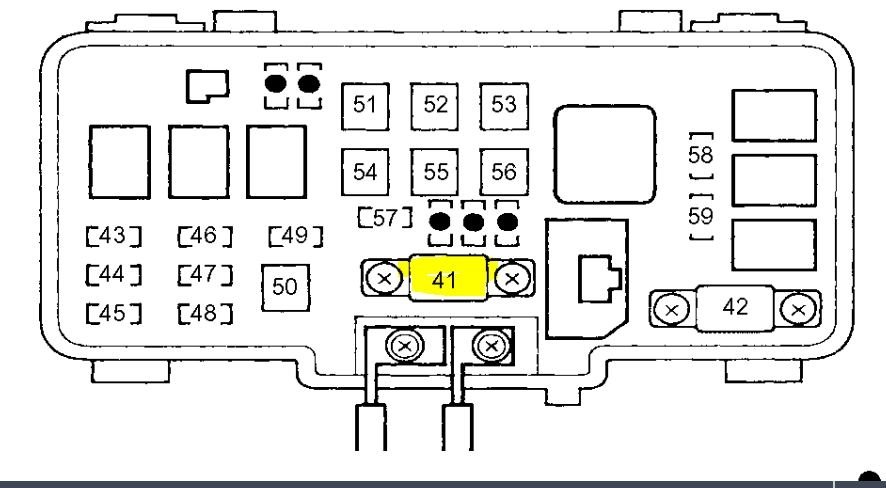

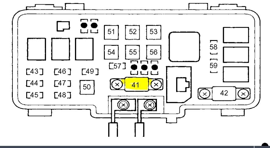

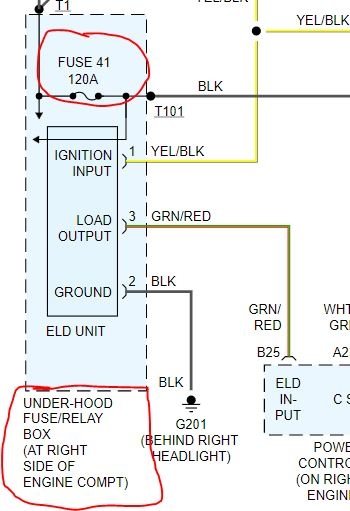

Where is fuse 41 located
200,000 MILES • V6 • 2WD • AUTOMATIC
JAGNINDER BOPARAI
Parked my vehicle, tried to start after 10 minutes, will not start. Tried to jump, still not working. Reading one article talked about fuse 41 being the main fuse. Would like to check it out and see if I can replace it and if it does the trick.
Oct 29, 2019 at 1:14 PM
  • 110,251 POSTS
Welcome to 2CarPros.
I attached two pics to help you locate the fuse. Let me know if it helps.
