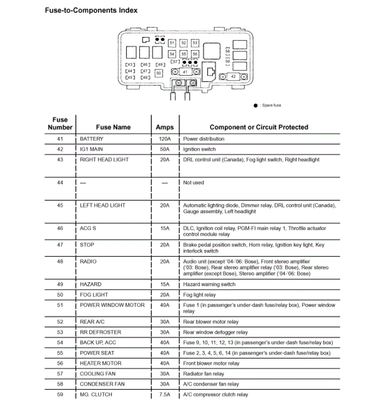

Where are the fuse panel I think one of the fuses is out
2005 ACURA MDX
170,000 MILES • 3.5L • 6 CYL • AUTOMATIC
LOAK
This morning I started my mdx and after 30 min I got it to reverse.After another 30 min I got it to move forward . I think one of the fuses is out can you help me find and check them please?
Feb 14, 2014 at 7:40 PM
  • 110,194 POSTS
If you look at the attachments below, they provide the fuse box orientations and what each fuse is for.
In addition to just checking a fuse, make sure there is power to it. A fuse may be good and not be receiving power.
Here is a link that you may find helpful when testing:
I hope this helps. Let me know if you have additional questions.
