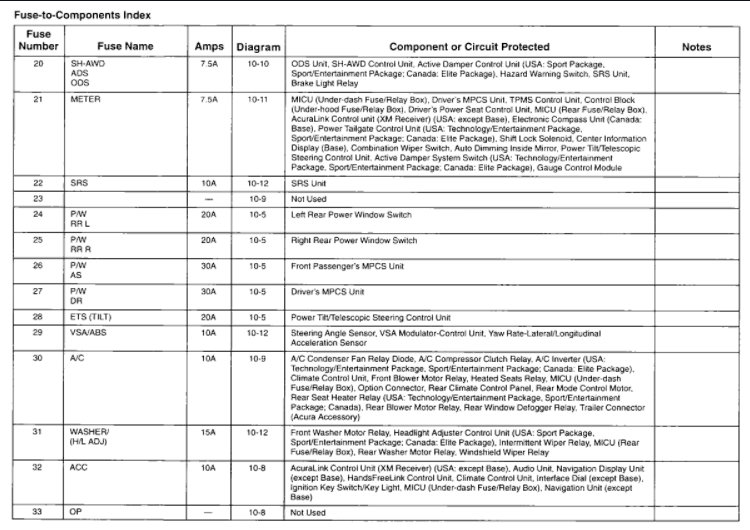

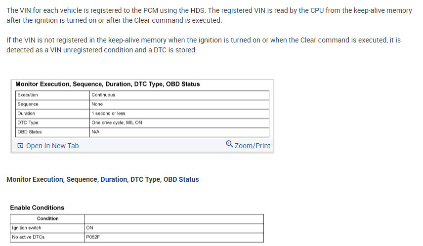

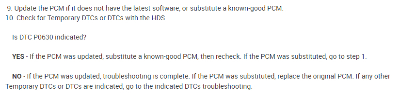

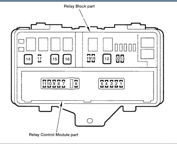

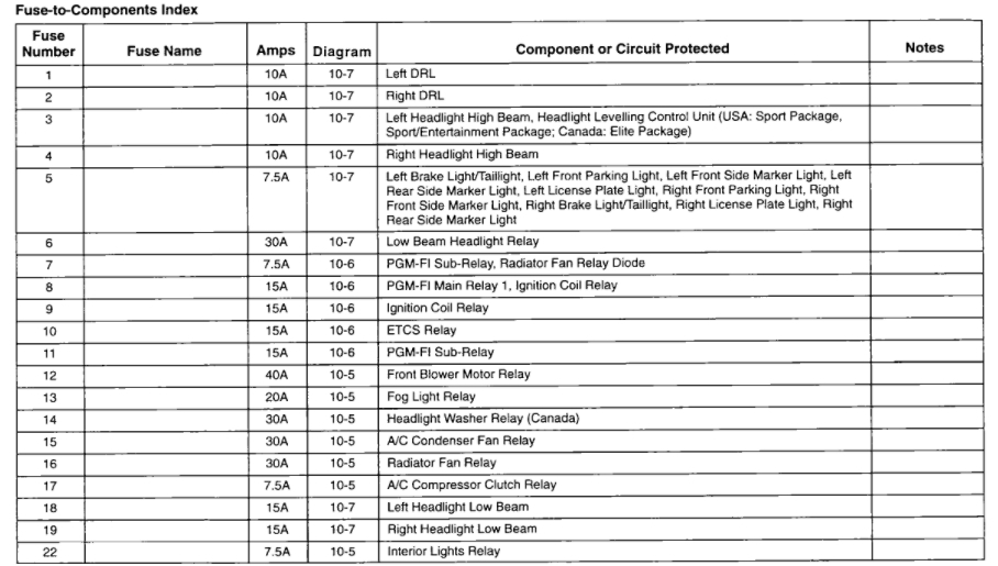

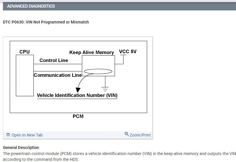

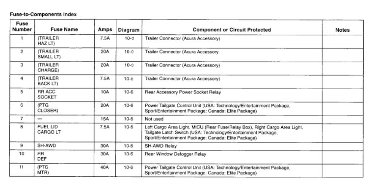

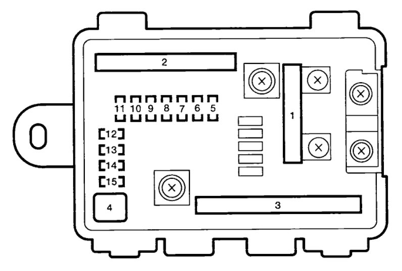

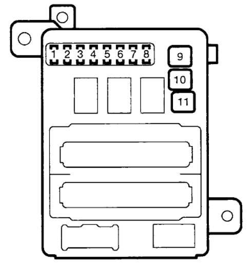

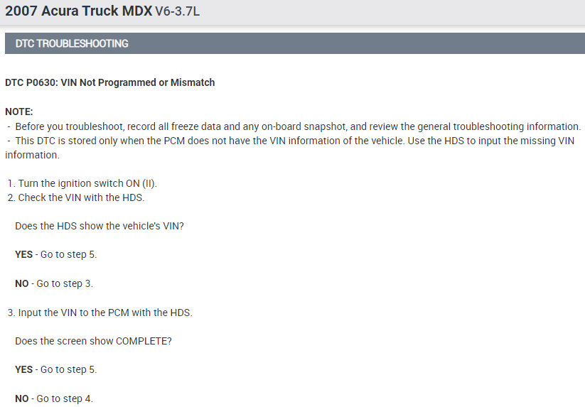

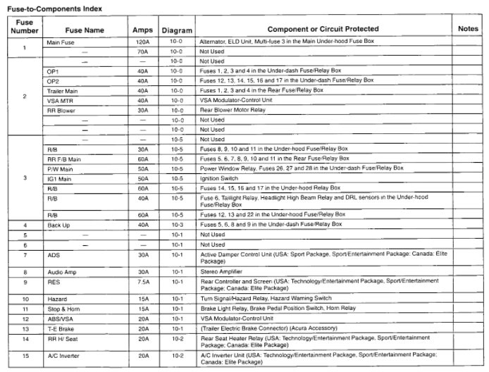

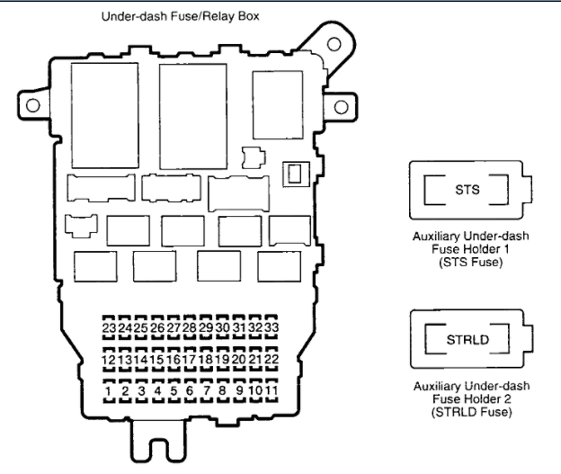

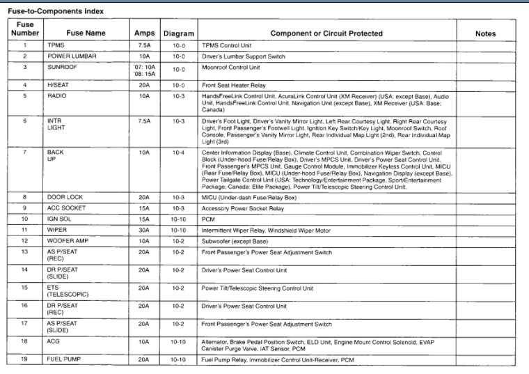

code P0630 vin number not programmed or mismatch keeps coming up...recently bought the car used...where are the fuses and how do I check them out?

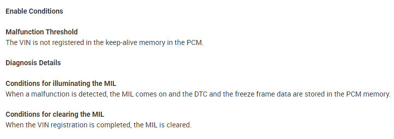

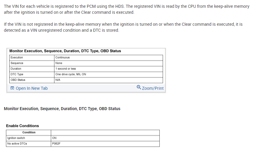

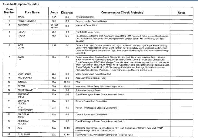

Here is the information you requested. Here are a few tutorials for you to view on how to check and replace fuses:

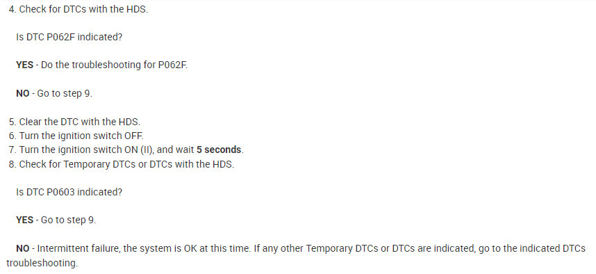

I've attached pictures below showing the fuse and relay locations on your vehicle and also diagnostic steps for your code P0630. Hope this helps and thanks for using 2CarPros.
