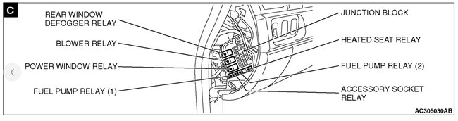

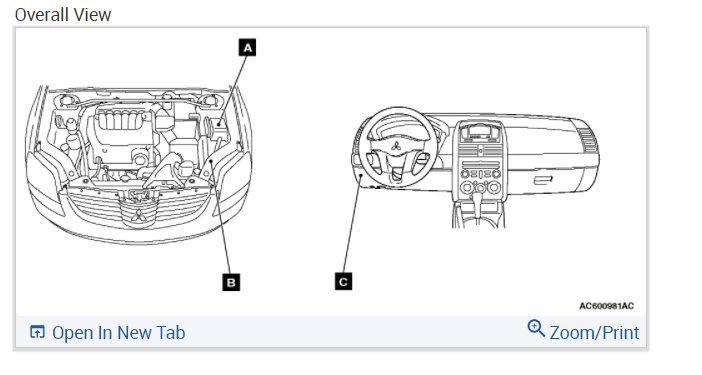

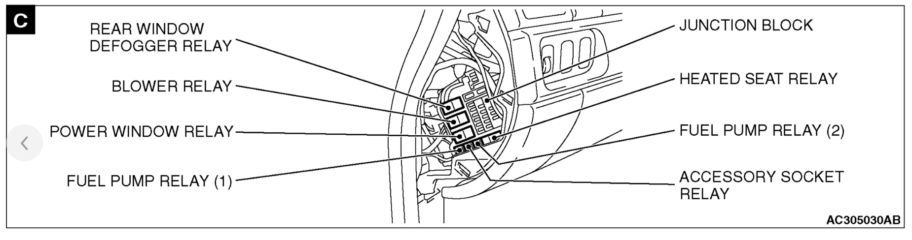

Are there any mods on your vehicle? (often these codes are caused by overboost on turbocharged engines and/or drop in air filters) Here is a guide to help check the fuel pump relay with the location in the diagrams below.
Check out the diagrams (Below). Please run this test and get back to us.

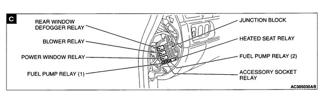

Here is an image that should clarify it for you guys. Hope it helps. Let us know what you find.

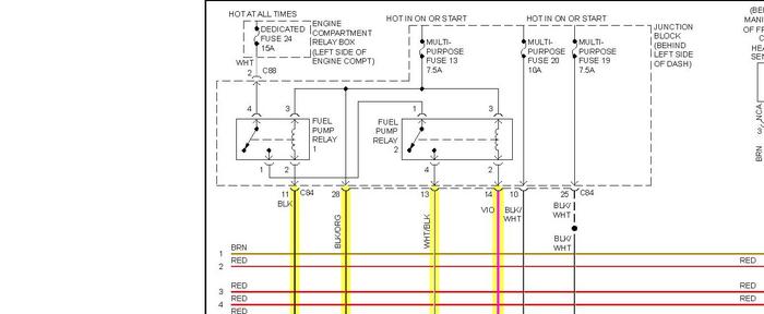

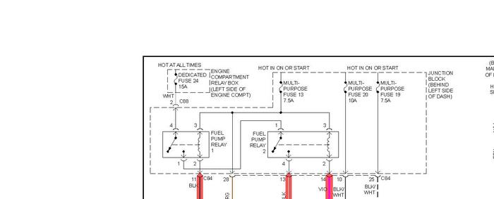

The fuse #24 in the relay box, located left side of engine compartment is what feeds those two fuel pump relays. so you should start there making sure you have twelve volts on both sides of that fuse all the time.

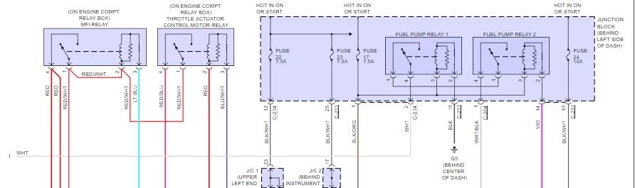

I have a 2003 Mitsubishi Galant that will not start. It has spark so I looked for fuel problems. There is no power going to the pump. I replaced the relay and still no power at the pump. I used a jumper wire instead of the relay and the pump turns on but the car sill will not start. Why wouldn't power be going tot he fuel pump relay to activate it?
Sep 11, 2020 at 6:10 AM (Merged)
  • 75,992 POSTS
See diagram below
EBERTJOEL
This diagram didn't help me. When the key is in the on position there is 12 volts at fuse 13, but the relay doesn't turn on. I tested the relay to be good.
  • 75,992 POSTS
Check and test the violet wire on the relay to the computer controlled circuit could be open

Most likely, no, you wouldn't have spark with a malfunctioning crank sensor. Fuse 13 is the source of switching power for the fuel pump relay. If that fuse is good, make sure there is power from it to the relay with the ignition on. The other side of that should be a path to ground. Make sure the other side of the switching side of the relay has a good ground.

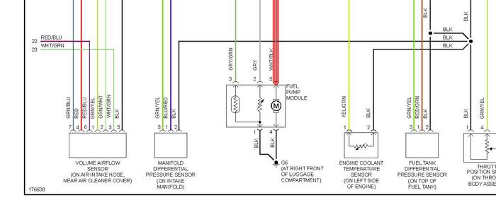

hey guys,i got the fuel pump out of tank,and it works when i straight wire it.now i need to know where is there fuel pump relay on this car 2003 mitsubishi galant.also just cause it work by straight wire does this means it should work while in the fuel tank.. thanks in advance
CARADIODOC
  • 34,368 POSTS
It should only run for one second after turning on the ignition switch. It will turn on again during engine rotation, (cranking or running).

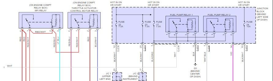

Its the fuel pump relay no.2 that powers the fuel pump when the computer grounds the coil side of the fuel pump relay no2 thru fuel pump relay no.1

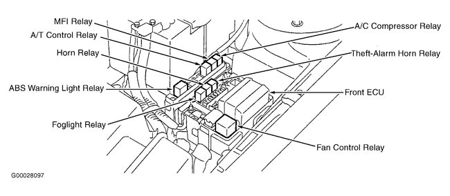

Sorry for the confusion. Mitsubishi calls it the "multi-point fuel injection", (MFI) relay. The fastest way to test this circuit is to use a test light, and back-probe the red wire at any fuel injector, either of the two sensors, or at the mass air flow sensor. Digital voltmeters can work, but they respond too slowly to see the initial twelve volt pulse.
You should see the test light turn on for that first one second when you turn on the ignition switch. What is important is does it turn on again steady while you are cranking the engine.
The rest of the circuit is a little different than what I am used to seeing, so I am going to have to back up and study it. The ignition coils have their twelve volts switched on with the ignition switch, not any relay, so we cannot use them for any test procedure. There are two fuel pump relays. Fuel pump relay number one turns on any time the ignition switch is on. Fuel pump relay number two is the one that is turned on by the Engine Computer. They are in series, so both must turn on to have twelve volts to the pump. That will be on the white/black wire at the pump.
