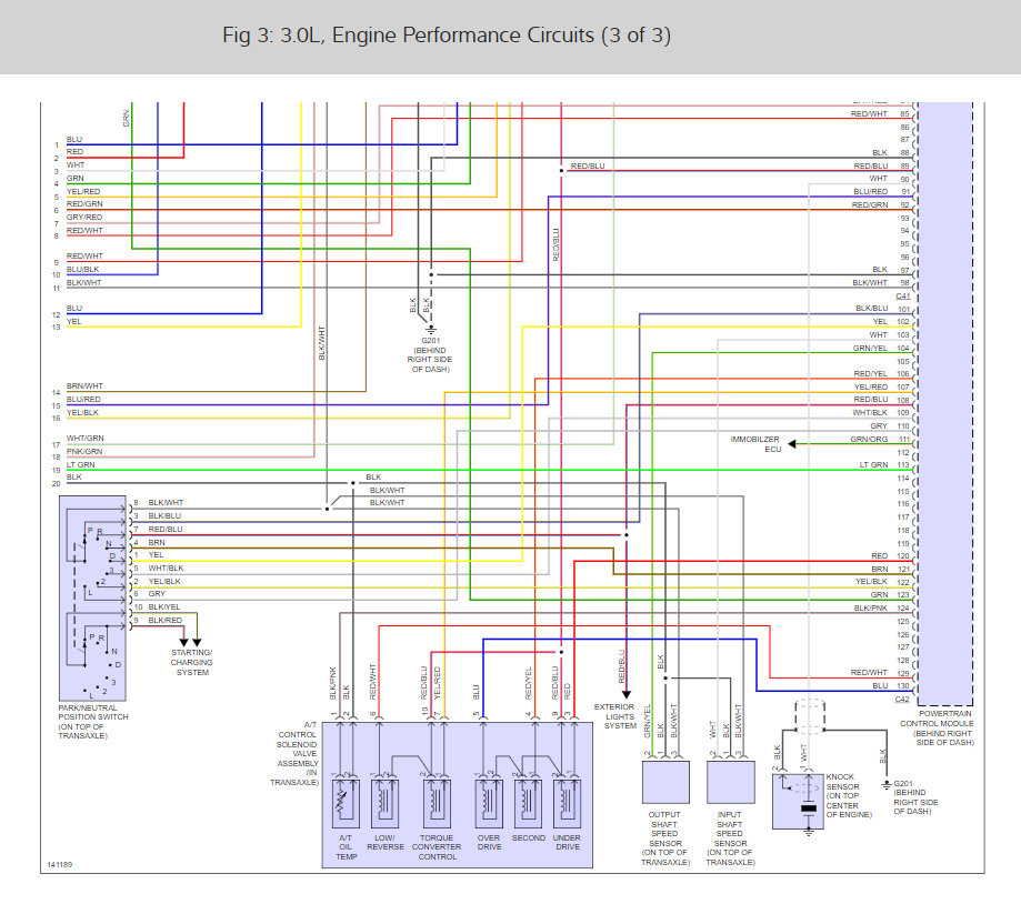

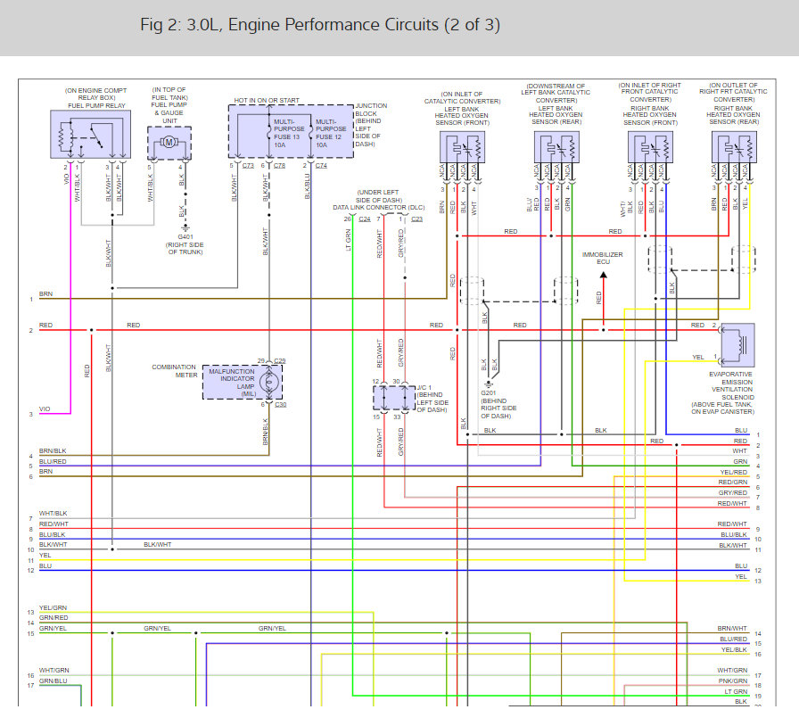

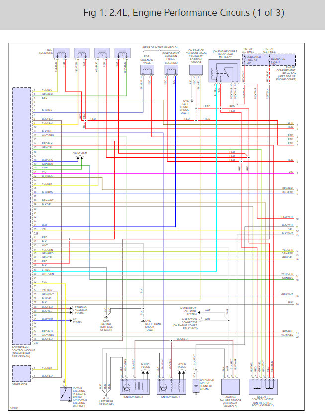

I got a 2001 Mitsubishi galant that I can't get to start. I got in the car to start it and it started for about 2 sec and then died and won't start back. the fuel pump is not kicking on so I took it out and hook it up directly and it worked so I changed filter and put back in and again it would not work. So I changed the fuel pump relay and still wouldn't work. So I took the old pump back out and hooked up a new fuel pump, and again it did not work. I checked to see if there was power to the relay and I got nothing with the key off and the key on. So my question is, what would cause there to be no power to both the fuel pump and the relay... and it does have the anti theft system equipped...
Feb 22, 2015 at 4:10 PM
WRENCHTECH
  • 20,761 POSTS

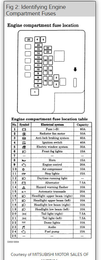

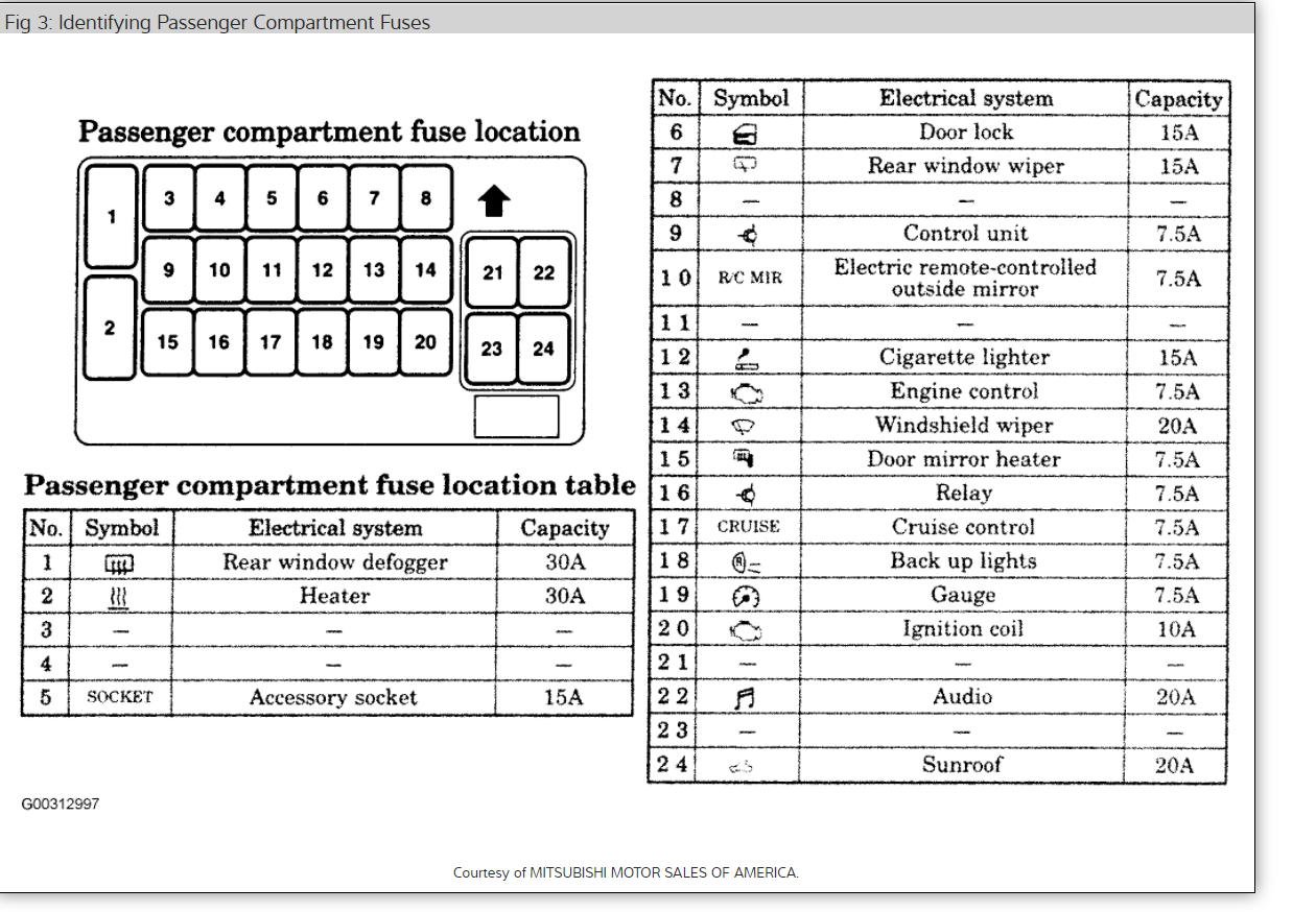

There is a fuse #13 that needs to be checked which powers the relay here is a guide to help us get started and the fuel pump and engine wiring diagrams so you can see how the system works.

Ok test light comes on at fuel pump and fuel pump relay with key on. But still fuel pump is not kicking on.

Power at the fuel pump? Are you sure about that?
It's only supposed to power for the first 2 seconds when the key is first turned on.

No am not really for sure cause I didn't know where to really touch the test light at thE fuel pum. So I touch it in the wire harness and the fuel pump and the test light come on in like 2 or 4 wires back there with the key on. But not for sure if that was right

If you're having trouble working a test light, then we don't have much chance of solving this. It looks like both the power wire and the ground wire are black. https://www.2carpros.com/images/external/87613534.gif

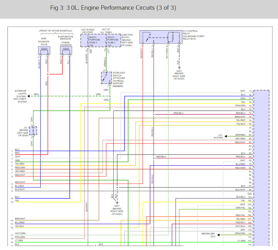

i am having a fuel issue. we replaced the fuel pump after not getting any fuel to the engine and it did not solve the issue. We noticed that the fuel pump relay was not clicking and tried a different relay with no solution. i have tested for power at the pump and got noting, after finding that an incorrect fuse was in the PCM slot, we were able to hear the fuel pump engage one time. but the car would not start. took the fuel line loose from the injector rail and noticed a little fuel but was not sure if it was from the last time it ran. There is no blockage between the pump and the rail. car has spark and runs on ether and i highly doubt all injectors are bad. i am pretty good with a DMM but i just do not have the time at the moment to spend so long on an electrical issue but at this point i am leading my search to the PCM/ECM. Help me. i am going in circles trying to get this started. I already messed up a connector for a fuel injector getting the rail off so i am just baffled at such an issue. any advice or testing i will do.

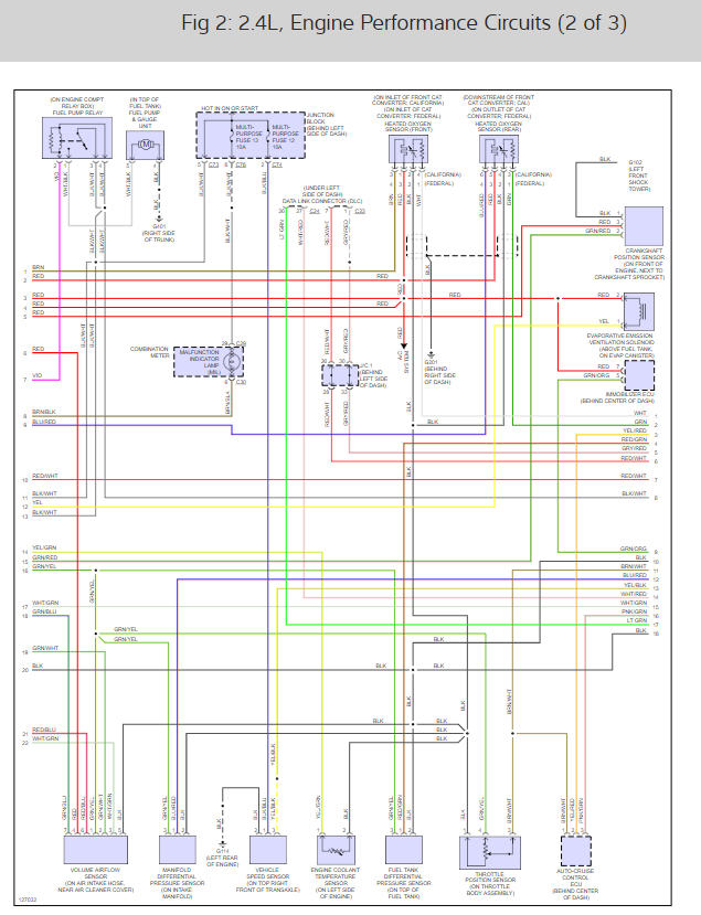

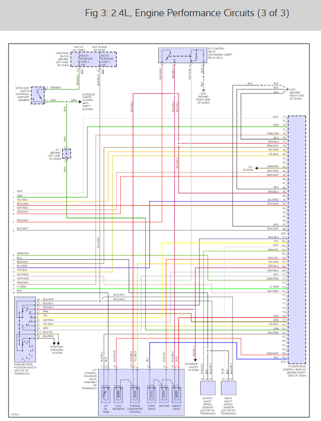

It sounds like the A/T relay might not be working right. Here is the fuel engine wiring diagram so you can see how the system works. The PCM turns the relay on so it must see the engine cranking over or it wont turn the relay on. When you turn the key to the on position without cranking it do you hear the pump prime?
Here is a guide to help you test the wiring:
Here are the engine wiring diagrams.

I have only heard the pump prime once. but after I disconnected the fuel line from the rail it did not try to re-prime. I am not at the car for a while so this post might go cold for a few days but I am still open to all suggestions. I will try them all until this works.

Let me know after you check the relay, you can try swapping it as well.

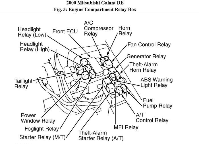

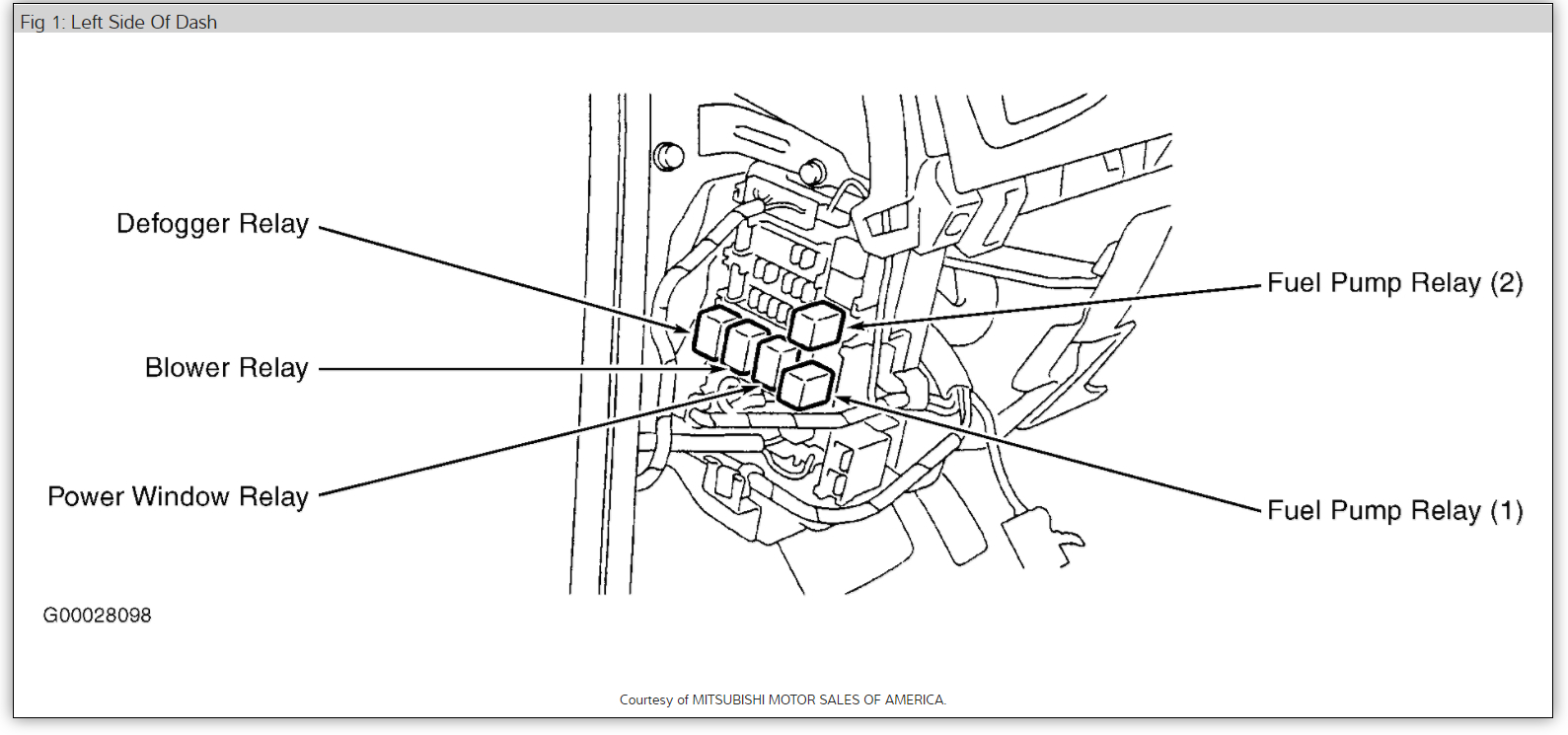

I have a 2000 Mitsubishi galant 6cyl im trying to replace a fuel pump relay and im trying to identify which it is because i see more than one of those
We know where the fuse box is for the fuel pump relay just trying to find which one is it because the plugins look alike

Refer to diagram.

where would I find the fuel pump realy on a 94 Galant
Sep 11, 2020 at 6:12 AM (Merged)
KHLOW2008
  • 41,814 POSTS
Hi icedragon727,
Should be under the radio behind the centre console.

CARADIODOC
  • 34,383 POSTS
A failed fuel pump is much more likely.
There is no separate fuel pump relay. It is part of the Electronic Control Module, (ECM) relay. That relay has eight terminals on it.

CARADIODOC
  • 34,383 POSTS
You misinterpreted my reply. I did the same thing too when I reread it. The fuel pump relay is not in the Engine Computer, (ECM). There is an ECM relay that sends 12 volts to the Engine Computer. There is a second, totally separate relay built into that assembly, and that one is for the fuel pump. It would make sense to call it the "ECM / Fuel Pump" relay, but they don't. It's just called the "ECM" relay.
