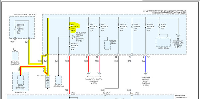

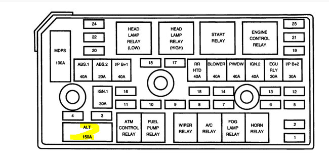

Where is 150A mega fuse bolt down located?
2006 HYUNDAI SONATA
1,705,403 MILES
LALA2006
Battery was placed in wrong and burned fuse out. Now Battery and Alternator can't make proper connection.
Feb 9, 2023 at 2:01 AM
  • 110,240 POSTS

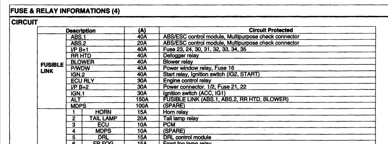

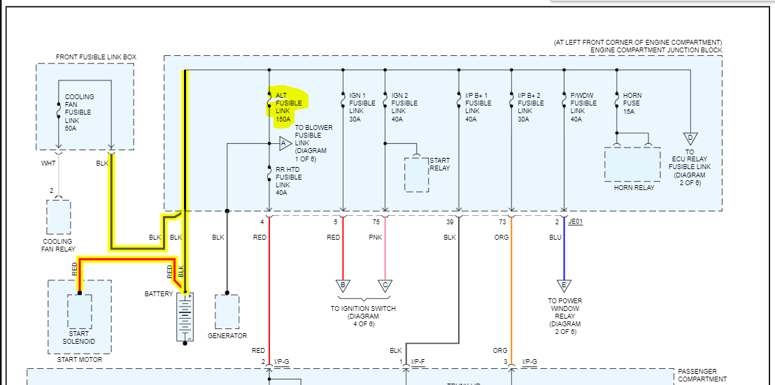

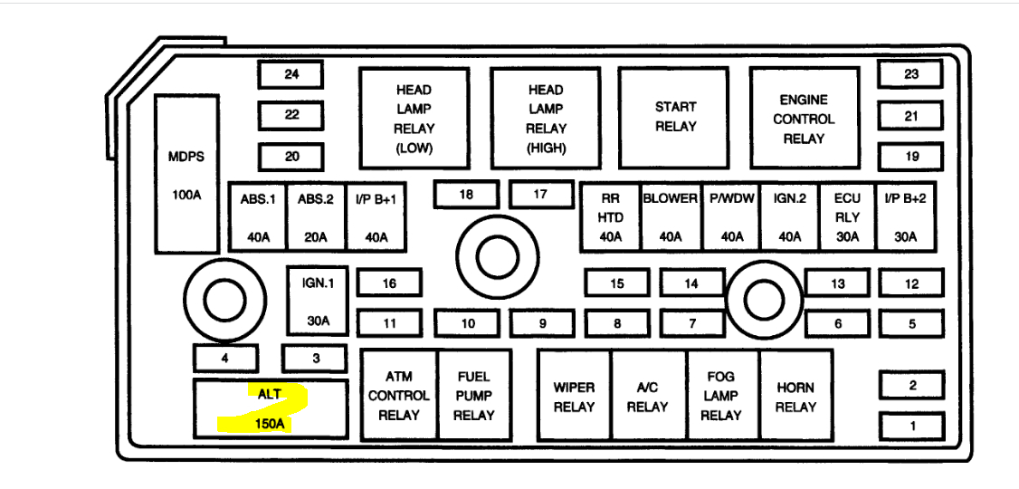

I went through the power distribution schematics and there is only one 150-amp fusible link. It is for the alternator and the ABS system and is located in the engine compartment junction box. See pics below.
Let me know if that is what you are looking for.
