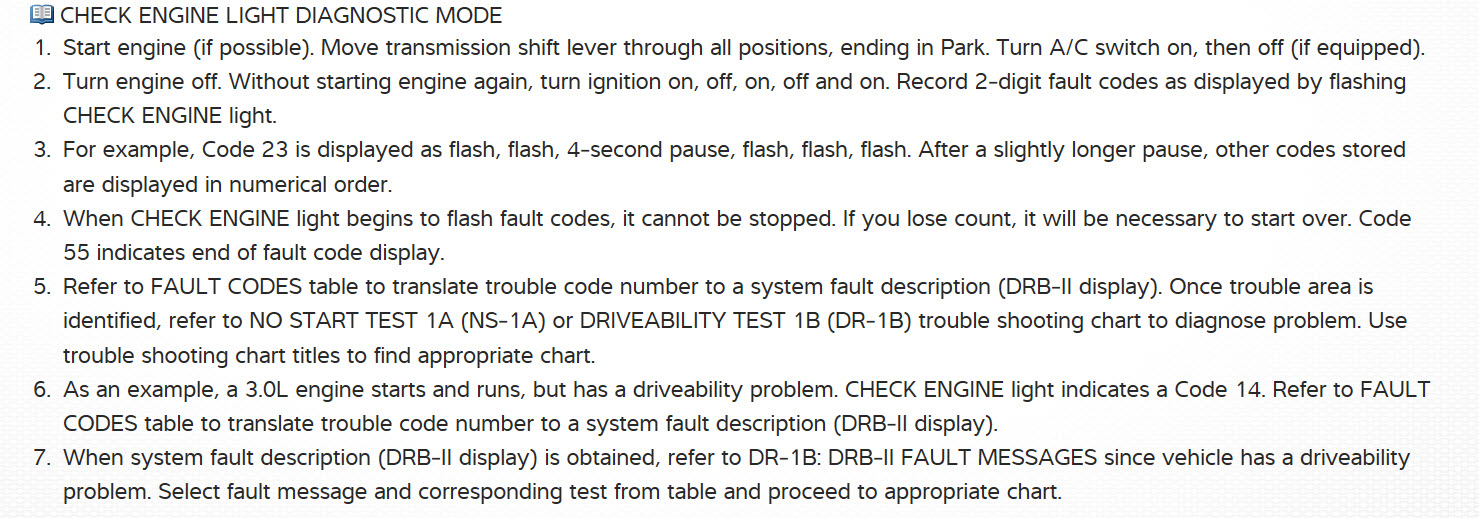

When accelerating it bogs down and tries to shift almost as if passing gear was not kicking in
1991 CHRYSLER LE BARON
140,000 MILES • 2.5L • 6 CYL • FWD • AUTOMATIC
CHAYCE
When you first start driving it is alright, but once you get to like twenty five mph and try to speed up you have to ease on to it because if you give it too much gas it bogs out kind of and just accelerates super slow.

scan for codes and check fuel pressure with a gauge auto parts rent it. See link.
Feb 27, 2017 at 11:55 PM
HMAC300
  • 48,601 POSTS
I forgot to send how to scan for codes see picture. then get back to us with codes if any.
