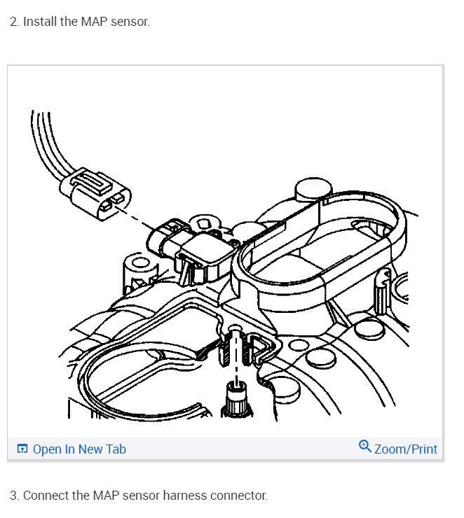

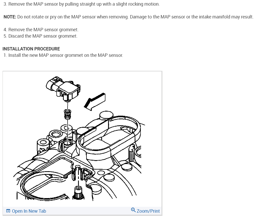

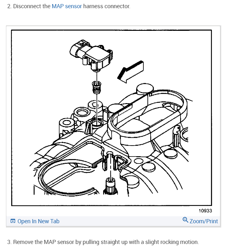

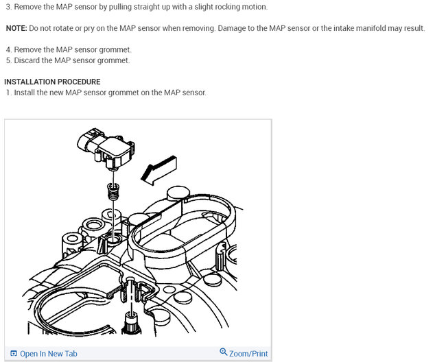

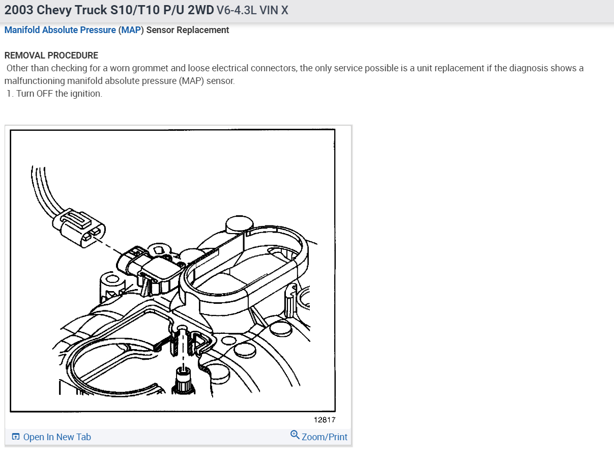

I have seen a bad MAP sensor cause this issue and not give a code, here is the location of the sensor so you can check it out. Cleaning this sensor will not help, it must be replaced. Check out the images (below). Please let us know what happens.
