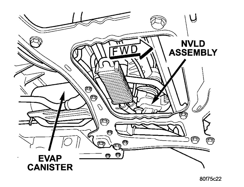

When refueling the gas pump stops repeatedly and gas keeps coming up to the nozzle forcing it to stop pumping. I know there is usually a metal flap there, but I don’t see one. maybe it broke off and clogged the line. not sure.

I attached a TSB on this for the canister having a blockage in it not allowing air to release when fueling.
https://www.2carpros.com/articles/how-emission-control-systems-work

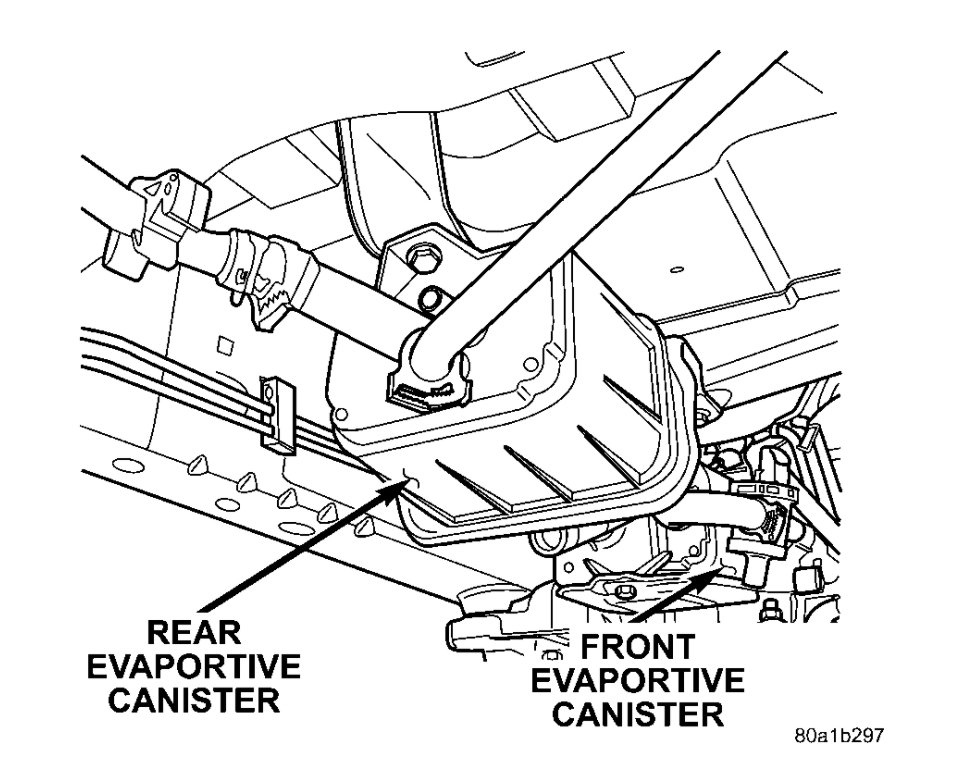

It most likely is the front canister.

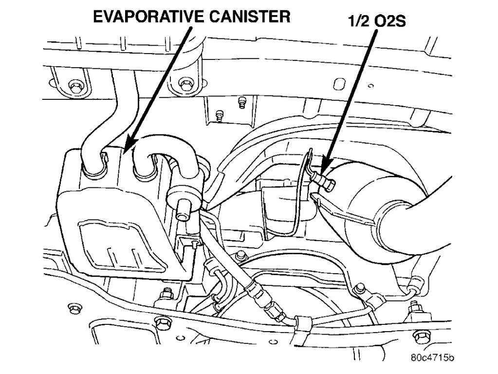

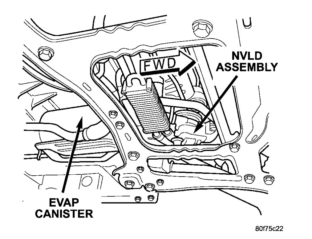

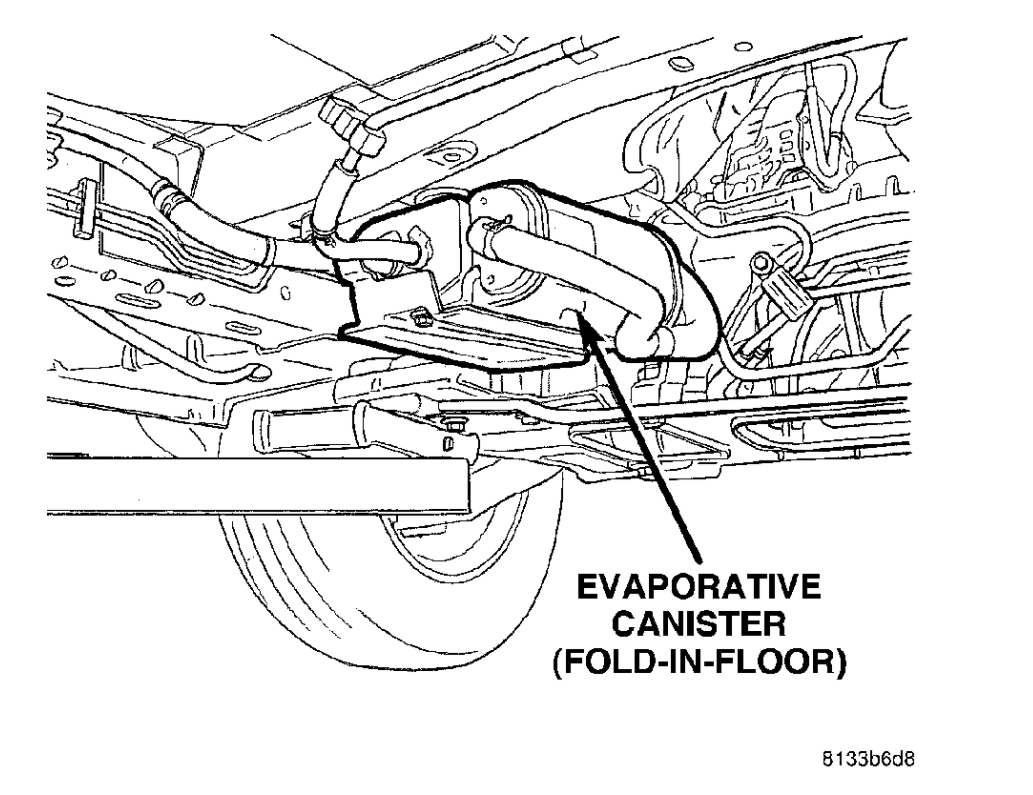

There are 2 EVAP canisters on the vehicle. The vacuum and vapor tubes connect to the top of the canister. It is a charcoal canister.
All vehicles use a maintenance free, evaporative (EVAP) canister. Fuel tank vapors vent into the canister. The canister temporarily holds the fuel vapors until intake manifold vacuum draws them into the combustion chamber. The Powertrain Control Module (PCM) purges the canister through the proportional purge solenoid. The PCM purges the canister at predetermined intervals and engine conditions.
