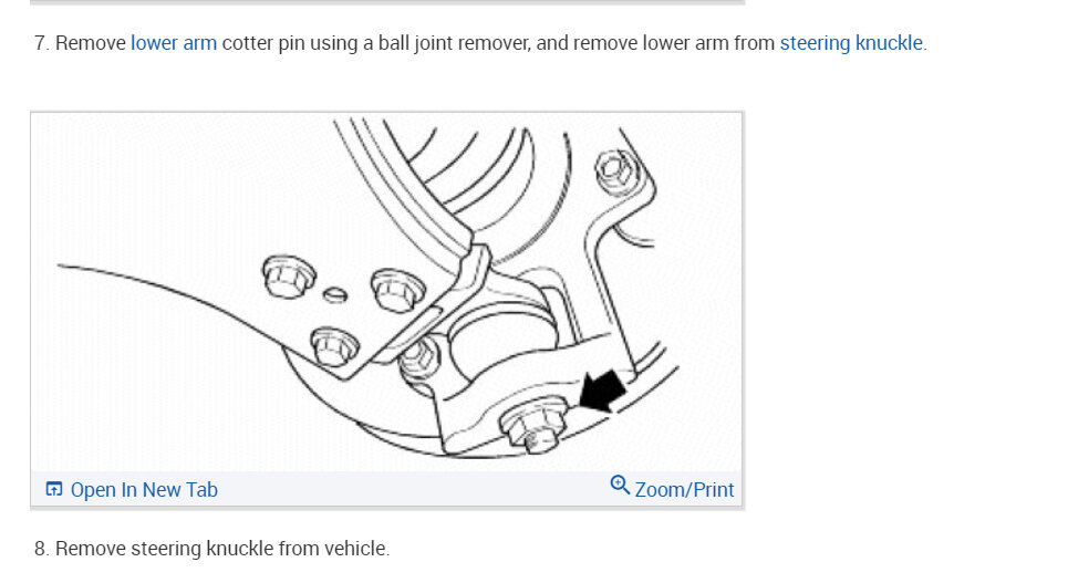

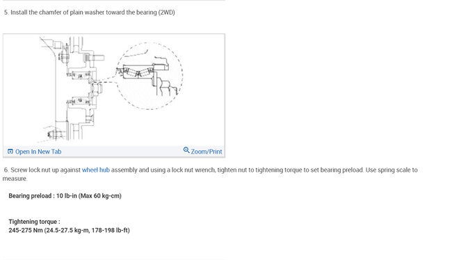

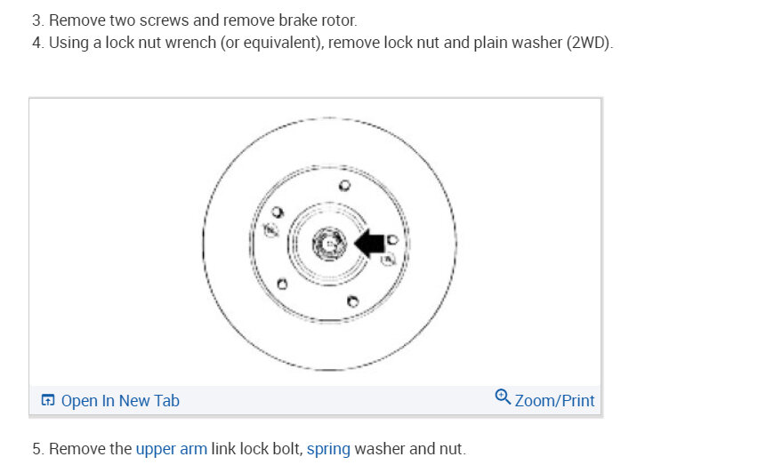

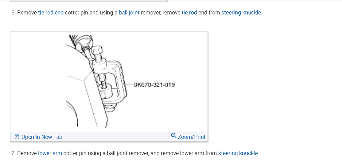

What other makes/models have hubs that will interchange with the vehicle listed above. It's the front driver side if that matters.
Jan 13, 2023 at 4:16 AM
  • 55,743 POSTS

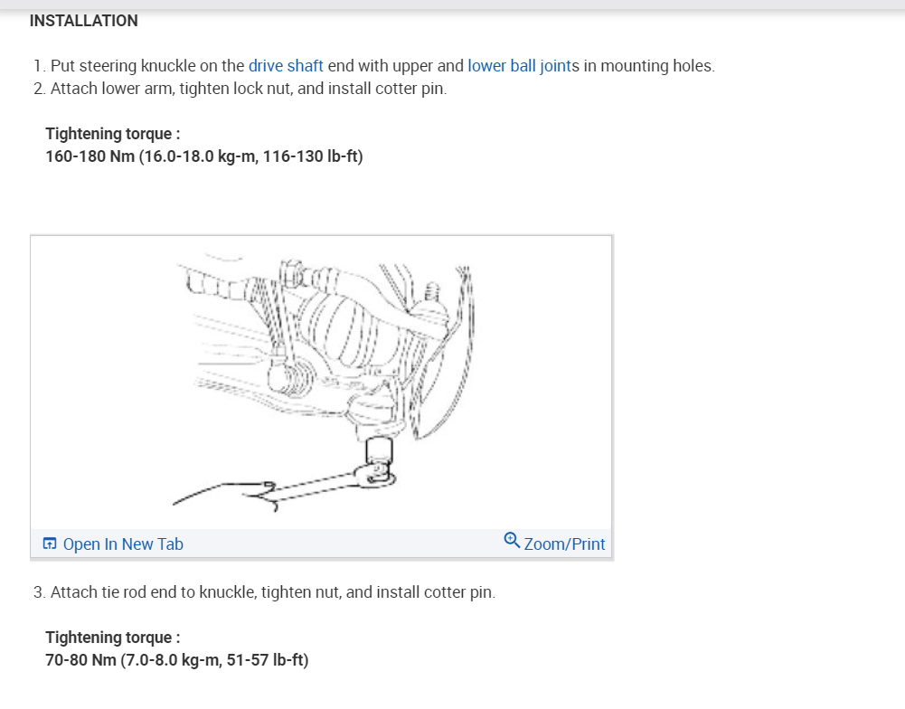

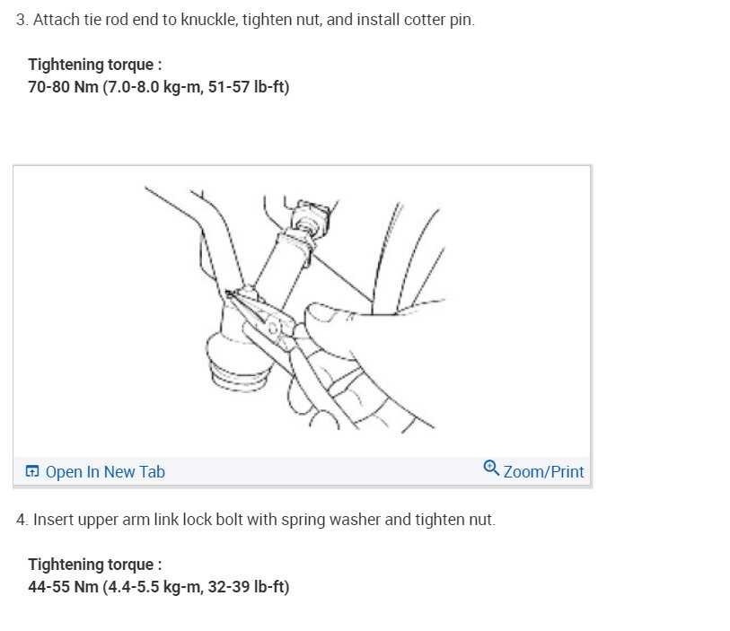

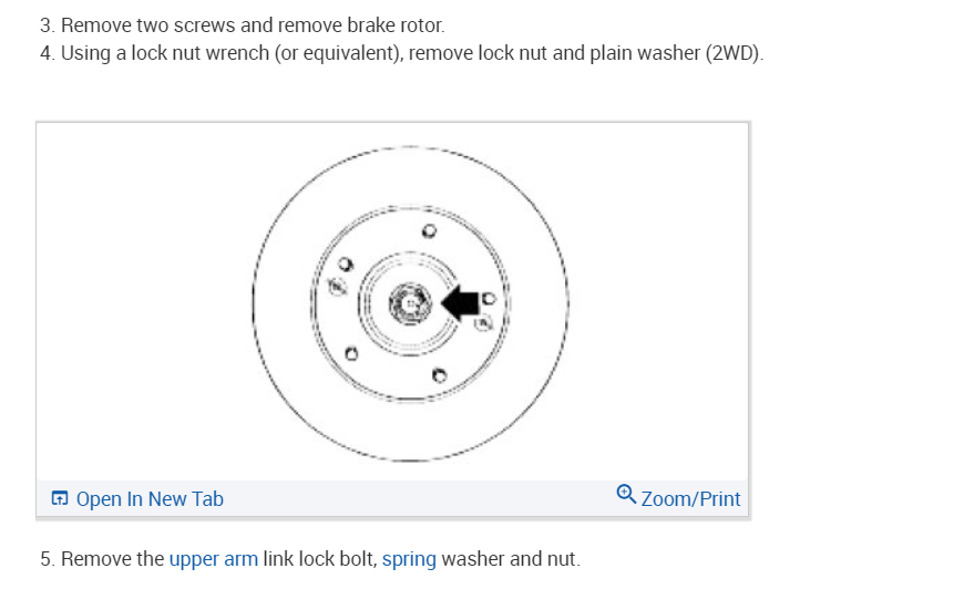

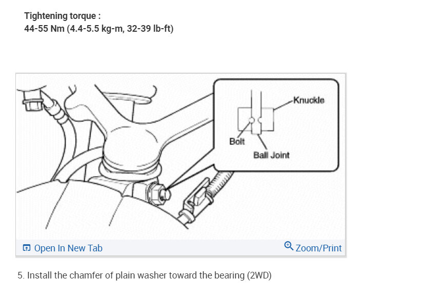

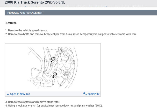

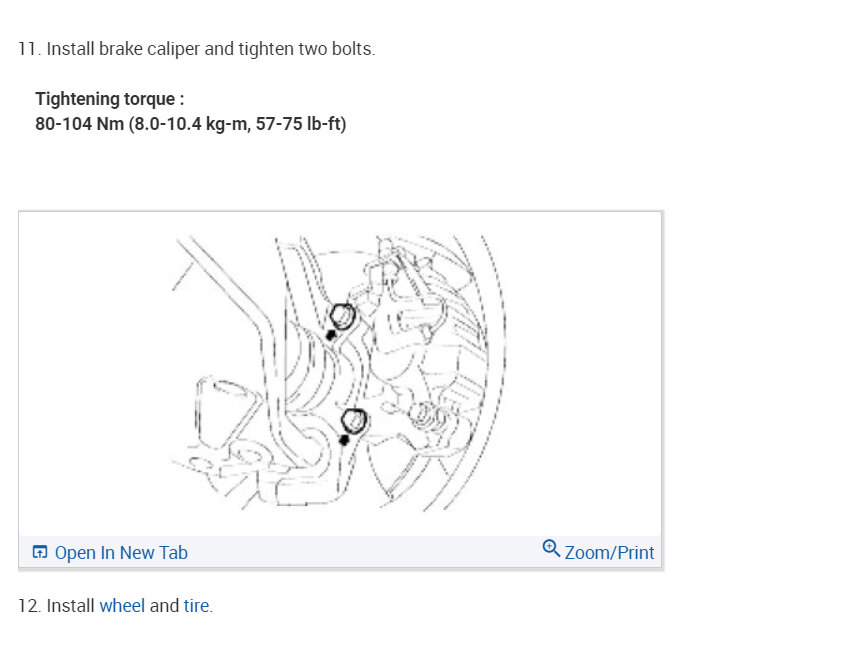

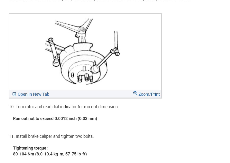

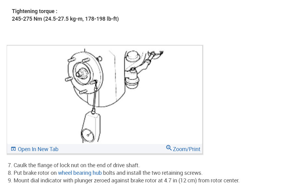

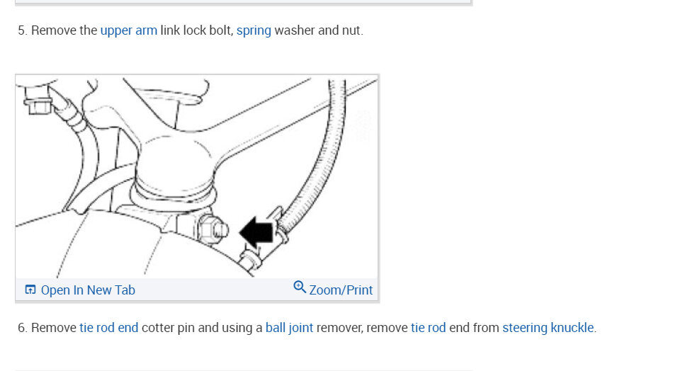

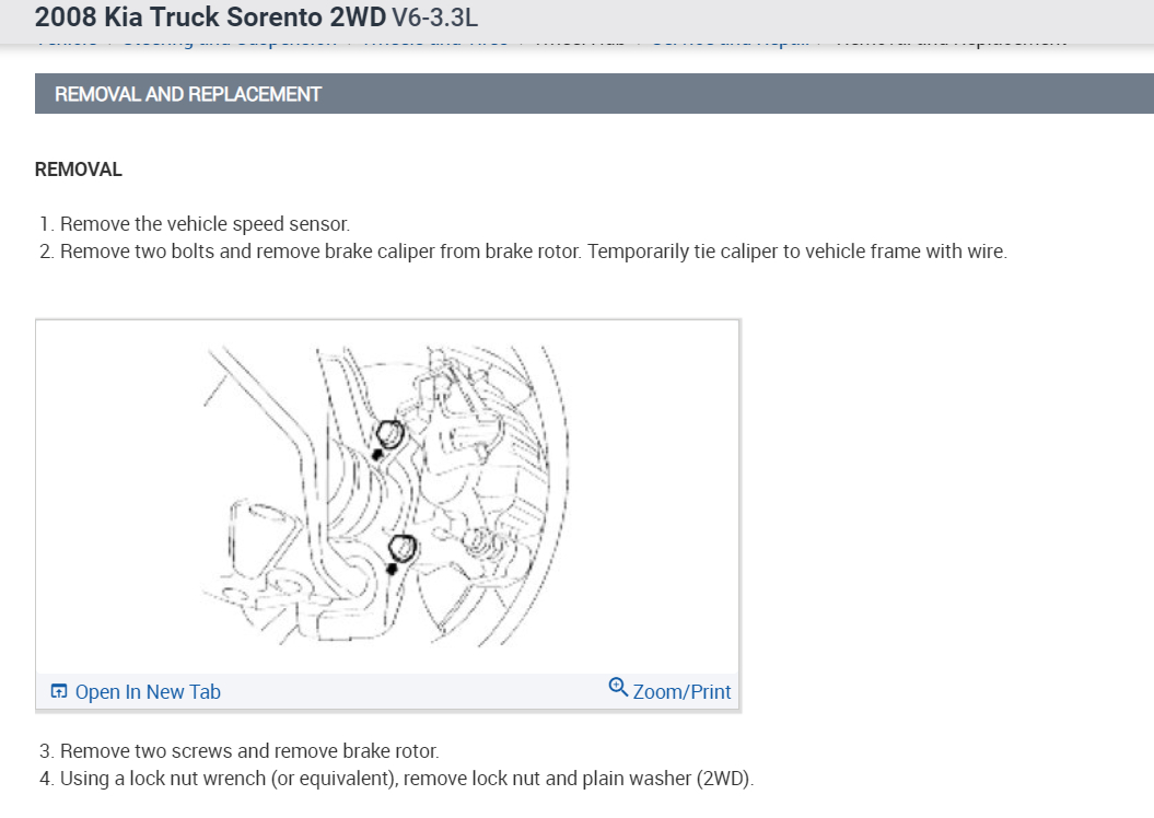

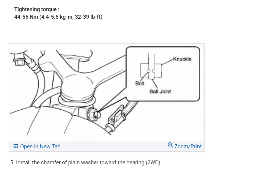

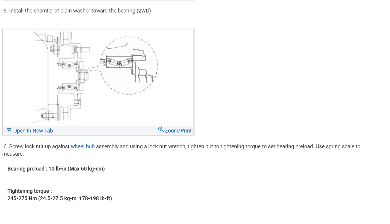

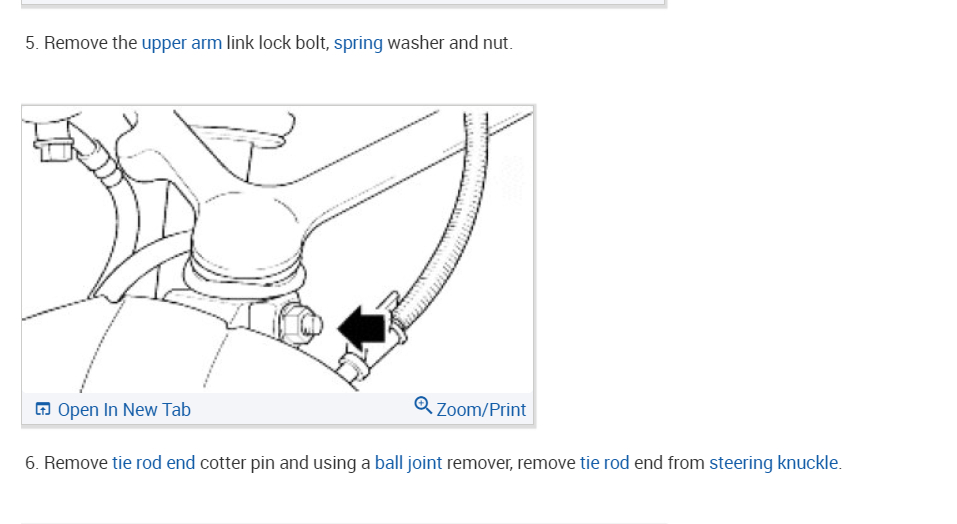

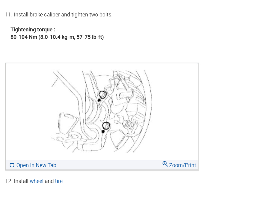

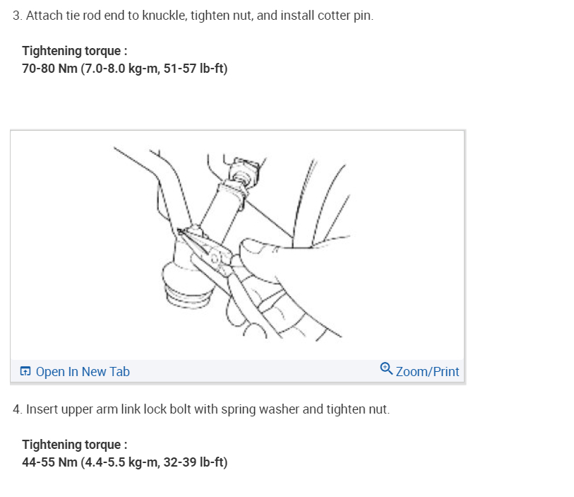

Most of the Kia's have the same hub if you check the part numbers and they are the same you are good to go, here is how to change the hub out in the images below and I have included the part number for you as well.
1 - Front Hub 503003E201 $328.89
