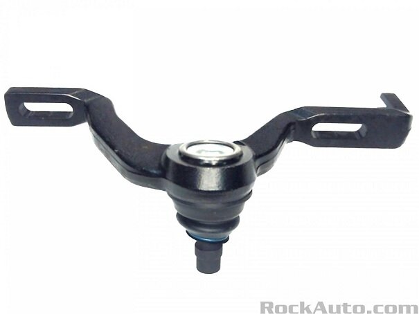

Ford actually had a nice idea in the late '90s on some of their truck models. That was to use a two-piece upper control arm on the right side. Each upper control arm is a triangle with the upper ball joint at one of its points. The other two are those pivot bolts. By sliding both adjustments in or out, you move the upper ball joint away from or closer to the center of the truck. That's the "camber" adjustment and has the biggest affect on tire wear patterns. If you move one corner of the control arm in and the other one out, you move the ball joint forward or rearward. That's the "caster" adjustment.

Ford had a nice idea to address that difficulty in making the adjustments match. The left wheel was set to put camber in specs, and to get caster as close to perfect as possible, then it could be left alone. On the right side, all that was needed was to set camber again, which is easy to do when you don't have to worry where caster ends up. Once camber was set by using those two pivot bolts, caster had a secondary adjustment provision in the two-piece upper control arm. The outer half was bolted to the inner half. When those bolts were loosened, the outer half could be slid forward or rearward to adjust caster without affecting camber. That was an excellent idea, but it has a major drawback. That is Ford intended that design to make it faster to adjust the alignment on the assembly line. The upper ball joint is cast as part of that control arm, and when it needs to be replaced, you can't buy that design. All that is available is the standard one-piece design. At that point you're back to the same frustrations this design has always had.

I'm happy and excited to tell you I made a mistake. I checked Rock Auto to verify nothing has changed, but for the first time I found that outer half of the right upper control arm is available through some aftermarket suppliers. Moog, in particular, is well-known for going through a real lot of research and development to produce steering and suspension parts that address common failures with the original manufacturer's parts. They also supply them to many other companies that re-box them under their own names.
