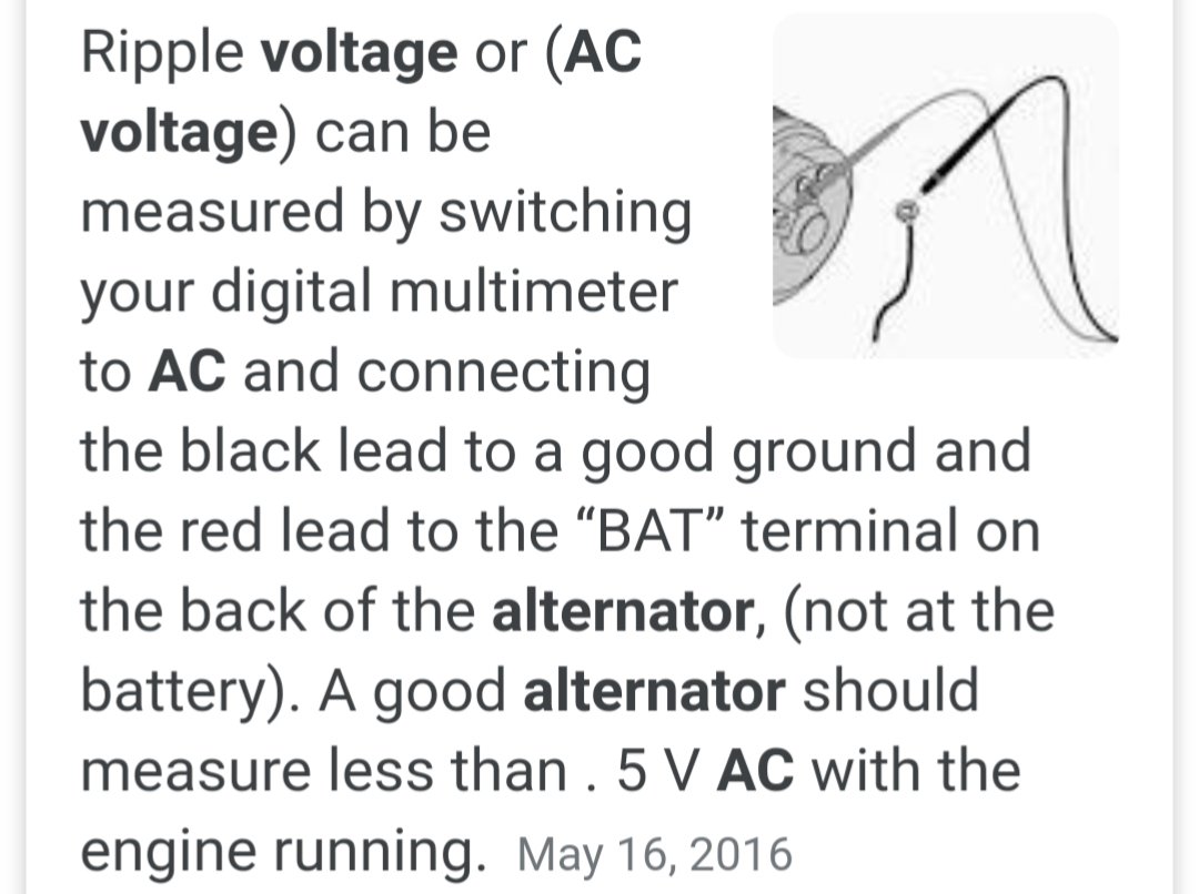

Hello, just to add a thought. I've seen a bad speed sensor cause the speedometer issue, and also check the alternator for any ac voltage coming out, bad diodes in the alternator will cause ac voltage to ripple through the system and the vehicle's ECM will go wacky. Here's the test for ac voltage. Just to verify the alternator isn't at fault.
Aug 18, 2020 at 12:42 AM
MAT2020
  • 12 POSTS
I thought about the speed sensor as well, and some people even told me about the transmission solenoid. As for the alternator it's a brand new one that I put in a year ago.
Thanks for the tip. :-)
Aug 18, 2020 at 1:44 AM

I got another comment from Al 514 about having my alternator checked because it may be at fault as well. The diodes in it may cause some kind of a power surge that makes my speedometer go bezerk. So I looked into the matter, made more researches on internet and tested something on my vehicle. When I get the engine started there's a funny whining kind of noise that I hear in the engine. So I disconnected a simple wire on the alternator and the noise stopped. So I'll start by removing the alternator and have it checked by a mechanic that is better equipped than I am to do that test. Is it normal that I can have a failing alternator even if it's a year old? I replaced it in January of 2019!! Now here's a question: is it safe for me to try driving my van to bring it to a mechanic to have a scanner plugged in to take care of the trouble codes I mentioned?
Aug 18, 2020 at 10:13 PM

Here's a quick update on my trouble I had with my van: I got busy and didn't have the time to post an update on the progress I had made on my repairs. So after removing the alternator on my van I took it to mt mechanic that tested it and it was the diodes in it that were done for. So I had it fixed and then I put it back on my van and since everything is going good. I have no more issues whatsoever regarding that problem. I'd like to thank you Danny for trying to help me out as well as Al 514 for his idea of making me having my alternator checked. If I have issues with another mechanic job I'll be sure to come on this site and have a chat with you guys to help me out.
Sep 13, 2020 at 3:05 AM
AL514
  • 5,668 POSTS
We're glad to help, the alternator putting out ac voltage can do weird things. I always check them first in a situation like this. Voltage level correct and no ac ripple coming from it.
