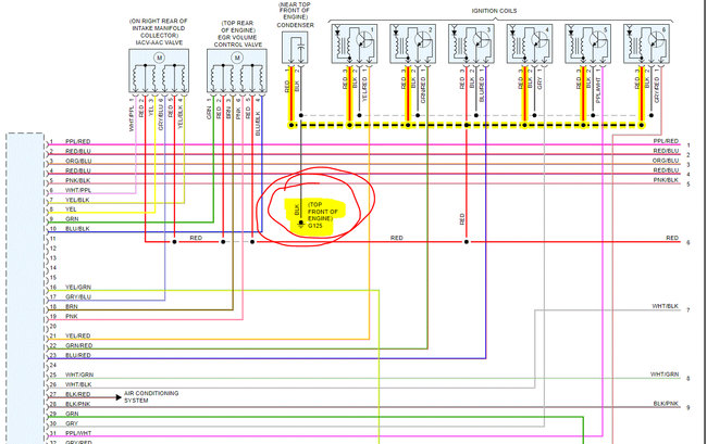

Don't know what to do. Fuse 58 good. Seems i'm getting no power to ignition coils.

First, confirm there is power both to and from the fuse. Here is a link to help:
Next, each one of the ignition coils will have a red wire going to it. Check each for power. Here is a link you may find helpful:

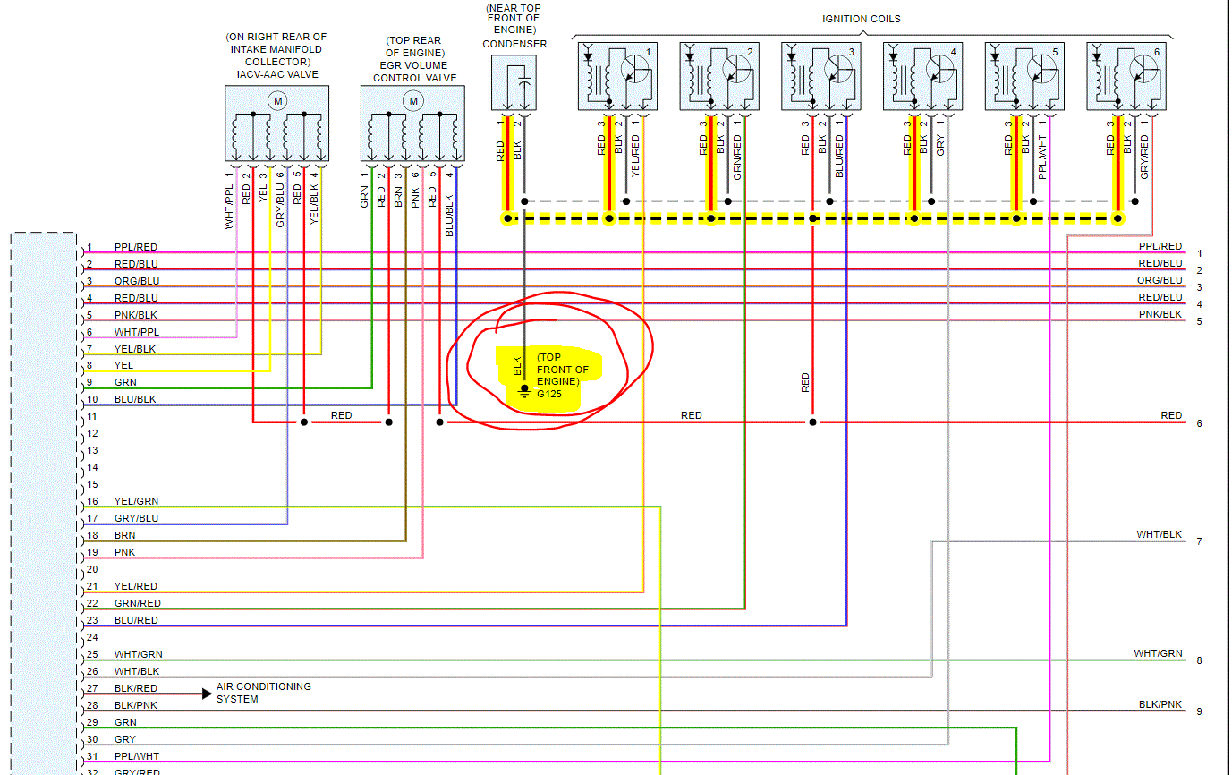

If you find there is power, then check the black wires on the coils for continuity to ground. I circled and highlighted the ground location in the pic below. Note that all coils do have that common ground point, so that could be the issue as well.
Note: I believe I answered another question that may be yours. I suggested the crankshaft position sensor. If you have power and ground, that reinforces the idea that the sensor is the likely cause.
See pic below.

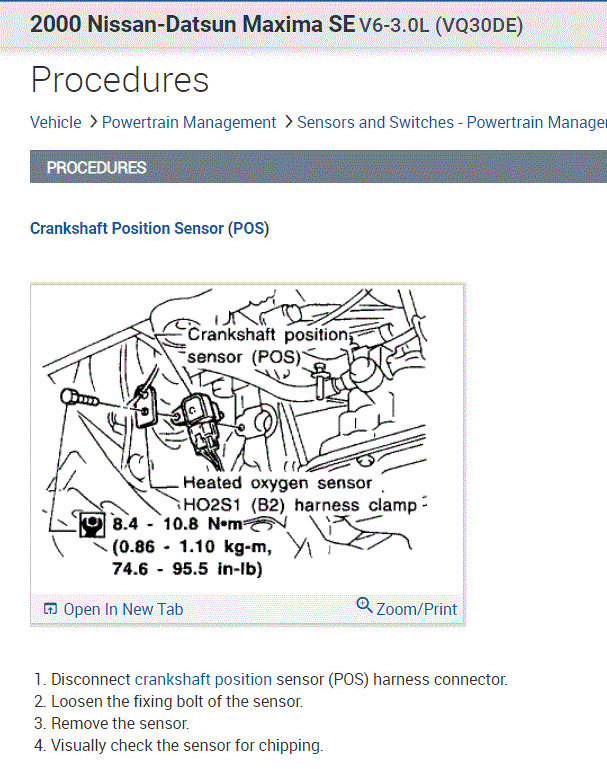

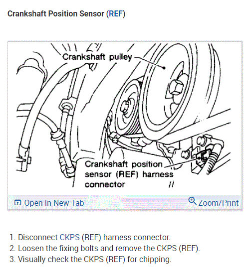

The most common cause is a faulty crankshaft position sensor (CKP). If you have a live data scan tool, see if there is an RPM signal when cranking. If there isn't, suspect the CKP.
Take a look through this link. It explains common symptoms with a faulty CKP. Let me know if it seems to mirror what you experience.
If you find the sensor is bad, here is a link that shows in general how to replace one.
If you look at the attachments below, they provide the directions specific to your vehicle for inspection and replacement.
