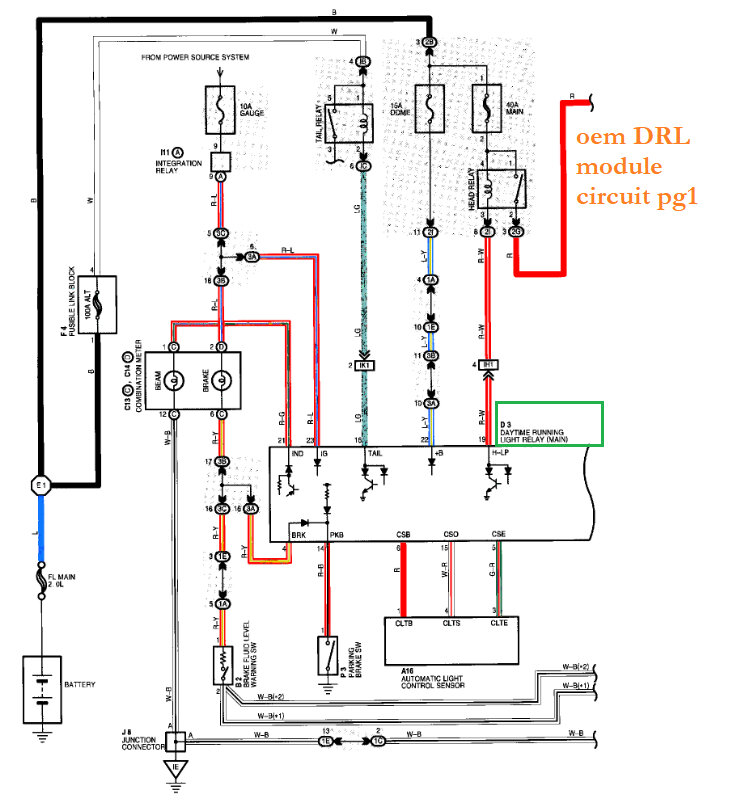

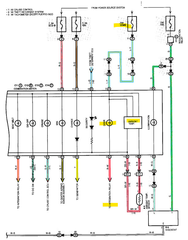

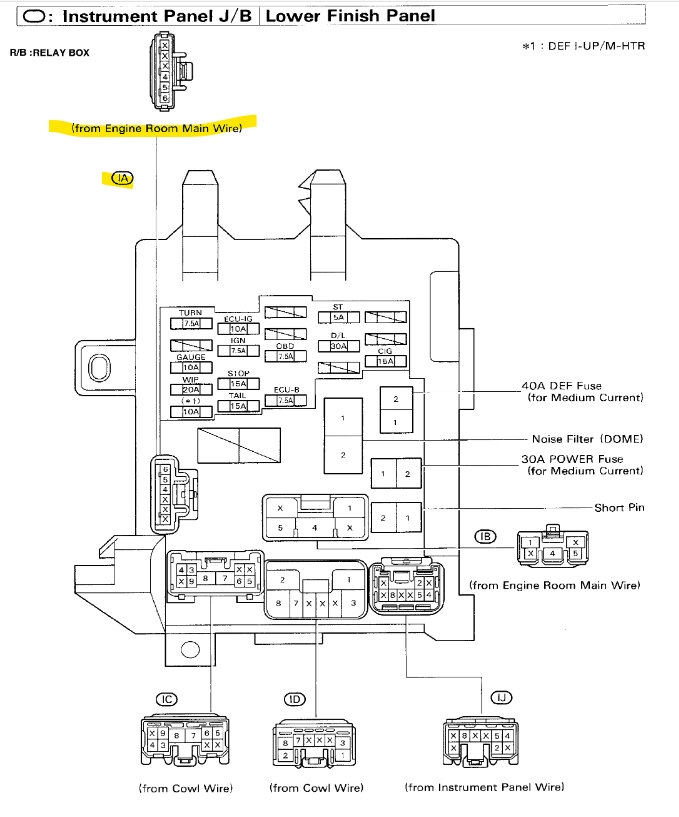

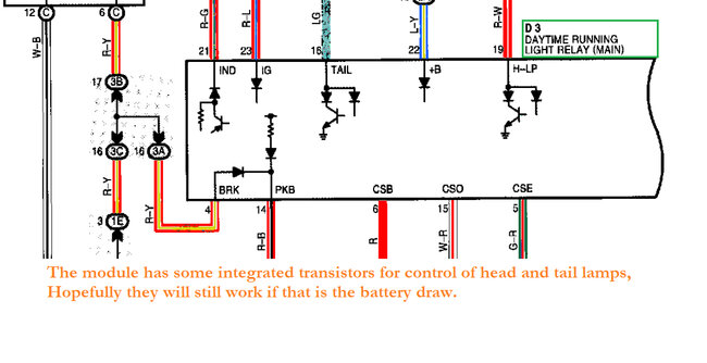

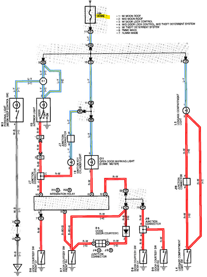

My new battery completely died after three months. I did a parasitic draw test and the multimeter read 0.25A. The fuse labeled as “DOME” dropped the Amp reading from 0.25A to 0.00A. I checked other fuses to see if there were changes but there weren’t. However now I don’t know how to check for the components as they aren’t “within hands reach”. I removed the detachable aftermarket radio. No change in Amps. The dome light was switched to off and the bulb was removed. No change. In fact, there was no change even with the light switched to on. The only change was when the door was open. Went from 0.25 to 0.35. There are no personal lights. There are no trunk lights. It’s a base CE model. There isn’t much. The theft system was disconnected years ago from under the dash. How do I check for DRLS and clock? Or how do i further test the other components? Please and thank you.
Jan 8, 2024 at 1:50 AM
AL514
  • 5,639 POSTS

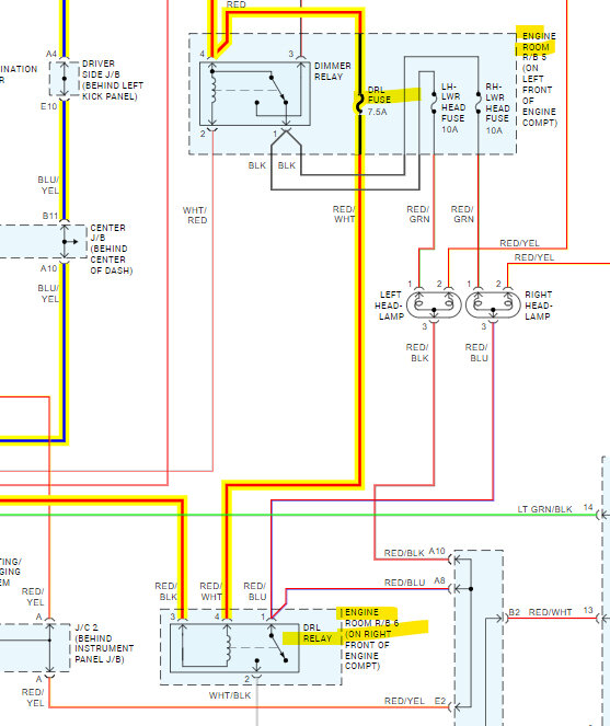

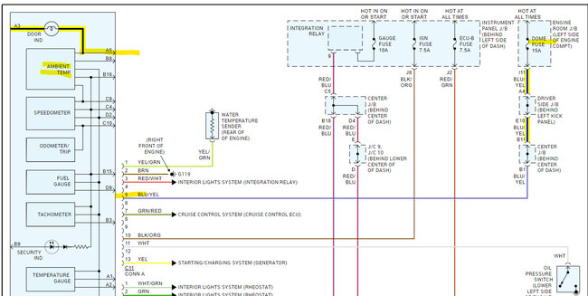

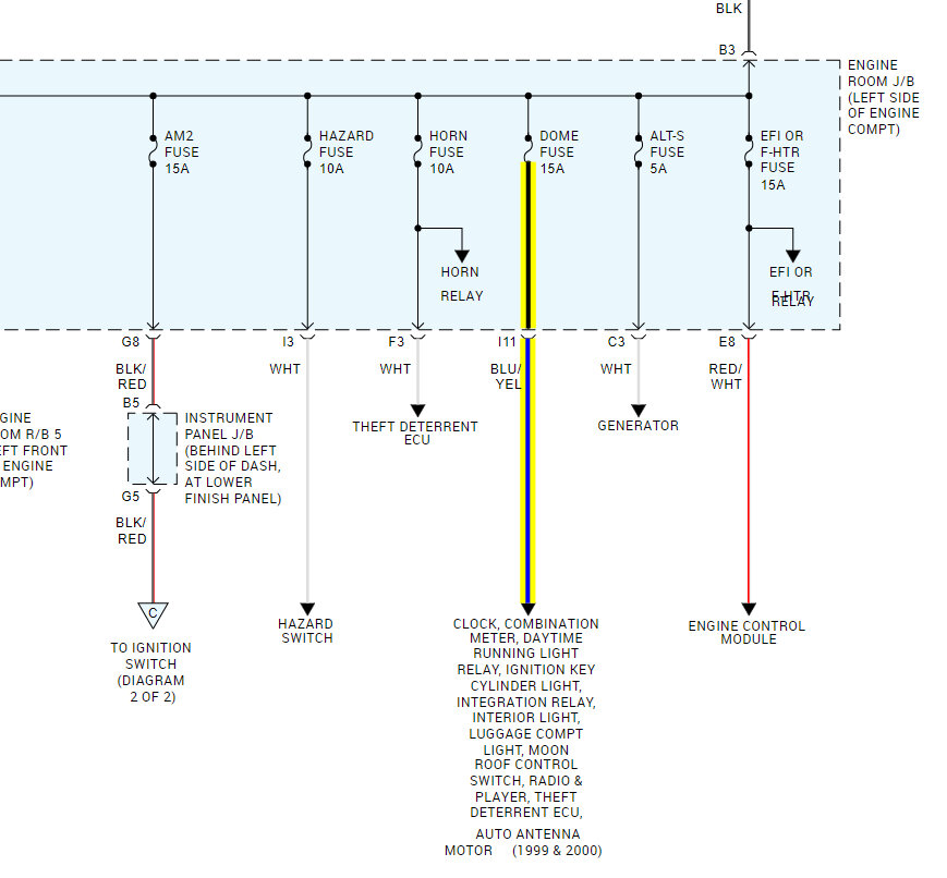

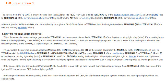

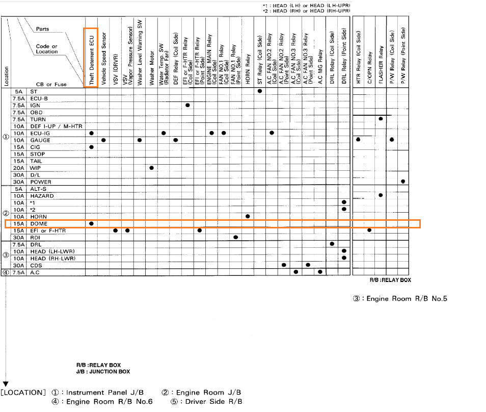

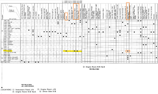

Hello, well you have narrowed it down quite a bit already. I'll post the list of components in service info on that circuit. The daytime running lights should have a relay which I'll find for you, do you have a moon(sun) roof? There is also this Ignition Key Cylinder light, not sure if you have that or not. And then the Combination Meter (Cluster) looks to be on that circuit as well, probably for back lighting.

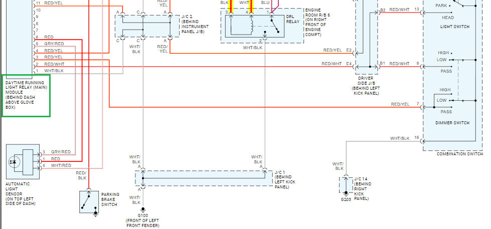

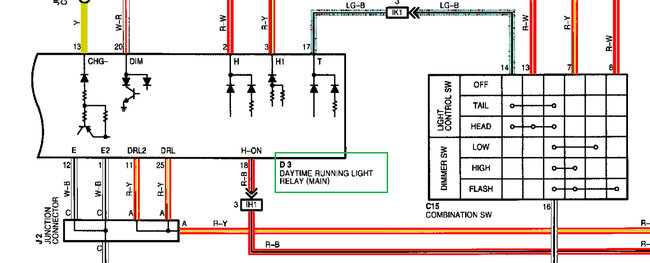

Okay, even though these are aftermarket wiring diagrams, they do show a control module for the Daytime running lights, which is most likely going to be the draw. Since it's on a Hot at all times power feed through the Dome fuse. It's behind and above the glove box, so if you take the glove box out you should be able to see. Just unplug it and make sure your headlights and tail, etc., still work okay.
The DRL Relay is not on the Dome Fuse circuit, but this control module is. You can try pulling the DRL Fuse and Relay and see if the draw drops off, but it may not, and another concern would be that the Brake Indicator and High Beam indicator don't work anymore with the DRL module unplugged, It looks like the module controls the Ground for the Brake Indicator and the power for the High Beam Indicator on the Cluster.
The Dome Fuse feeds it might be for some kind of memory since it's a constant feed.

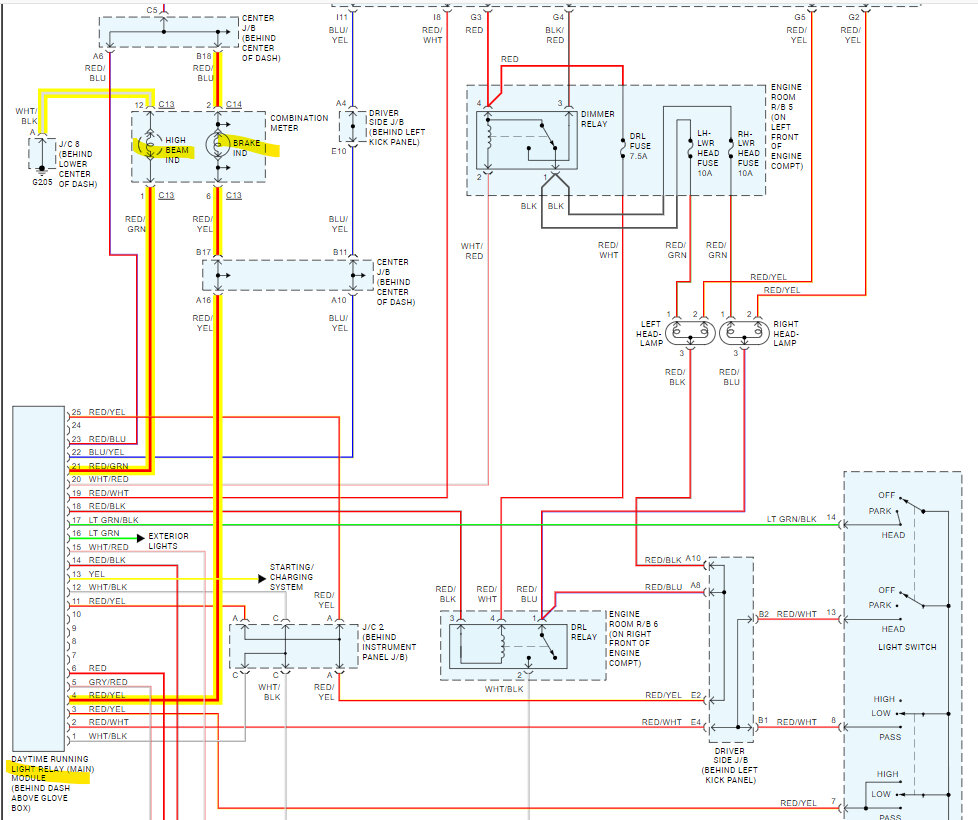

I would also check that you still have a High Beam indicator on the Cluster after unplugging the module, the Brake Indicator too is controlled by the module it looks like. The OEM shows that's its pretty integrated. It controls quite a few circuits. Maybe find a used one if possible if you lose anything on the Cluster with the module unplugged.

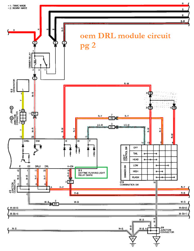

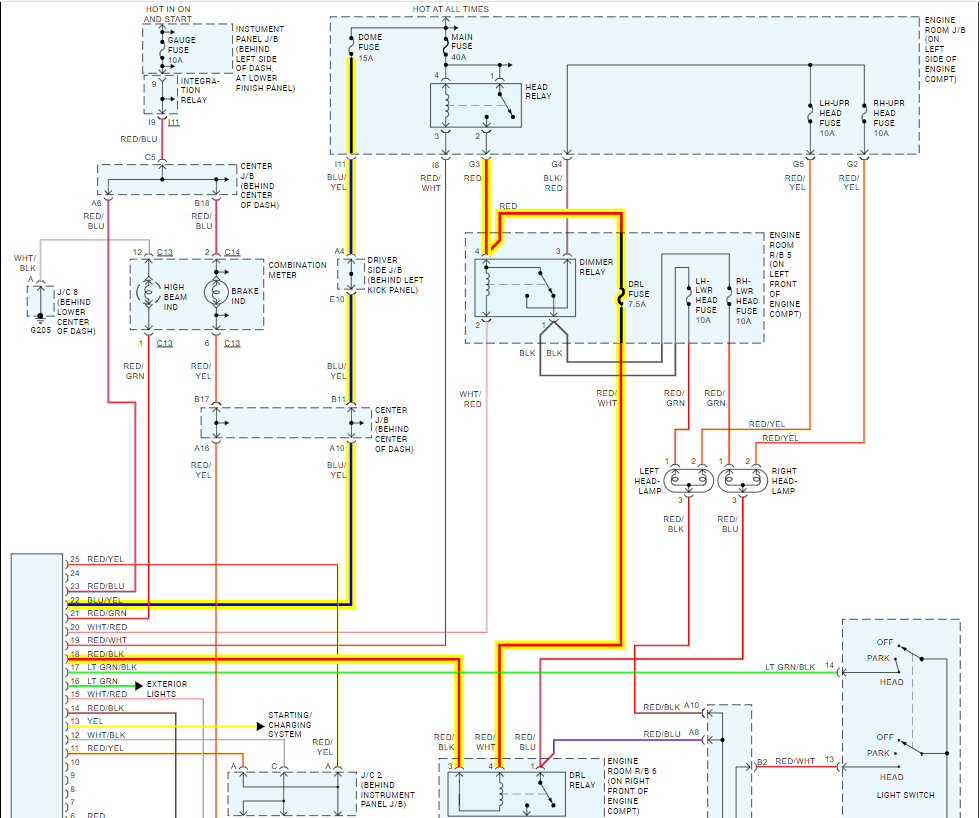

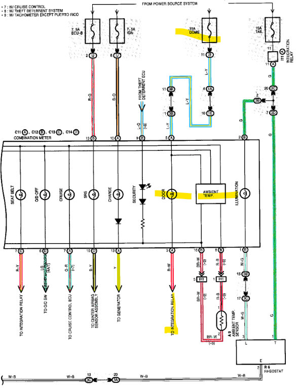

These are the OEM diagrams of the DRL control module.
The 5th diagram is the Dome Fuse to Cluster for the Door Indicator and the Ambient Temperature Display, so those are on that fuse as well.

The DRLs relay did not drop the amperage. The two cluster indicators did in fact go out with the relay but as mentioned. Doesn’t seem to be the issue as it remained at 0.25A.

Okay, so you're still at 250ma. Let's see what else could be on that circuit
Did the Ambient Temp display go out with the DRL relay disconnected too?

There's supposed to be an outside temperature display on the Cluster, your vehicle may not have it, or it may be burned out. This is the Cluster Temperature display and Door indicator, same power feed but different circuits inside the Cluster.

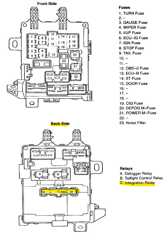

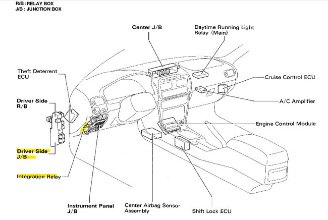

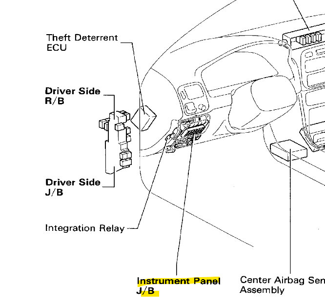

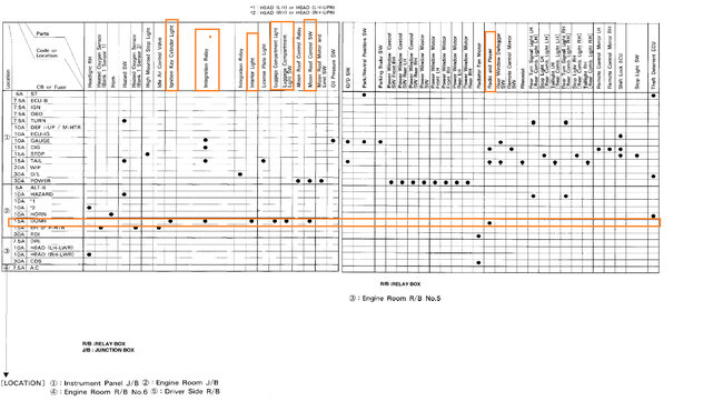

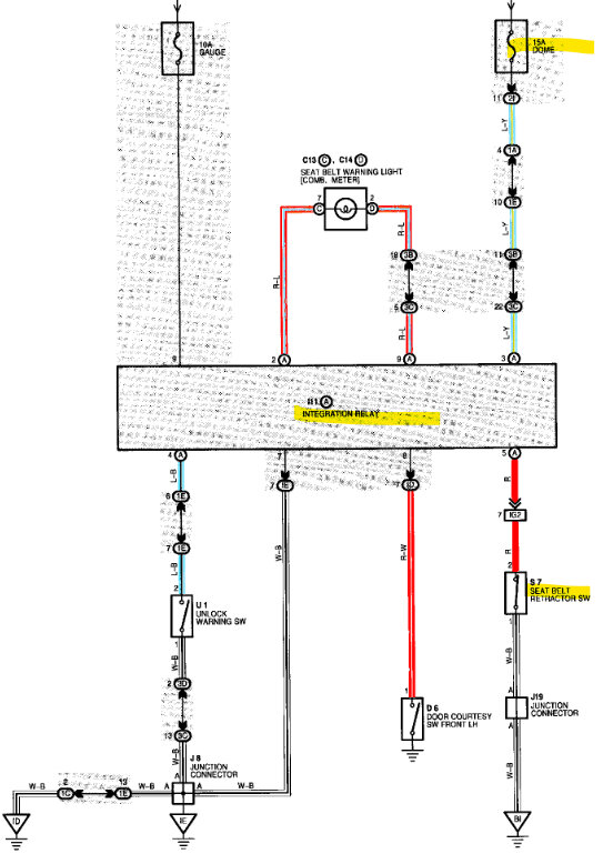

Okay, I'm not seeing much else, except this Integration Relay, which I believe is built into the Instrument Panel J/B (fuse panel) driver side dash. It activates the door lamps and seat belt indicator, etc. You may be able to unplug the connector that comes from the Dome Fuse, That blue/yellow wire, I'll see what connector it is, probably on the back of that fuse panel.
Jan 8, 2024 at 3:58 AM
AL514

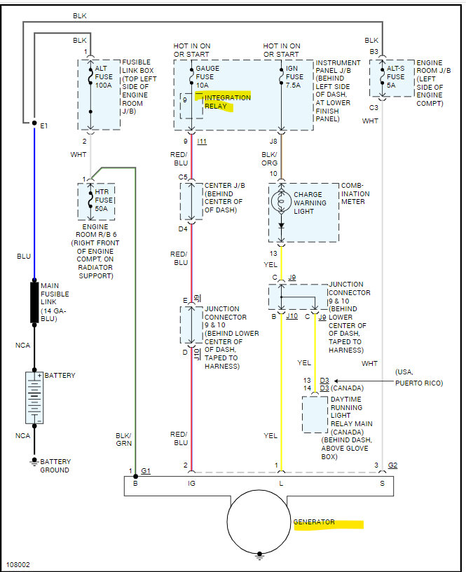

  • 5,639 POSTS

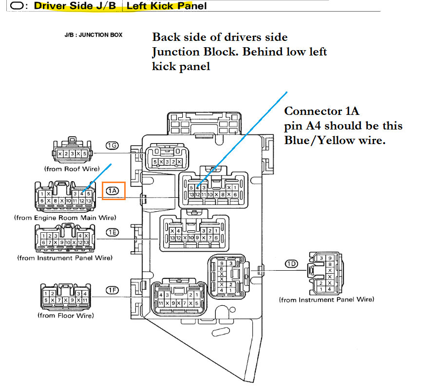

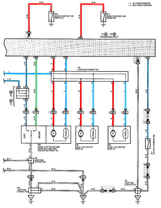

This wire needs to be blue with a yellow stripe though, at pin 4 of this connector, the other diagram is a bit different for some reason. This wire comes from the engine room fuse panel, into the Driver Side J/B on pin A4 and then back out on E10, to the Center J/B. But the aftermarket diagrams are not always correct. So just check the back of the driver side fuse panel for this connector 1A and pin 4 being the Blue/Yellow wire.
You can see in the 2nd diagram it looks different.
Here is the Integration Relay Location.
Jan 8, 2024 at 4:15 AM
AL514
  • 5,639 POSTS
Okay, here is its exact location, they have multiple boxes on the driver side, but the Integration Relay is on the back side of that driver side fuse panel, 2nd diagram labelled C.

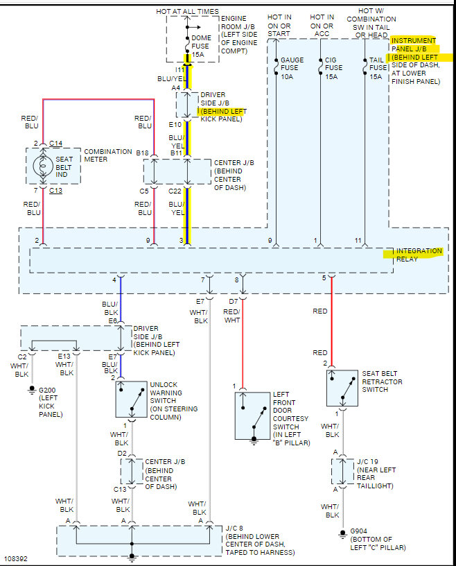

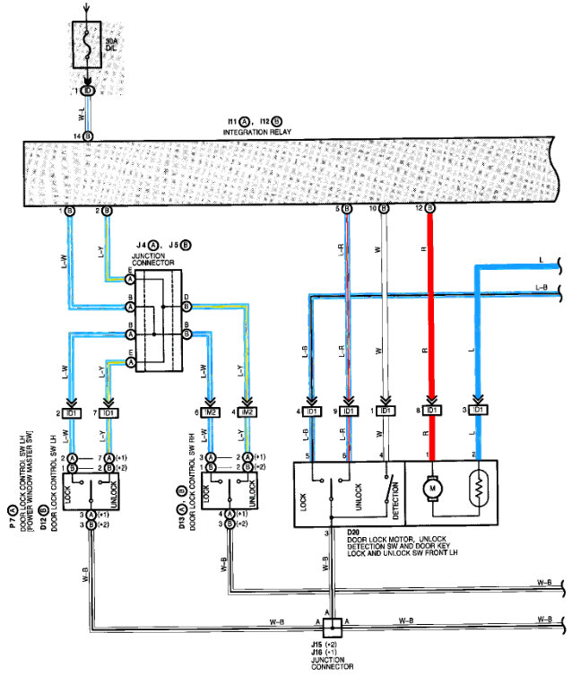

What are you using to measure current flow? If it's an amp clamp you could check each wire right at the back of that fuse panel and see which wire the draw is actually on. And trace it down that way
It looks like the Integration Relay is also the Door Lock Relay. Service info also mentions "Key Off Power window signal".

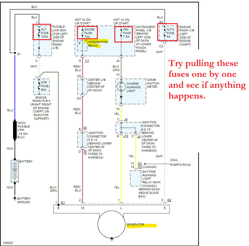

It looks like the Integration Relay is in series somehow with the Gauge Fuse which goes to the Alternator IG feed. Which I would think is an ignition feed to the Alternators voltage regulator. So, you could keep the fuse out, and put it in when you drive, I know that sounds like a huge pain.
You can also check the fuses in that driver side fuse panel for voltage drop, if you trip the door switches so the interior lights go off, that way there isn't current flowing due to the door switch and then check for any millivolt voltage drop, If there is voltage drop across a fuse there is current flowing on that fuse.
It's the method used now instead of taking fuses out, because on more modern vehicles pulling fuses wakes up networks and modules causing normal current draw.
But check the fuses on the interior fuse panel, and if you find any, you will because you have a 250ma draw.
You can figure out where the current is going from the interior fuse panel, since you have already figured out that's its originating from the Dome fuse in the engine fuse panel.
The voltage drop across fuses will be in the very low mv range, but that's how we're finding parasitic draws these days. You may even try unplugging the Alternator itself.
Maybe that Integration relay is staying on, I don't see any diagrams of its internal function. But try measuring voltage drop, set your meter on mv, or auto range if it has it. And let's see what you find. and Ill check back with you a little later.

Okay, if you already have a battery cable unhooked, just disconnect the battery cable so you can unbolt the main positive cable on the Alternator and isolate it so it doesn't short out on anything, Unplug the connector on the Alternator too and recheck for the draw. If it's still there just hook the alternator back up. This is just to verify it's not a drain through the Alternator.

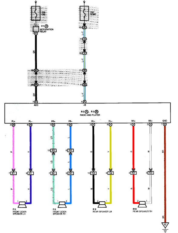

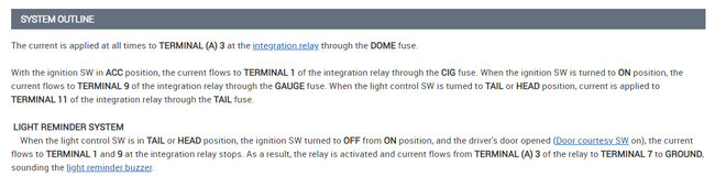

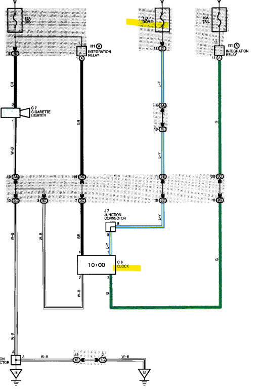

These are the OEM diagrams for the Dome Fuse. Does the buzzer still work if the head lights are left on when the key is off? The buzzer works through the Integration Relay as well.

Yes, although it looks like almost everything dealing with the Dome Fuse is related to this Integration Relay. There's a Hood switch as well, it goes to the Theft Deterrent ECU, but that's unplugged you mentioned. I'm just looking for anything on the Dome Fuse, I added a couple OEM diagrams to my last post.
There are multiple door lock motors one for each door, that of course go to the Integration Relay, they can be difficult to diagnose since they're a pain to disconnect.

There are no door lock motors. Everything is manual. It’s the basic of basics Corolla. Nearly no accessories and no electrical components. I think everything will come down to the alternator test and the removal of that relay. Is it an issue if I unplug the negative cable every time the car is stationary instead of the fuse? Find it easier to bolt and unbolt with a wrench than take off the fuse as sometimes it gets tricky to remove.

It looks like that Integration Relay is probably built into that fuse panel, and on the back side is just the harness plug for it where the power will come in or go out to whatever its controlling.
It's difficult to tell everything that it controls, I'm having to look at almost every diagram to see if it's included or not. The manufacturer should have just made a diagram for the relay itself showing everything on one page that has to do with it. The circuit for the Dome Fuse also looks to run into that Instrument fuse panel and then back out to another Junction Block in the center of the dash and then come back to the Fuse panel.
So, I think when you get to the relays connector on the back side of the fuse panel, is to disconnect it and if possible use your meter to check each pin on that connector to the fuse panel (in series) like you're doing at the battery, but this way we would be able to know exactly which wire to the relay the draw is on. If that makes sense.

Try pulling these fuses. And the relays in the engine compartment fuse panel, just to see what happens.
With this vehicle not having all the bells and whistles, this draw should not be this difficult to find. I'm looking at the Cluster right now, and it's on the Integration Relay as well, I'm not sure how difficult it is to pull the cluster, to unplug it. With no door lock motors, do you not have power windows either?
