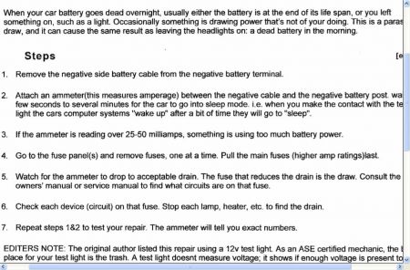

Good afternoon,
How did you do the draw test?
I attached a guide for you to perform a draw test. You measure current, not voltage.
https://www.2carpros.com/articles/car-battery-dead-overnight

Good evening,
You will need a voltmeter to do some testing.
The first thing you should do is load test the battery to make sure it is not internally shorted.
Then you will need to do a draw test.
Disconnect the negative cable and put your voltmeter in line. Red lead to the battery post and black to the cable. Let it sit for about 15 minutes to let the modules go to sleep. Then set the meter to DC amps and measure the current draw. It should be 50-75 milli amps. If you have more, pull the fuses one at a time until the draw drops. that will tell you the circuit that is causing the draw.
Jan 11, 2021 at 3:24 AM (Merged)

  • 75,992 POSTS
Could be the alternator not putting out or a short within the electrical system.. Get the alternator load tested and a parastic drain test on the electrical sysytem.
https://images.2carpros.com/forum/automotive_pictures/12900_parastic_draw_1_11.jpg
