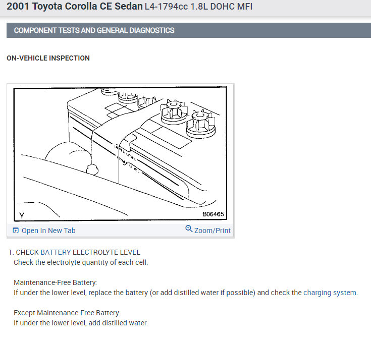

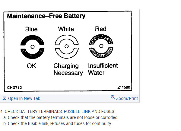

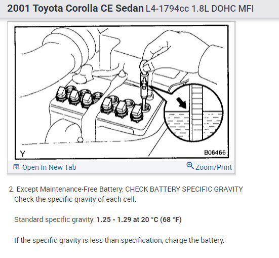

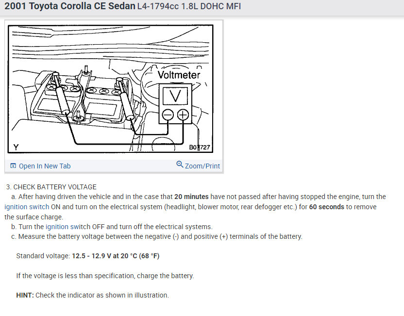

Anytime you work with a car battery be sure to use personal protective gear. As the battery acid is corrosive it can damage your skin and your clothes.
It is a good idea to wear rubber gloves and safety glasses.
You can replace your battery by using basic hand tools.
Here are some helpful info on battery replacement:
https://www.2carpros.com/articles/how-to-replace-a-car-battery
https://www.2carpros.com/articles/how-a-car-battery-works
https://youtu.be/6ICVHELnTH0
