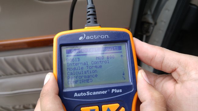

What does P061B mean?
2006 FORD E-SERIES VAN
117,000 MILES • 5.4L • V8 • RWD • AUTOMATIC
CHRISTINE2365
wrench light and engine light came on. I changed the app sensor and the other sensor cant think of the name right now. It cost me $273.00 and it is not fixed. It was stalling while driving before i changed the two sensors. Now it just seems like it is choking and it is not running smooth. What does that code mean now? ugh

All I can see about that code is that it indicates that a calculation error occurred in the power-train control module. And to look up P2016 for causes. I am doing that now.
Aids Check for sensor and circuit related DTCs. Do not install a new electronic throttle body (ETB) for this DTC. straight out of the ford manual

This is the second time I had my code printed out. First time from Autozone, so I replaced the two sensors, app and another above the app sensor for the throttle problem we thought that would fix it. But two days later it was running rough like choking. I put in injection cleaner and water removal in gas tank hoping that would help. Nope today it choked and wrench light and engine light came on so the third picture is from Advanced auto and the p061b code came up this time. I just need to know how to fix this problem.
