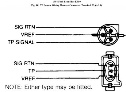

Problem seems to be voltage below expected and possible causes are :
1. Circuit grounded in wiring harness
2. Faulty Sensor ( not likely to be so many sensors being faulty at the same time.)
3. Faulty PCM.
4. Faulty connection.
Perform the followng test first.
Check VREF Circuit Voltage at TP sensor.
Turn ignition off.
Disconnect wiring harness connector from suspect sensor ( IAT, ECT).
Disconnect TP sensor.
Turn ignition on.
Measure voltage between VREF and SIG RTN at TP sensor wiring harness connector.
Voltage should be between 4 to 6 volts.
https://www.2carpros.com/forum/automotive_pictures/192750_TPSensorWiring94E350Fig10_1.jpg
-1
