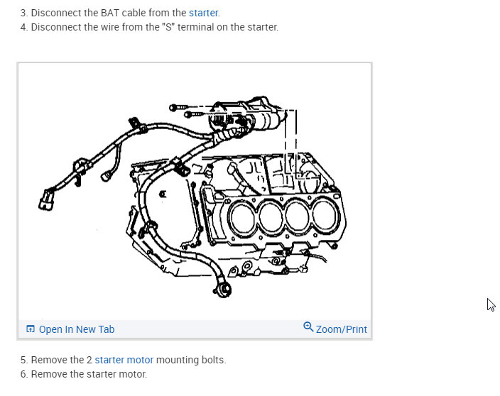

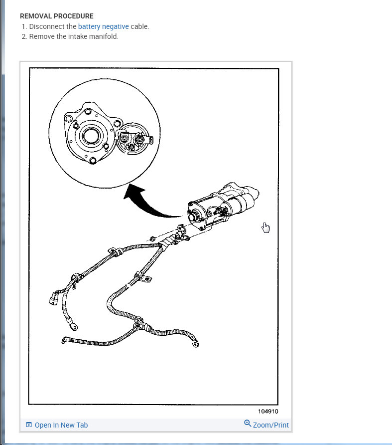

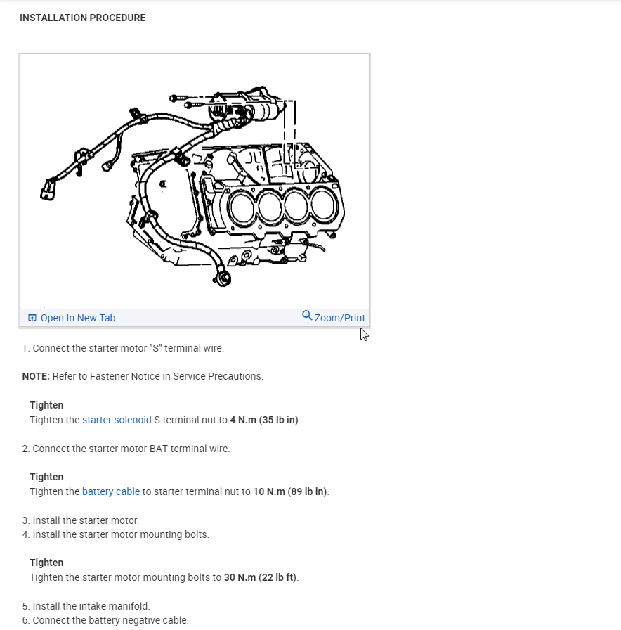

Okay. If the car turns over by hand but the starter just clicks that is either a weak battery or the starter has failed.
Seeing as how it was starting before but you had to charge the battery, I suspect you have a battery issue rather then a starter issue. We need to do what is called a load test on the battery. Can you remove it and take it to a parts store and have them load test it and see if it fails. If it does, we need to replace the battery and retest the starting. If it still just clicks then it is a a starter issue.
Here are some guides that covers this information:
