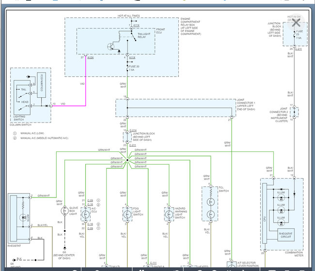

Interior lights for my gear shift and climate control do not work
2006 MITSUBISHI GALANT
207,000 MILES • 2.4L • 4 CYL • 2WD • AUTOMATIC
MK7CASEY
  • 17 POSTS
My interior lights for my gear shift and climate control don’t seem to be working, only the lights behind the cluster seem to work, all other lights work, however.
Feb 9, 2022 at 1:04 PM
We need to start with checking power and ground at one of these bulbs. Basically, we need to find out if there is power and if so, we have a ground issue. If there is no power, then we have a wiring or power source issue.
Here is a guide that will help with this:

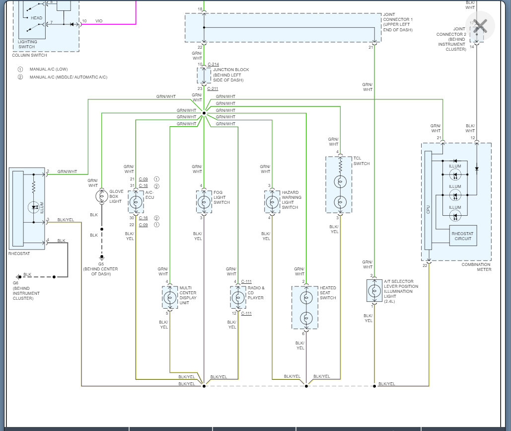

I am attaching the wiring diagram below and it appears all these lights are on the same circuit which means I would suggest we start with the fuse and relay.
Please run through this info and let me know what questions you have and what power you find at the lamps and then the fuse.
