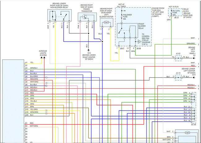

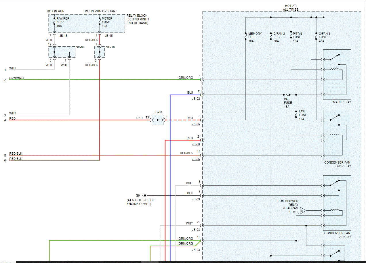

What all is in the electrical circuit for the air conditioner?
2005 KIA SORENTO
100,000 MILES
UHSNOEBIRD
  • 342 POSTS

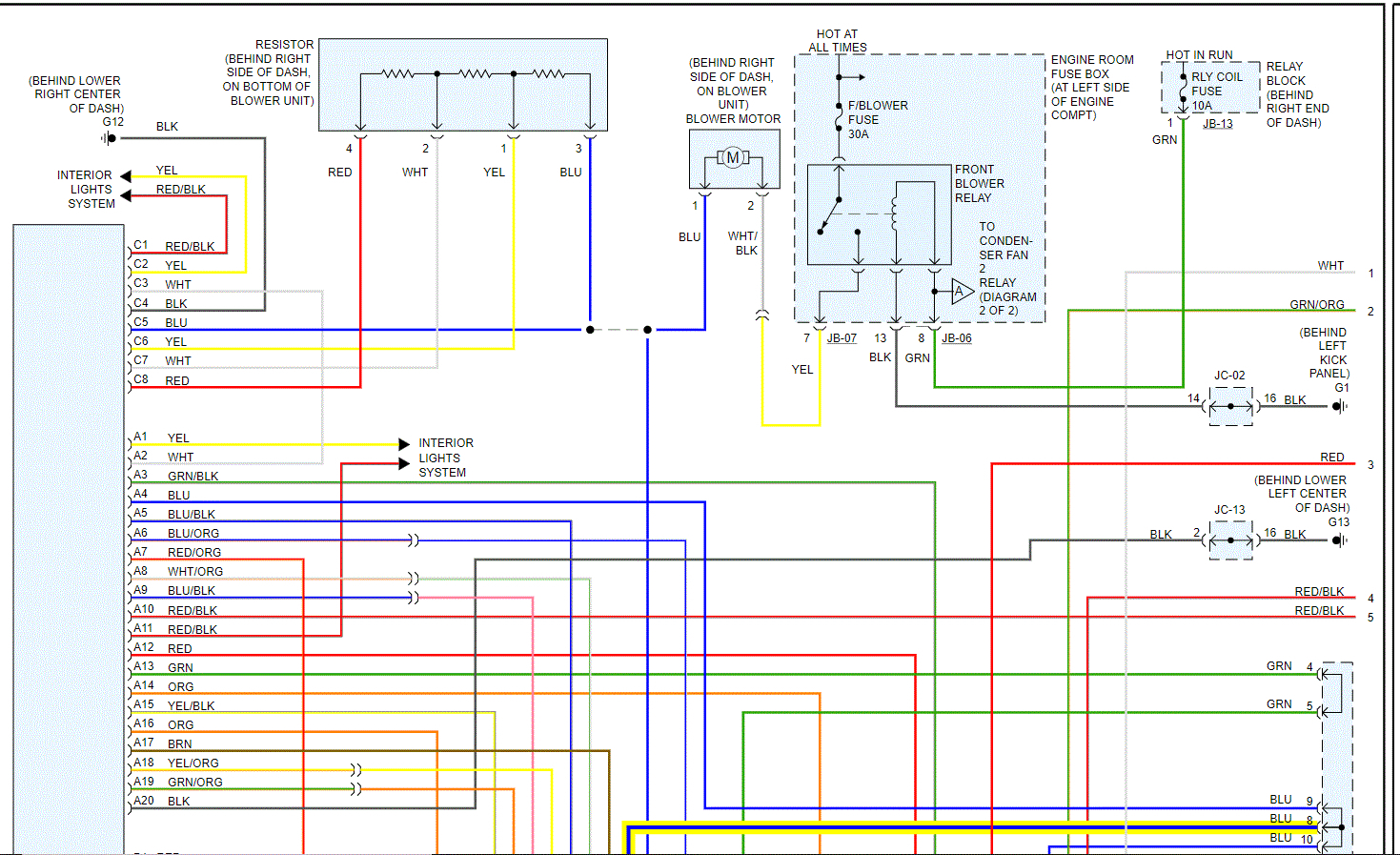

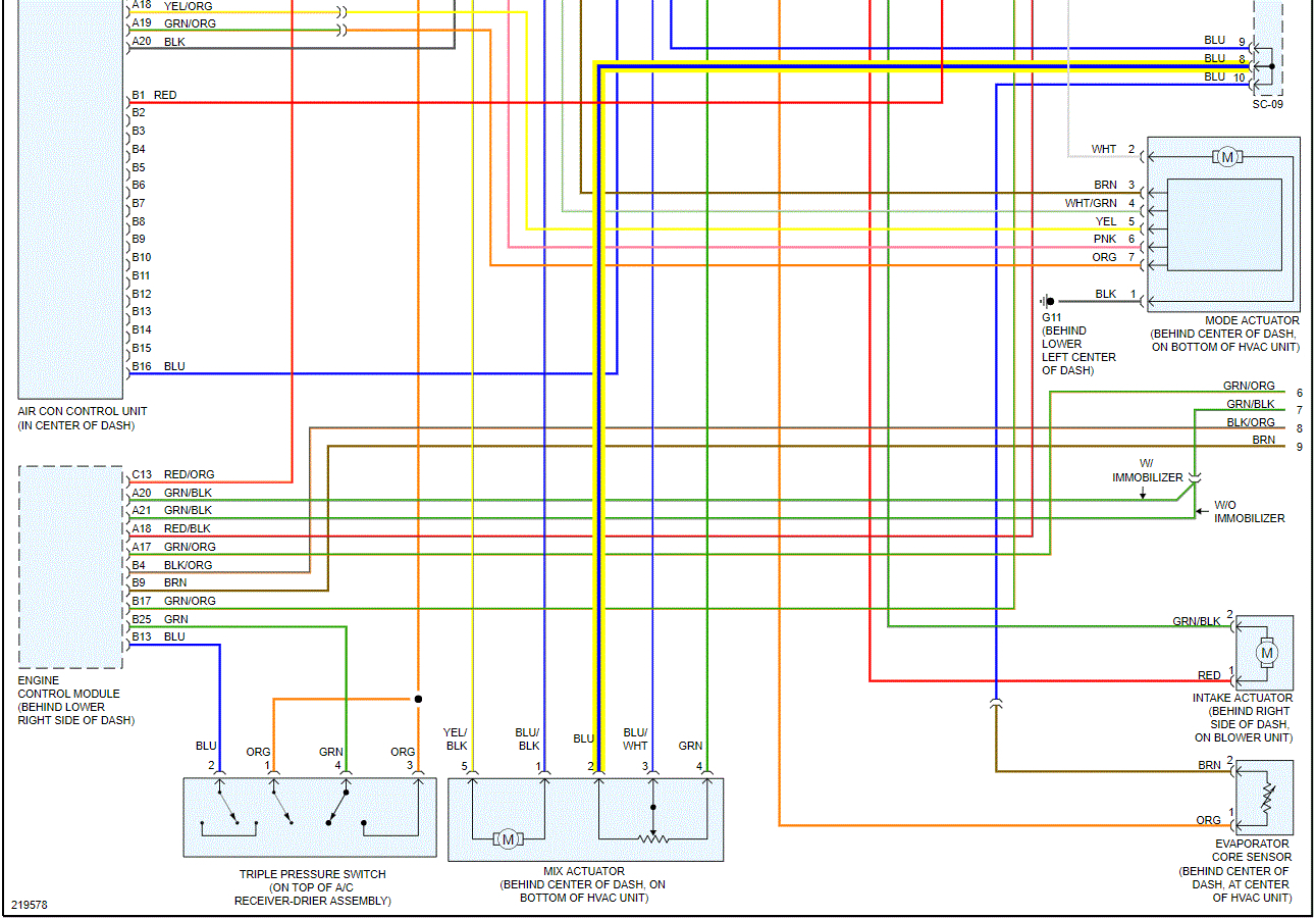

Does this vehicle have a low pressure switch, relay and/or fuse that helps control this air condition circuit?
Jun 24, 2021 at 12:50 PM
  • 110,194 POSTS
There are several fuses related to the system and there is a triple pressure switch which is located at the top of the receiver dryer. Additionally, there are relays to consider.
I'm not sure what is happening to the vehicle, so I can't suggest what to check. If it isn't working in general, take a look through this link and see if it helps:
Also, I attached the entire wiring schematic below for the manual AC system. If you have automatic temperature control, let me know and I'll get you those schematics.
Here is a link you may find helpful if you need to check the wiring:
Let me know if this helps.

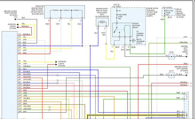

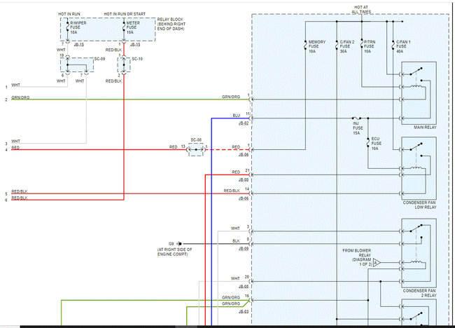

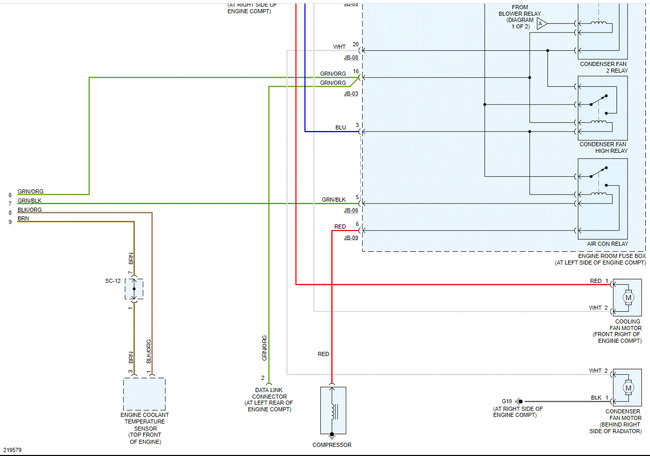

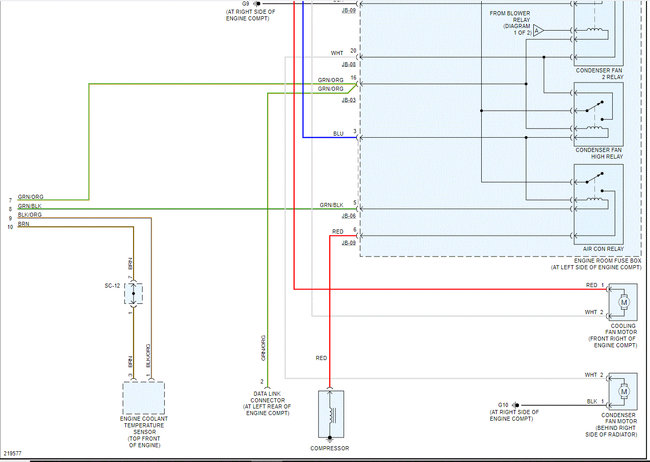

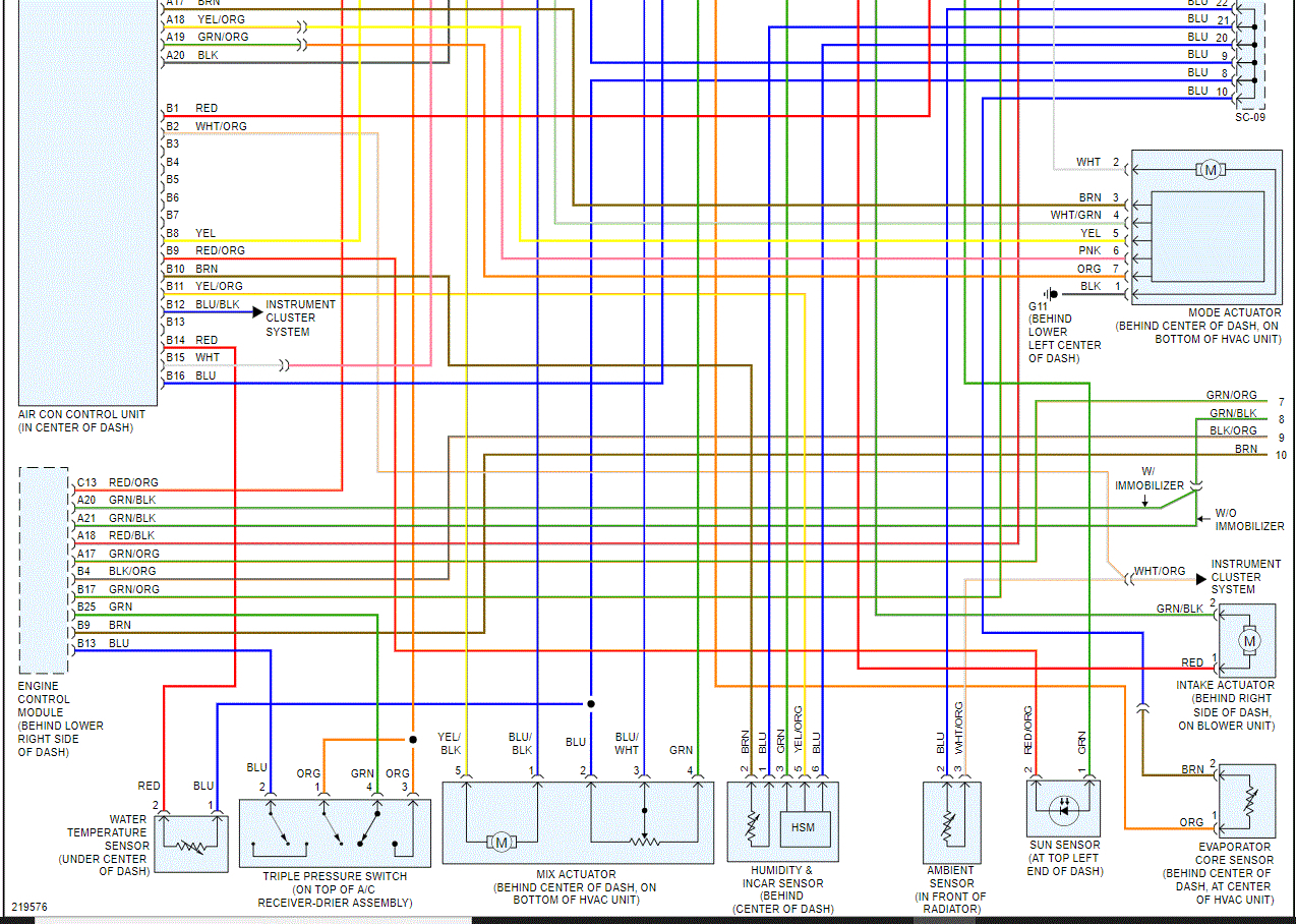

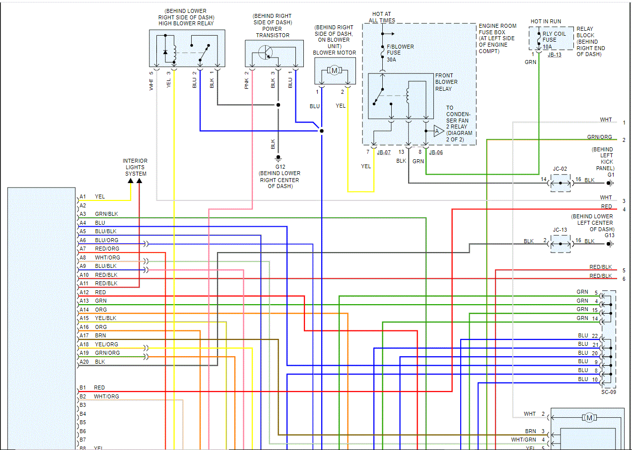

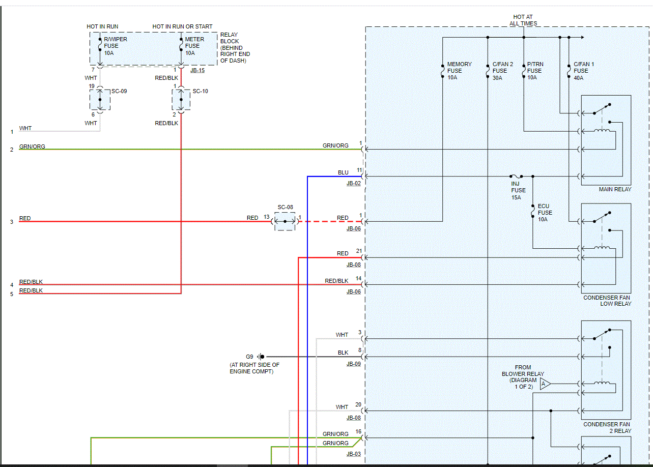

I think it has automatic air control for the air condition. See if you have anything on that.
Jun 25, 2021 at 7:21 PM
  • 110,194 POSTS
No problem. I attached the schematics below for the automatic system. Again, I had to cut the pics in half to make them readable, but I did overlap them.
Take care and I hope this helps.
Jun 25, 2021 at 7:52 PM

How much voltage should I get from the trinary switch that is in picture 2 that you sent me?
How do I check this trinary switch ?
I think it's for high pressure a low pressure.
Jun 29, 2021 at 2:22 PM
  • 110,194 POSTS
I believe you are referring to the triple pressure switch. There should be a 5v reference to it via the orange wire at connectors one and three.
In the manual, they are not showing a test procedure but reading through the schematics, that is what I getting from them.
