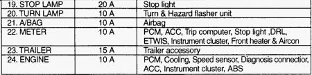

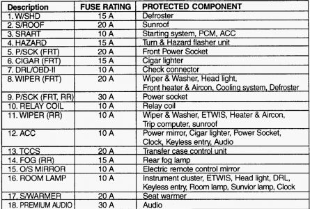

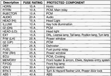

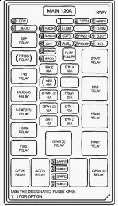

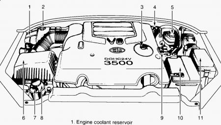

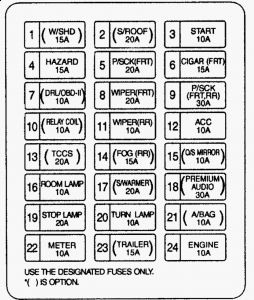

Check for fuse in car and under the hood, one power is restored, if it does not work, we can read the fault codes on the display panel. here is the fuse box layout formation in car:
https://www.2carpros.com/forum/automotive_pictures/62217_Fusesa_2.jpg
https://www.2carpros.com/forum/automotive_pictures/62217_fusesb_2.jpg
https://www.2carpros.com/forum/automotive_pictures/62217_fusesc_1.jpg
And under the hood.
https://www.2carpros.com/forum/automotive_pictures/62217_Enginea_1.jpg
https://www.2carpros.com/forum/automotive_pictures/62217_engineb_1.jpg
https://www.2carpros.com/forum/automotive_pictures/62217_PDCa_1.jpg
https://www.2carpros.com/forum/automotive_pictures/62217_PDCb_1.jpg
https://www.2carpros.com/forum/automotive_pictures/62217_PDCc_1.jpg
Check all that have anything to do with heat, A/C, and defrost. Report back when done.
