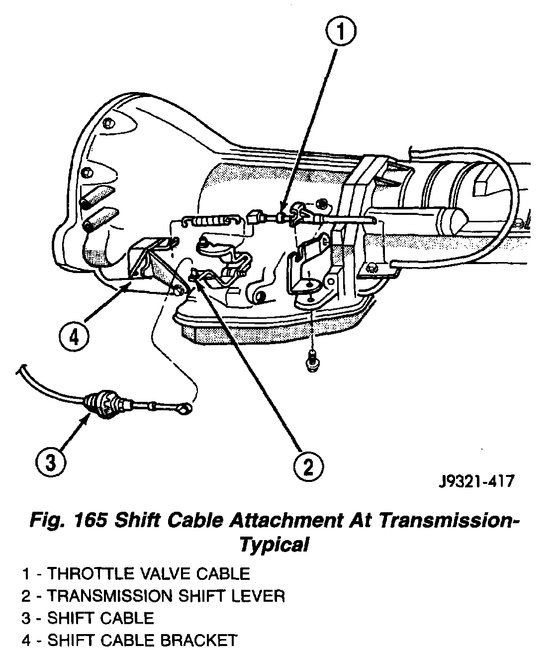

I have a weird issue with my vehicle listed above (Sport). My transmission shifts through gears fine, I have done a fluid flush as well and it does what it's supposed to. The strange part is that, while the car is running, it only goes in drive, park works, reverse just doesn't do anything (engine just revs) neutral works just like drive, and of course drive works as it should. if i put the transmission in neutral and shut it off the engine it rolls freely like it's in neutral, when i start the Jeep back up it drives forward when in neutral, no clue what to do.

The description makes it sound like there is a linkage problem. The cable runs from the shift lever through the dash and down to the transmission. It clips into brackets at both ends. If the cable were to come out of a bracket it could allow the transmission to shift strangely. If you go underneath the truck and check the cable routing it should be easy to tell. If you have access to a lift or a way to get the wheels off the ground you could move the shift lever to verify that it works in each gear. When the transmission lever is moved fully to the back it is in park. If you shift that lever one detent forward and still have no reverse then there is an internal failure and either a rebuild or replacement transmission is likely the only repair.

Copy, thank you. I'll check it out and see what I can do. What does the transmission being in gear only when the Jeep is shut off mean? Possibly a pressure or electrical issue?

If the linkage is not correct the transmission and the pressure control cable would be out of sync. It could actually be in gear while the shift lever is in neutral.

Sorry got busy there for a few days. Makes a lot of sense, I plan on checking it out tomorrow. I've also done a lot of reading and heard that it could possibly be the reverse band in the AW4, apparently it has a tendency to go if the transmission is run on low fluid. First thing I'll check is the shifter linkage. Anything else I should be looking at or other ideas as to what it might be more specifically outside of a full rebuild/replace?

The band shouldn't cause the failure modes you have. A bad linkage or transmission throttle valve cable that is out of adjustment can cause a lot of weird issues as well.
As for the rebuild or replace. If you have a transmission shop that will rebuild using all the latest upgrades and better parts then I would probably go that route. If not then look for a place that has re-man units that are updated. This assumes that the rest of the Jeep is in good shape though. If it is heavily worn or rusted you might want to just find a used transmission at a salvage yard or you-pull-it place and just run it until it is time for it to become a parts donor.

I took it into a transmission shop because I just couldn't figure it out myself. They put it up on a lift, didn't touch anything just did some testing, took it back off the lift and it went in reverse. They and myself are assuming something got jostled back into position, I'm having them take it apart anyways just to figure out what's wrong. Thank you for all your help.
