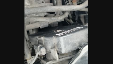

noise that comes after starts up and goes away when engine heats up?
2012 VOLKSWAGEN JETTA
170,000 MILES • 2.0L • 2WD • MANUAL
33ADEL33

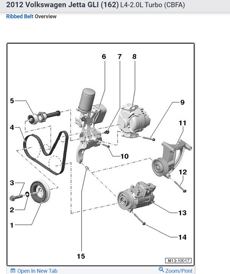

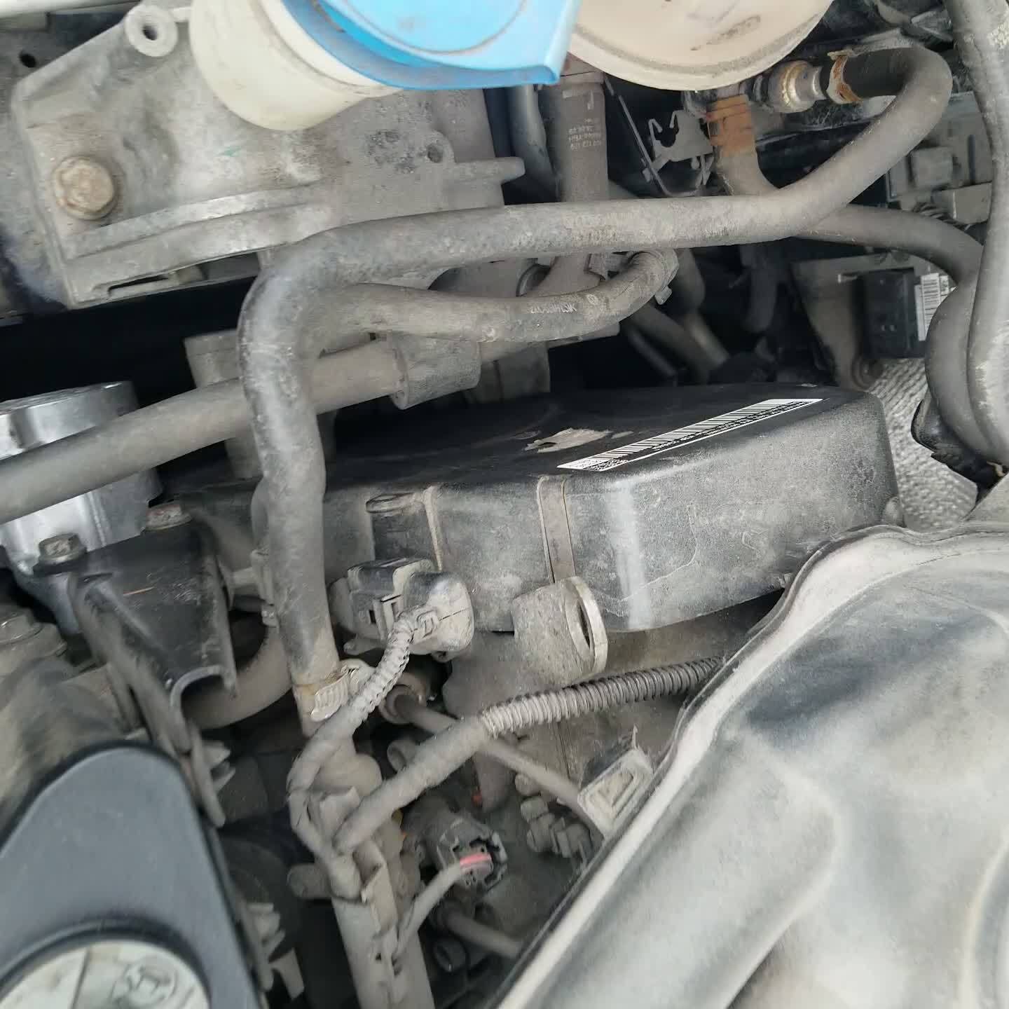

I have this noise that comes after starts up and goes away when the engine heats up. Video is attached, thanks.
Apr 30, 2023 at 1:47 PM
  • 55,423 POSTS

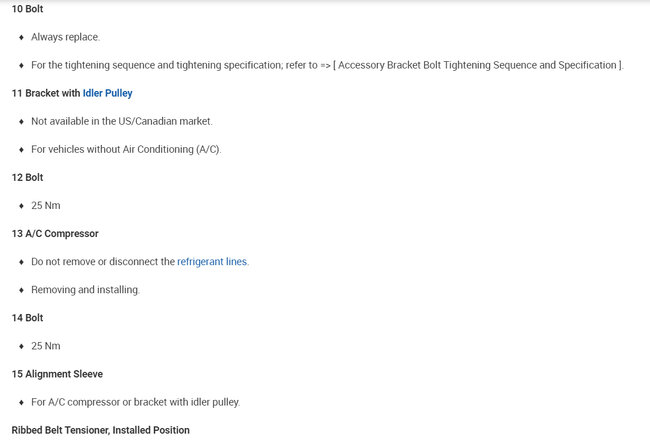

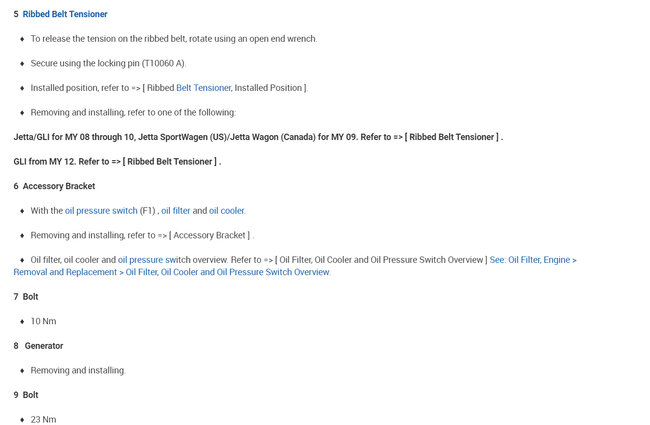

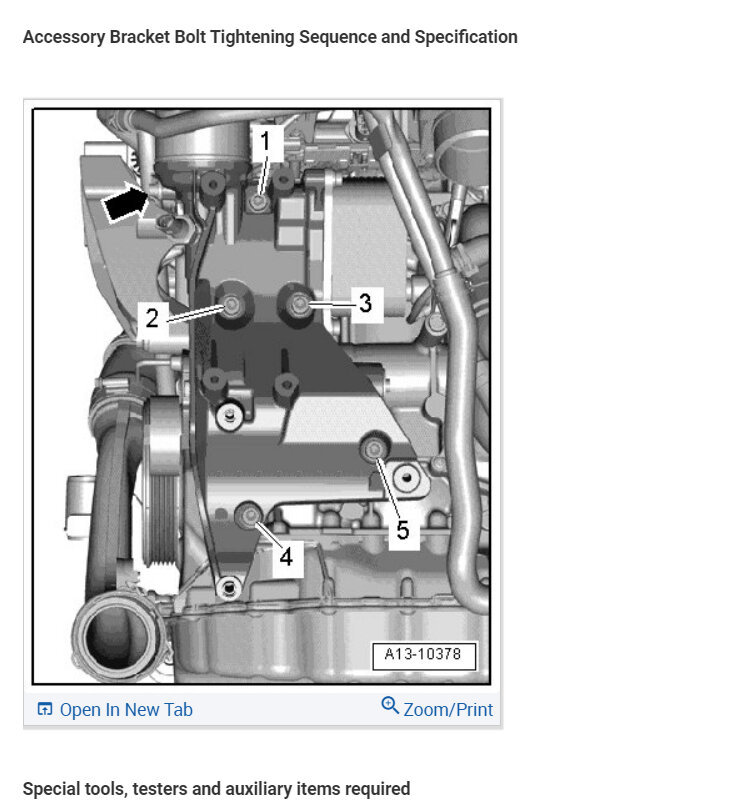

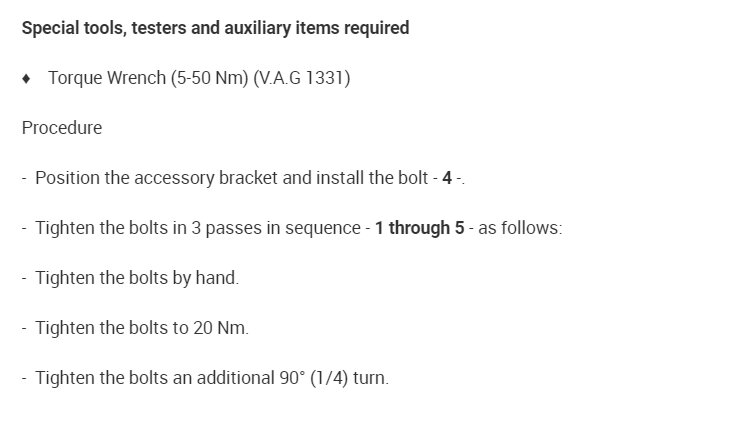

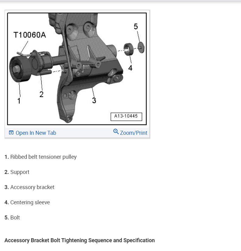

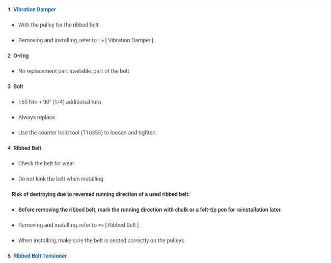

Thanks for the video, it helps. It sounds like you have a bearing going out in a serpentine belt tensioner. I would remove the serpentine belt and spin each one of the accessories and tensioner pulleys to see which one is making the noise then I can give you instructions on how to change it out.
This guide can help, and I have included instructions for your car in the images below:
I have seen a worn serpentine belt itself cause noises as well so if the belt is cracked or glazed, replace the belt. Check out the images (below). Let us know what happens and please upload pictures or videos of the problem so we can see what's going on.
