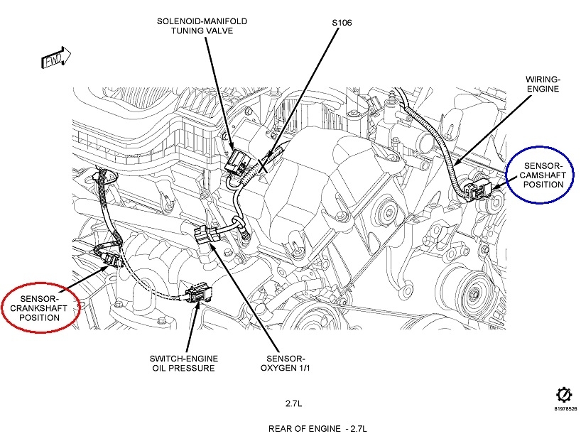

The second common cause of a crank / no-start is a loss of signal from the crankshaft position sensor or the camshaft position sensor. This is where the diagnostic fault codes are very helpful. In particular it is real common on all car brands for those two sensors to fail by becoming heat-sensitive, then they work again after cooling down for about an hour. The typical symptoms are the engine runs fine until you stop for a short time, as in when stopping for gas. Heat from the engine has time to migrate up to the sensors, causing one to fail, then you'll have the crank / no-start condition. As long as you're driving, natural air flow keeps those sensors cool.
When the signal is lost from one of those sensors, the Engine Computer still turns the automatic shutdown, (ASD) relay on for one second to run the fuel pump, as before, but it doesn't turn it back on when the engine is rotating, (cranking). That relay also powers the ignition coils, so you'll also have no spark along with no injector pulses and no fuel pump. The loss of spark is the clue to look for. The next time the no-start occurs, check right away for spark before the defect goes away. Here's a link to an article on how to do this:
https://www.2carpros.com/articles/how-to-check-for-ignition-spark
If you do find spark is missing, it is possible to have an intermittent problem in the ignition system alone, but by far it's much more common to lose spark, fuel pressure, and injector pulses all at the same time, and that's almost always due to one of those two sensors.
The problem with those sensors is if there's no diagnostic fault code stored in the computer related to them, we'll need a scanner to see which one is missing. Once we know that, the loss of signal is caused by that sensor around half of the time. We also have to consider its connector terminals and wiring. One check you can do yourself is to gently wiggle the wires while the engine is running. If doing that causes the engine to stall, the connector is the better suspect, not the sensor itself.
A connector or wiring problem will also cause the engine to stall while you're driving. If that doesn't happen, a failing sensor is most likely to show up when restarting a hot engine.
Tell me what you find with those suggestions, then we'll figure out where to go next.
