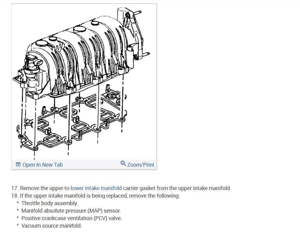

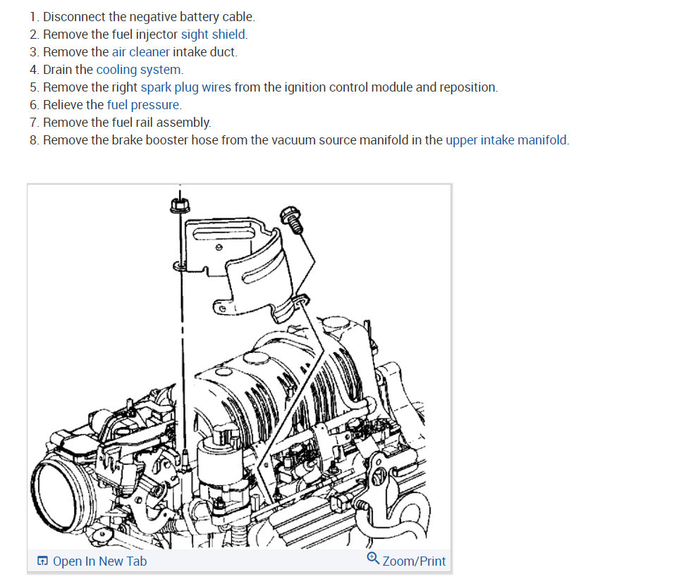

I replaced the lower intake manifold gasket and manifold. The manifold was severely pitted at the water ports. I also replaced the upper intake plenum and gasket. When I fill the radiator with water, water trickles through the throttle body via the round port. Also, my oil pan is getting water as water is mixing with oil. Does this mean my head gasket is blown? If yes, besides changing the head gaskets and head bolts must I take the heads to a machine shop for reconditioning? Any information is appreciated. Thank you!
May 8, 2021 at 2:12 PM
Good afternoon,
I would start by doing a pressure test on the cooling system. I would remove the spark plugs for this test. When it pressures up, see if it leaks out the cylinders or if it comes from the throttle body.
https://www.2carpros.com/articles/radiator-pressure-test
https://www.2carpros.com/articles/replace-intake-manifold-gasket
This does not sound like a head gasket.

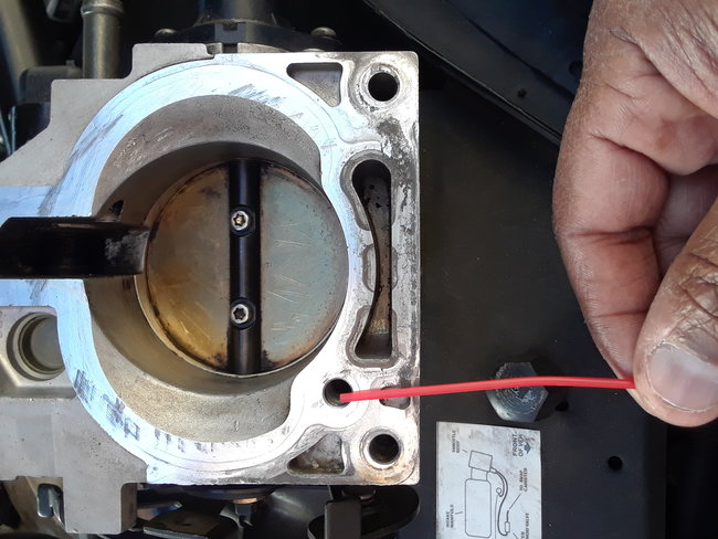

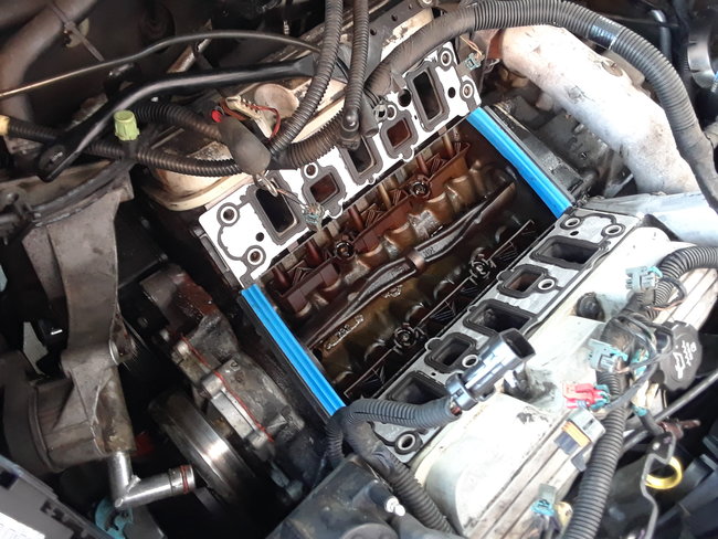

Thank you for your reply. Consider the screenshot. On the intake manifold near the EGR stovepipe there are 2 round ports through which coolant should flow. There is 1 oval port through which coolant should not flow. I understand that gases should through it. On my engine when I add water to the radiator I hear water gurgling up into the engine and flowing out the three ports near the EGR stove pipe. How can this be? This evident without the upper intake plenum attached.

The red straw indicate where water is flowing through. No water should flow through here, correct?
May 10, 2021 at 12:07 PM
That would indicate the lower manifold is allowing the water up that port.
May 10, 2021 at 12:08 PM
If you add air to that port from a compressor, does it go to the cooling system?
If that is for the EGR, no, it should not have water there.

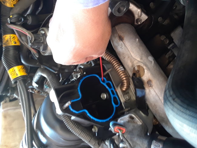

When the throttle body is attached and I add water to the radiator water flows through this port and into the air snorkel.

Nope. Not the gasket. That would not come back into the throttle body.

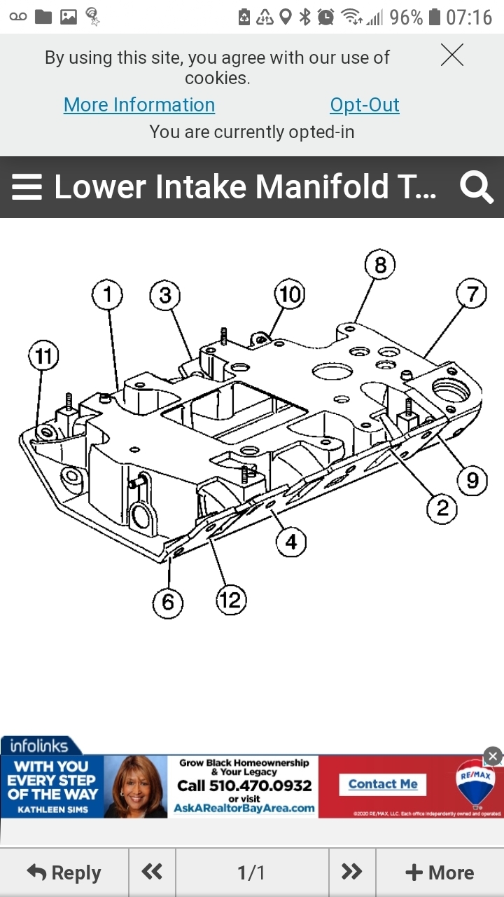

When I remove the lower intake manifold I see intake runners and water jackets on the cylinder heads. On the rear bank cylinder head I see a small port tucked up high that is not a water jacket. It seems to be a air channel. The lower intake manifold gasket makes space for it; does not block it off. Seems like if water flows through it is a tell that the head gasket is done???

Consider the rear bank cylinder head. Lower intake manifold gasket is in place. There is a round hole on the gasket between the intake runner and the water jacket. Why is there a hole there? I think water is come through that hole through the lower intake manifold through the upper intake plenum and through the throttle body. But why?
May 10, 2021 at 12:39 PM
Okay, the picture is way too small to see any of the ports you have identified.

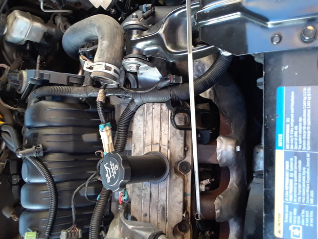

I would remove the plugs on the rear and air up each cylinder to see if air or coolant comes up that passage. If it does, then you may and I mean may have either a head gasket or cracked head.

Prior to the repair I noticed sludge (water and oil) on the throttle body screen. My air filter was also wet and had a circle stain like it got water through the snorkel on it.
The engine had an external water leak on the drivers side. The engine got overheated just before the repair.
However no water in the oil until after the intake manifold gasket, intake manifold, upper plenum, and upper plenum gasket replacement. Not sure if it all went out the tailpipe.
I will try the compressed air into the spark plug holes with the intake manifold and intake manifold gasket removed.
