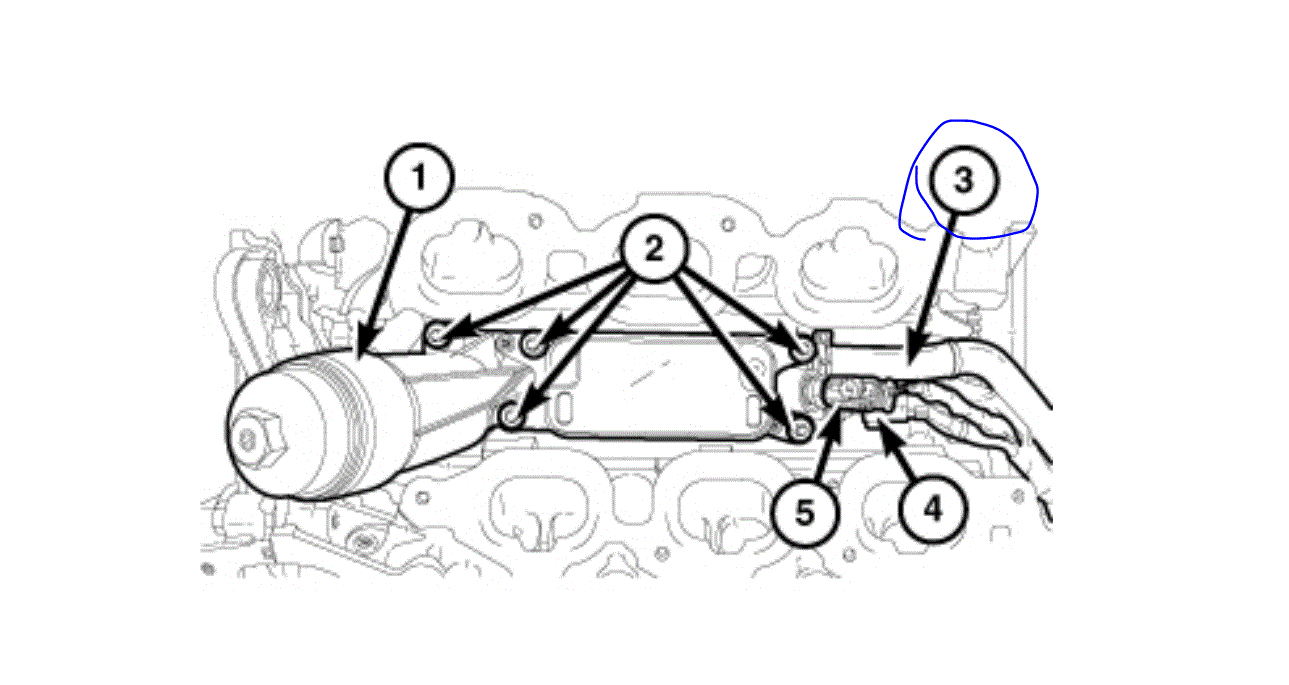

Naser,

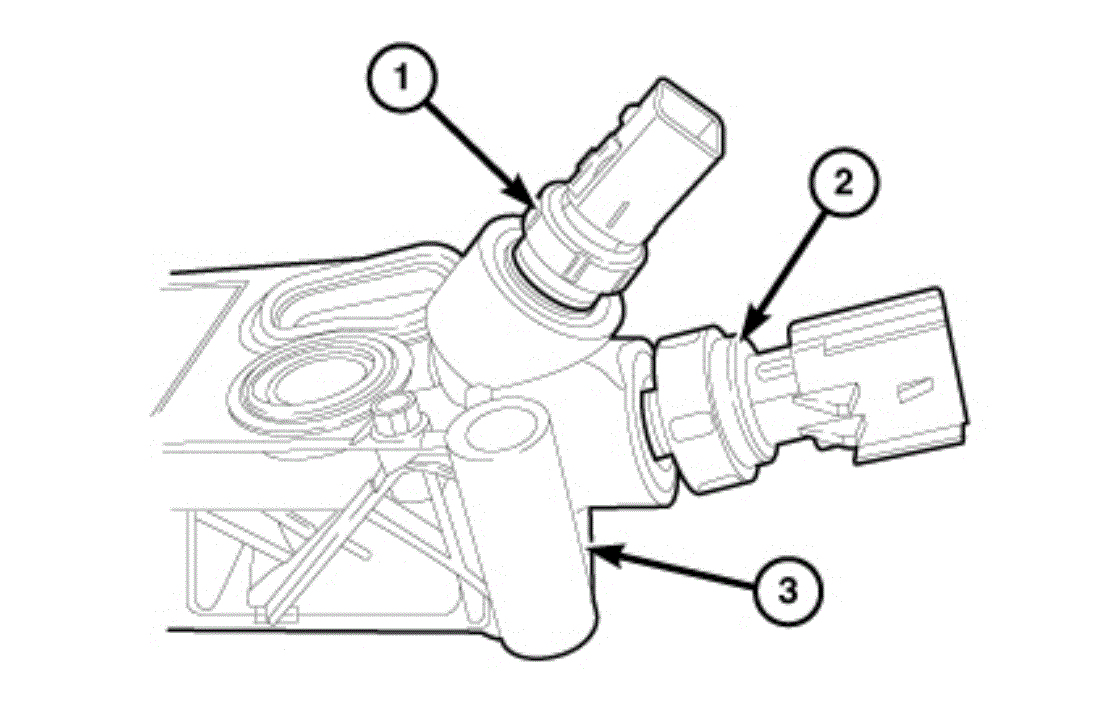

I was thinking. If it isn't a hose, check to see if it is coming from under the intake. No coolant runs through the intake manifold, but the oil cooler (which is part of the oil filter housing) can also leak coolant. I attached a pic of what I'm referring to (pic 1). Number 3 in the pic is a heater hose attached to the assembly. I bet that is where it is leaking. The plastic will crack and leak coolant. Here is the part number.
MOPAR 5184294AE
Let me know. And yes, you have to remove the intake manifold. Recommend to the customer that they also replace the oil pressure and oil temp sensors. They commonly go bad and will then leak oil and set codes. The next thing will be oil leaking down on the bell housing. LOL (see pic 2)

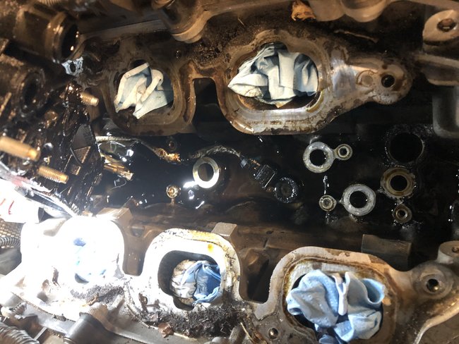

NASER NASER
  • 836 POSTS
Wow, you can't see a thing on this motor, hoses or nothing, even from bottom. But when i put in water it comes from top of transmission so either hoses or intake, got to remove intake, it's real tight. Or remove the windshield wipers trim/cowl?
Sep 7, 2020 at 6:40 AM
NASER NASER
  • 836 POSTS
Found it. As suspected. This is similar to BMW x5 valley pan.

NASER NASER
  • 836 POSTS
Forgot to add the picture.
Sep 7, 2020 at 1:29 PM
  • 110,244 POSTS
Ugh! What a mess. LOL So it was the cooler. At least that is what it looks like has been removed.

NASER NASER
  • 836 POSTS
No, i removed it 3 hours ago. Yes, looks like the cooler, as soon as i pit in some water in the radiator it seeps from there. Ordered one should be in Wednesday. Never done these before, not bad except it's tight around intake brackets. Still got to remove valve cover and see which lifters making the noise, ugh. Done it few times on Grand Caravans and Town and Country, hopefully this is not much more complicated.

I don't think you ever sleep. As far as the cooler, just make sure everything is clean and dry. Make sure to replace the o-rings as well. The sensors are up to you, but the customer may appreciate the idea so he doesn't have labor again in a month. LOL
