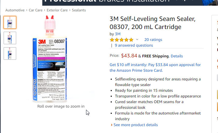

If it is the cowl area how do I go about fixing the issue?
Thursday, March 26th, 2020 AT 2:00 PM
If you can narrow down the area, then use this product that I attached. Clearly you don't want to just go wild with this because it is not that cheap. However, if you can water test the area and then start using more directed or target methods to find the area that the leak is entering the vehicle, this will work. If the area that the leak is coming in is not reachable with your hand, just attach a clear plastic hose to the end of the tube supplied with the kit and apply this sealer as close as possible to the entry spot.
It will flow into the crack/opening and seal it. This will prevent you from having to take the body completely apart to try and reach it.
Let me know if this makes sense or not and I can try to find a video if needed.
