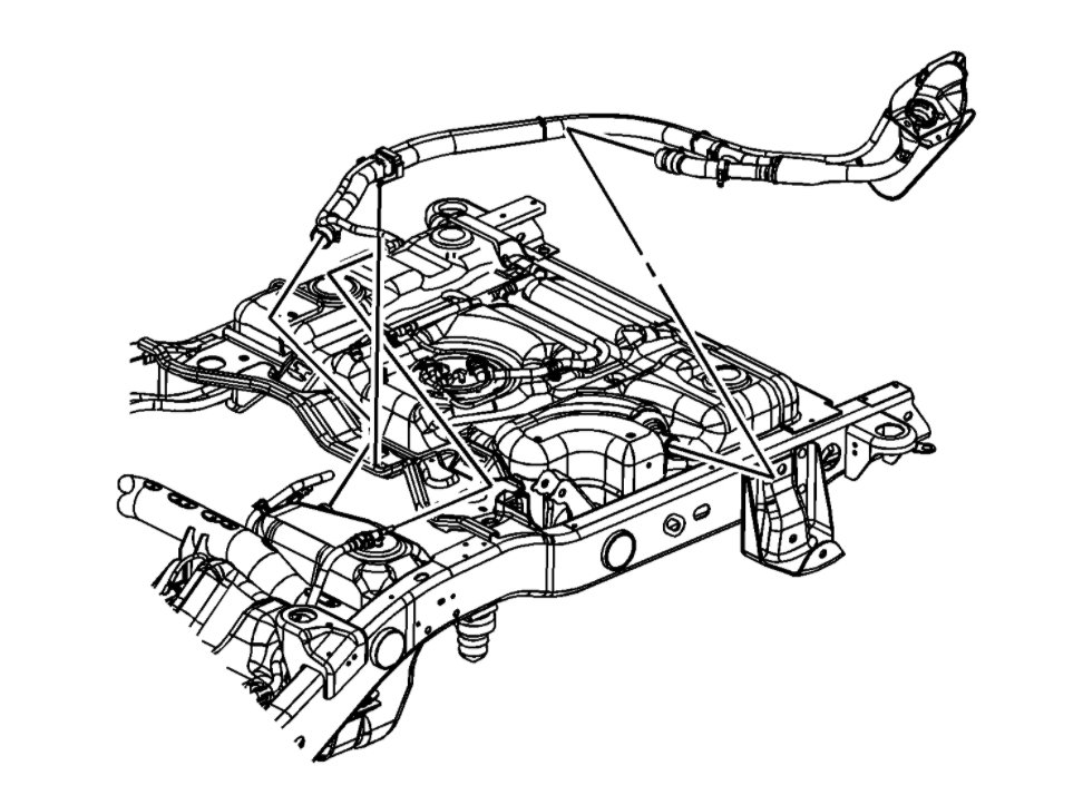

I jump started my car and let it sit running, it shut off and wont start. I think there is a lot of water in my gas tank, but I had already had it started and idling. what do I do?

Good morning,
If you have water in the tank, the tank needs to come down and the flushed out of all the water.
https://www.2carpros.com/articles/how-to-replace-an-electric-fuel-pump
The fuel filter needs to be replaced as well.
https://www.2carpros.com/articles/how-to-change-a-fuel-filter
How did the water get into the tank?

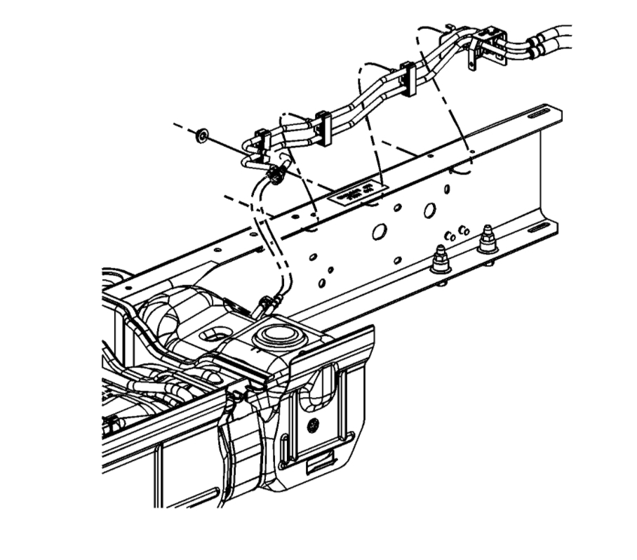

FUEL TANK REPLACEMENT (DUAL TANKS - FRONT)
REMOVAL PROCEDURE
IMPORTANT: Clean all fuel and evaporative emission (EVAP) line connections and surrounding areas prior to disconnecting the lines in order to avoid possible fuel and/or EVAP system contamination.
1. Relieve the fuel system pressure. Refer to the Fuel Pressure Relief Procedure.
2. Drain the fuel tank. Refer to Fuel Tank Draining Procedure (Single Tank) Fuel Tank Draining Procedure (5.3L (L59) Engine) Fuel Tank Draining Procedure (Dual Tanks - Front) Fuel Tank Draining Procedure (Dual Tanks - Rear).

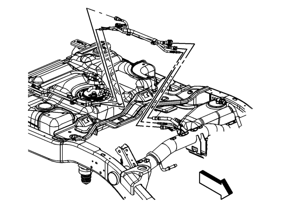

3. Disconnect the evaporative emission (EVAP) vent line from the fuel tank line.
4. Disconnect the vapor line (1) from the fuel tank.
5. Disconnect the fuel feed and EVAP lines from the fuel tank.

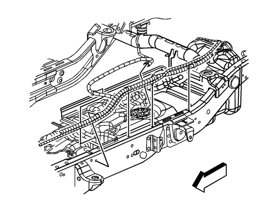

6. Open the clip on the side of the fuel tank retaining the intermediate lines.
7. Disconnect the fuel and EVAP intermediate lines from the front tank.
8. Cap the fuel and EVAP lines in order to prevent possible fuel/EVAP system contamination.

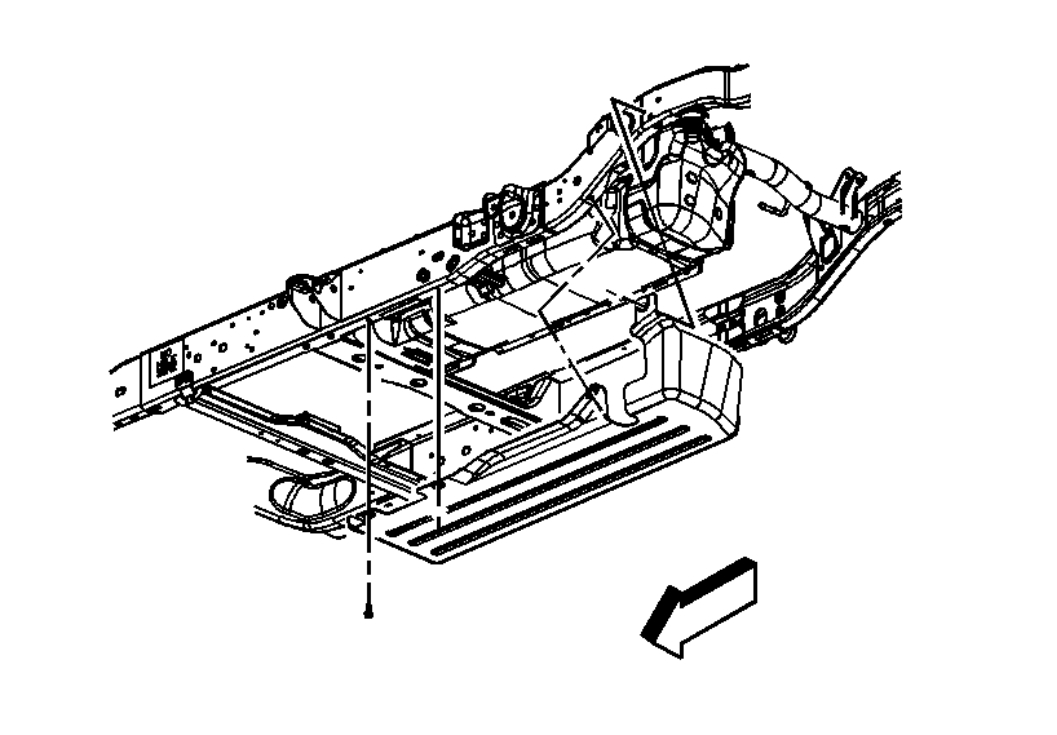

9. If equipped, remove the fuel tank shield bolts.
10. If equipped, remove the fuel tank shield.

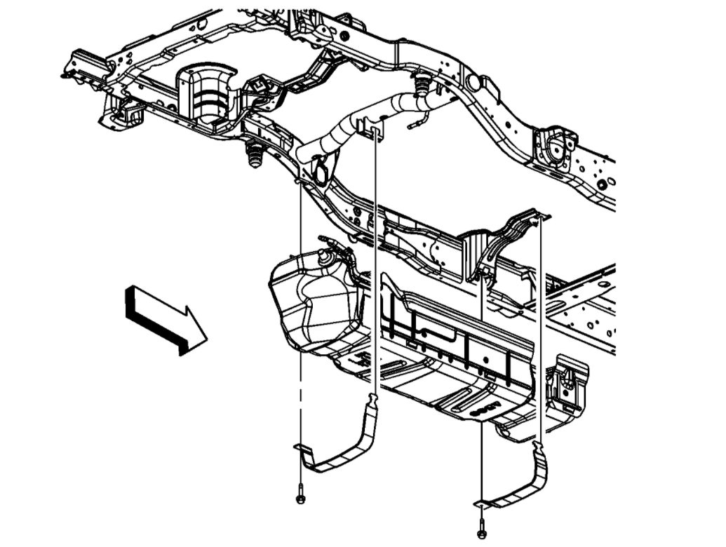

11. Using an adjustable jack, support the fuel tank.
NOTE: Refer to Damage to Fuel Tank Straps Notice in Service Precautions.
12. Remove the fuel tank strap bolts.
13. Remove the fuel tank straps.

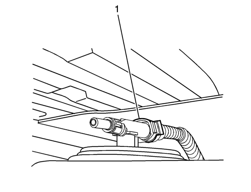

15. Disengage the connector position assurance (CPA) retainer.
16. Disconnect the sending unit electrical connector.
