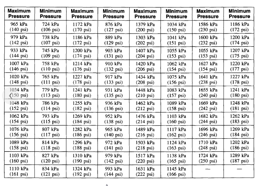

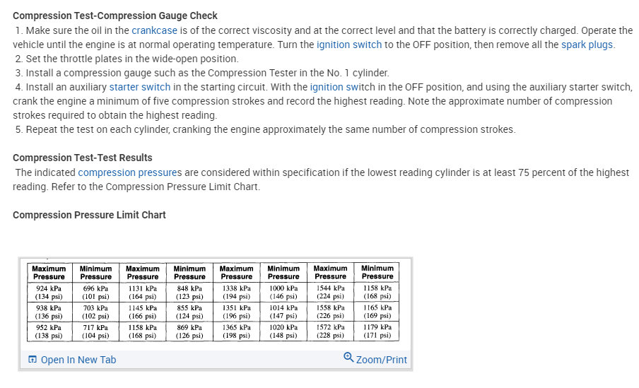

Do you have any smoke from the exhaust? Specifically white smoke?
I suspect you are loosing coolant into the combustion chamber so we need to test compression and go from there or pressure check the cooling system.
