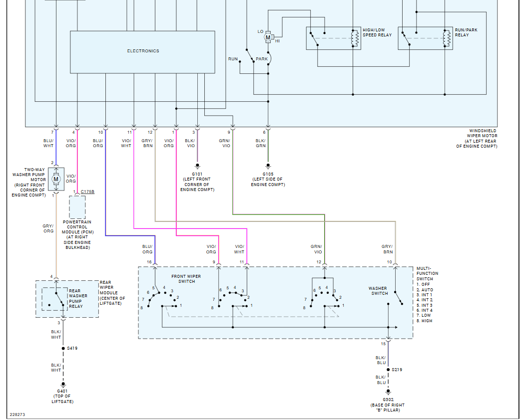

I just replaced the washer pump on my SUV listed above XLT and still have no fluid spraying. I cleared the tubes with compressed air, so I'm thinking it is probably a fuse. However, I'm having trouble finding which fuse the washer pump uses, all diagrams I have found have no label for it. The fuse I thought may have been involved, 37(30A), is working fine. The manual doesn't mention fuses for the washer pump at all. The button you press to start the washer pump still engages the wipers as it should, but the wiper motor does not start. I'm at a loss at this point. Any help would be appreciated.

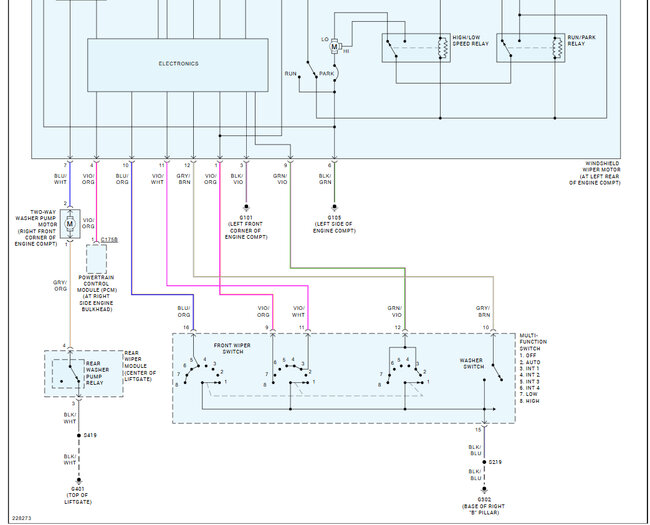

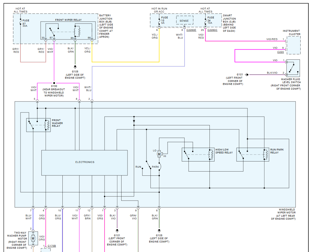

Good afternoon,
The power comes from the wiper motor. The switch on the stalk sends a signal to the motor and then off to the pump.
Do you have a voltmeter to do some checks?
I attached a wiring diagram for you to view and when you are ready, we can do some checks.
+1

  • 52,797 POSTS
Okay, go to the wiper motor. The gray/brown wire should have voltage with the switch commanding washer. Verify that voltage.

Hello, I checked the wires to the wiper motor, there is no Gray/Brown wire in the bundle. Is the diagram for a 2006 Ford Explorer XLT?
Tuesday, November 12th, 2019 AT 4:10 PM
  • 52,797 POSTS
Yes, it is.
It is located t pin 12 on the wiper motor itself. Clean off the wires as they may have dirt on them from all the years.

Sorry for the late reply, the gray/brown wire has 11 volts when I turn on the key, and the voltage didn't change when I pressed the washer switch.
Saturday, November 16th, 2019 AT 3:54 PM
  • 52,797 POSTS
It should have 0 volts until you push the switch.

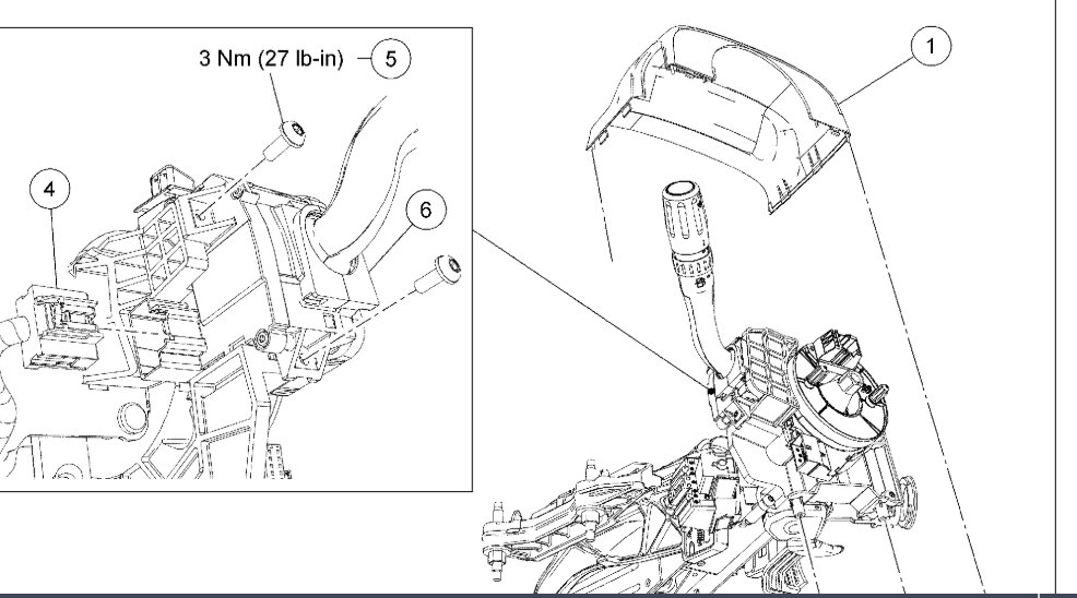

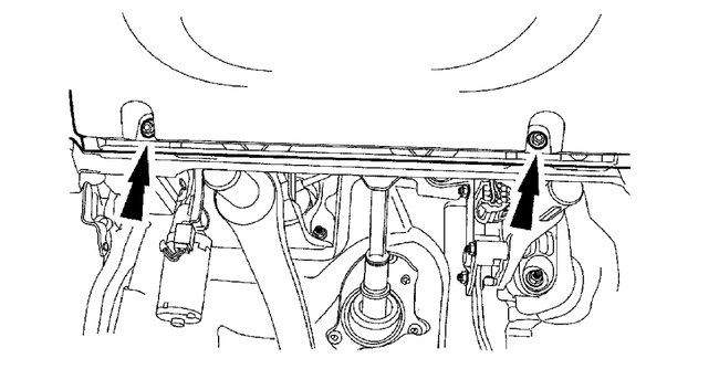

It sounds like you need a multifunction switch. You need to remove a couple screws for the clam shell around the column. Then remove the 2 halfs.
Once you do that, there are 2 screws that hold the switch to the column. Easy removal. There should be 2 wire connectors you have to loosen as well.
Removal and Installation
CAUTION: Do not remove the ignition lock cylinder and the ignition switch at the same time or damage to the column can result.
1. Disconnect the battery ground cable.
ImageOpen In New TabZoom/Print
2. Remove the 2 screws and the steering column opening cover.
3. Remove the 3 screws and the upper and lower steering column shroud.
4. Disconnect the multi-function switch electrical connector.
5. Remove the 2 multi-function switch screws and the multi-function switch.
To install, tighten to 3 Nm (27 inch lbs.).
6. To install, reverse the removal procedure.

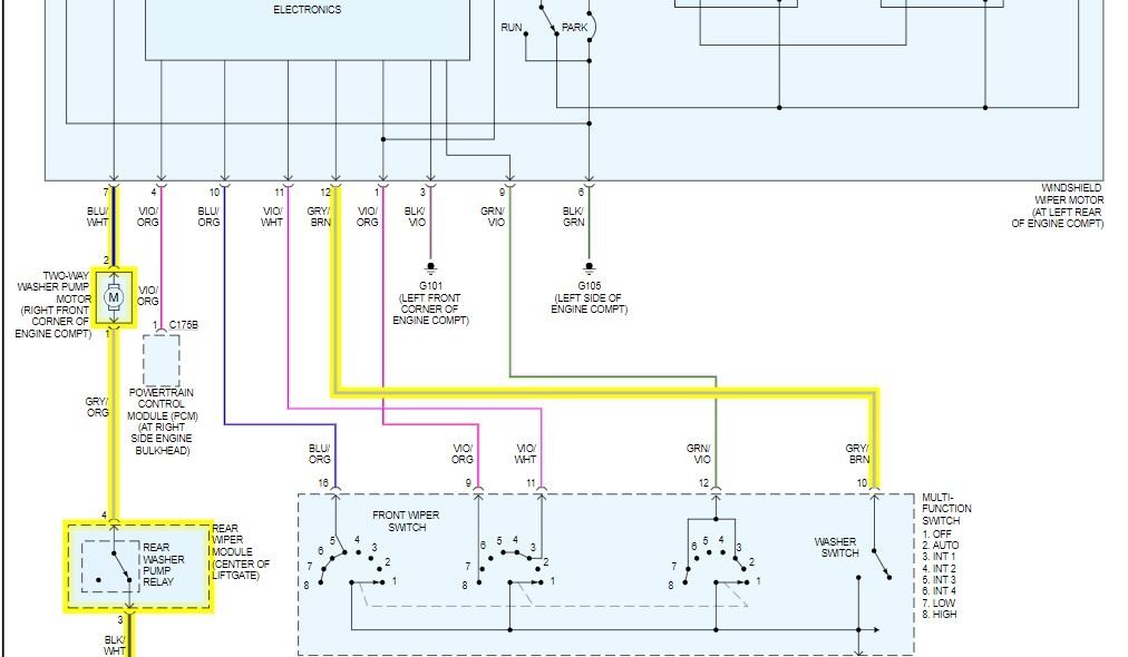

I must be testing the wrong wire then. I think I must have been testing a wire that turned on accessories or something. I'll retest once I have someone who can help me press the switch. I already bought and installed a new multi-function switch two days ago, and the problem persists. Hmm
Sunday, November 17th, 2019 AT 6:46 AM
  • 52,797 POSTS
You need to test the wire I highlighted in the diagram. If it is hot without pressing the switch, the switch is bad, new or not.
Sunday, November 17th, 2019 AT 6:50 AM

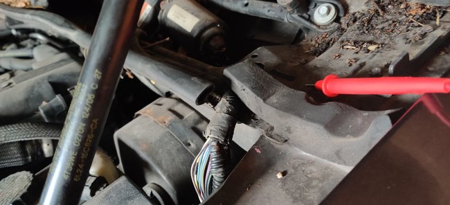

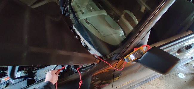

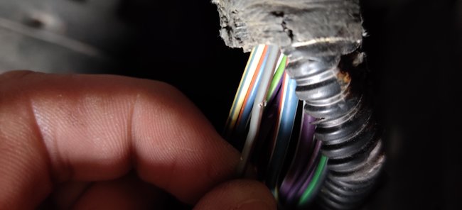

ANDYEHELER
  • 40 POSTS
Can you please confirm this is the wire? I've also included where I'm testing it in relation to the wiper motor.
Sunday, November 17th, 2019 AT 9:32 AM
  • 52,797 POSTS

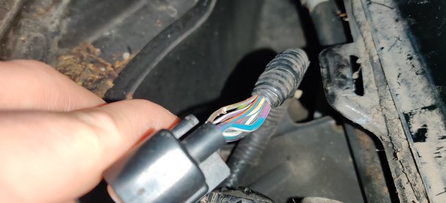

You said you disconnected the plug at the wiper motor. If you did, you check it right there at the connector, not back in the harness.
Sunday, November 17th, 2019 AT 9:38 AM
ANDYEHELER
  • 40 POSTS
I tested at the harness in the first picture. It was 0V and did not change when pressing the wash switch. However, I plugged it in and tested it at the harness as in the second and third pic. It was 10.8V when not pressing the wash switch and 0V when pressing the wash switch. I'm trying to get a video.
Sunday, November 17th, 2019 AT 10:09 AM
  • 52,797 POSTS
Okay, then the switch is a ground.
Hook the connector back up and then test the wire to the pump. Check for voltage when the switch is pressed.

Where would I test that? Is it the blue/white or gray/orange in your diagram? Do I go to the washer pump motor itself to test it or at the wiper motor?
Sunday, November 17th, 2019 AT 10:25 AM
  • 52,797 POSTS
You could go right to the pump or the blue/white wire at the connector. It should have voltage with the switch commanding washers. Do this with the connector connected to the wiper motor.
