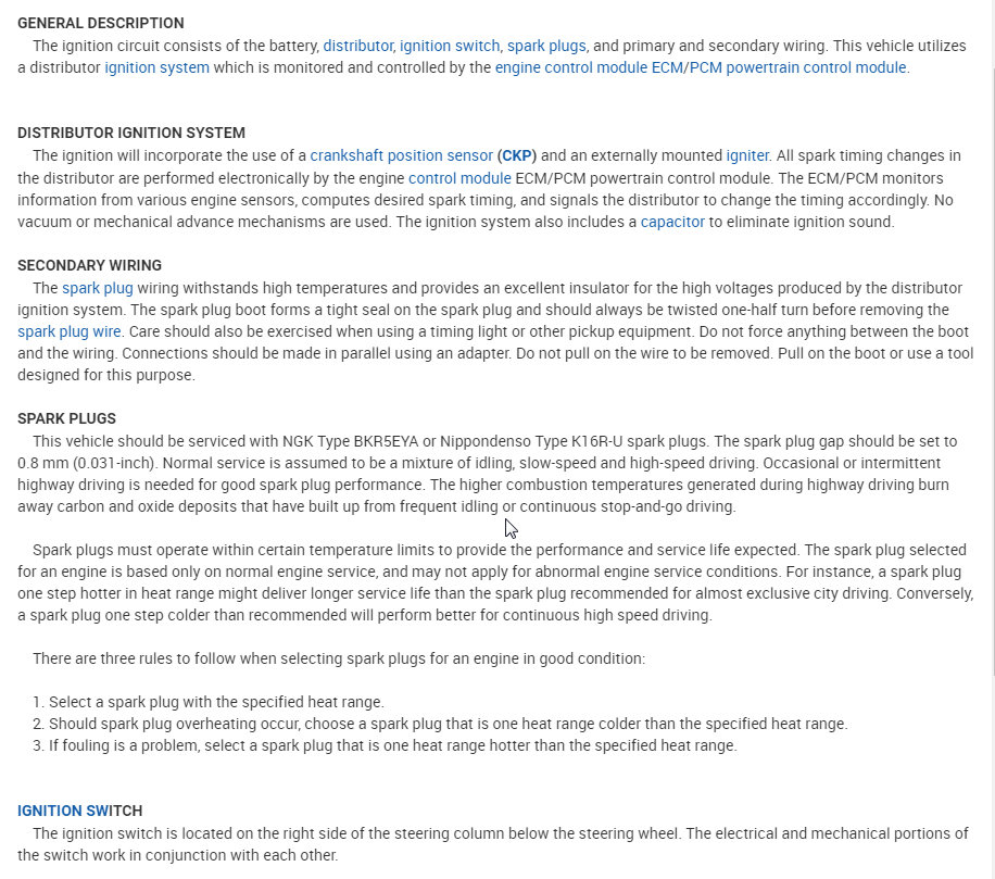

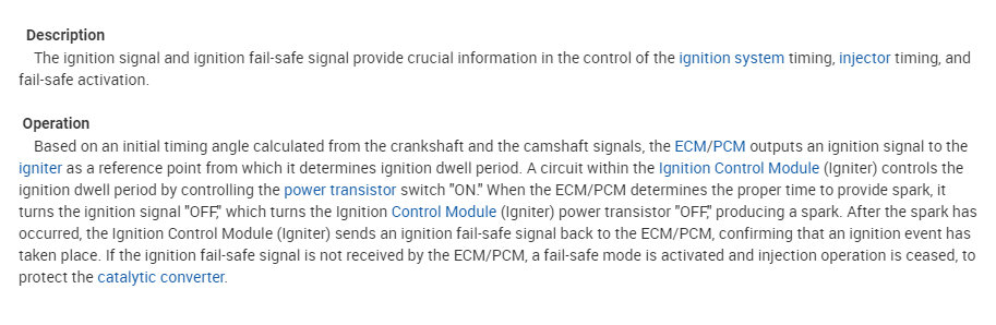

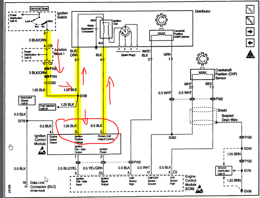

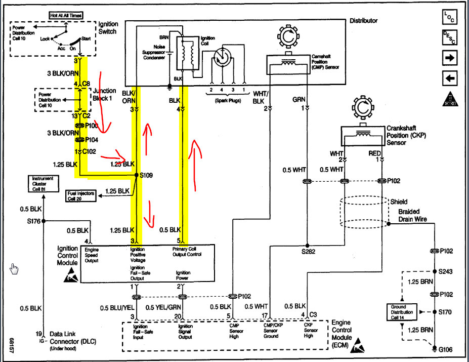

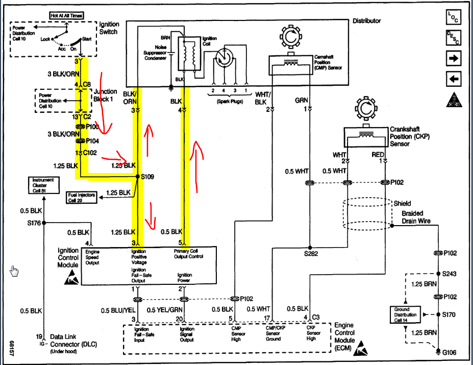

Okay great. So we need to trace the ignition system and see if we have power where we should to determine where we are loosing voltage.
I attached the description so we can follow the voltage through the system. Plus the wiring diagram and I traced the path to see where we don't have power.
Looking at the wiring diagram, when you turn the key, it sends signal to the ignition control module, which sends voltage to the coil on the primary coil circuit. The coil then turns this into high voltage on the secondary side and sends it to the spark plugs. Do we have voltage on the primary side of the coil when cranking? If we do then the control module, ECM, and CKP sensor are all okay.
If we don't then we need to suspect the crank sensor, ECM, or ignition control module.
If we do have power on the primary side of the coil then it is either the igniter or the distributor is the issue.
Let me know what you find with this and we can go from there. Thanks

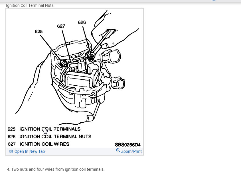

No worries. The coil is inside the distributor. However, just check to see if you have power coming into the ignition control module and going out to the distributor. I circled these two places on the diagram. If you have it coming in from the ignition switch but not coming out then the control module is your issue. If you have it coming out, then I would just go ahead and replace the distributor. You can get a complete distributor pretty cheap these days and it will all be new parts.

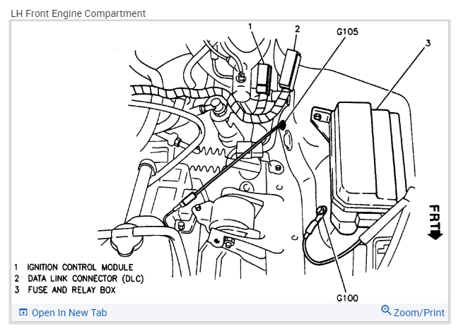

Good evening.. i have no idea of the location of the ignition control module. unless it is the metal thing mounted to the firewall (drivers side). it has one plug with multiple wires going in. the middle wire and one of the outside wires have power when the ignition switch is engaged.

The wires go to a black junction plug mounted below it on the same fender well. Thanks in advance for any help you may continue to offer. I tried a new coil and still no luck.

Okay, so if you have power on two of the wires that could be the issue depending on which outside wire has power. I assume you have power on the engine speed sensor (crank sensor) but if you don't have it on the primary coil output then the control module is the issue.

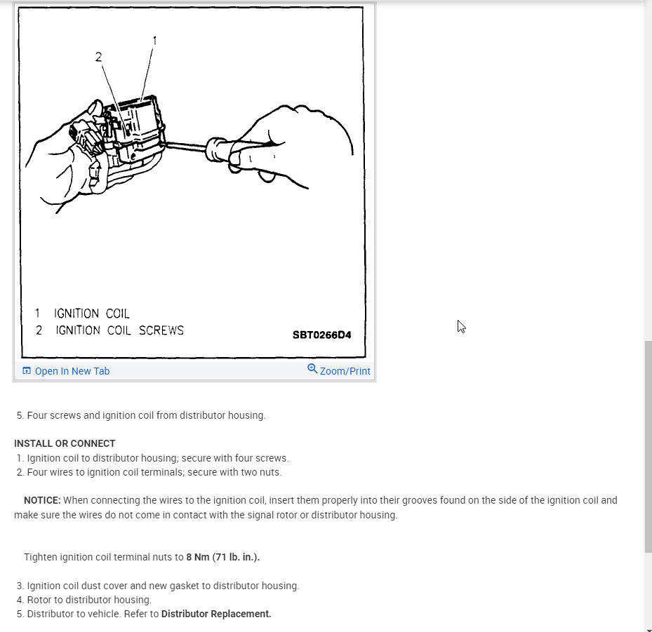

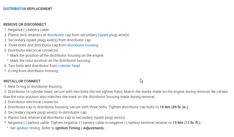

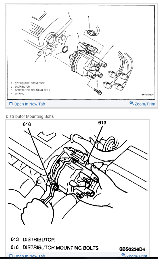

Well, I finally got to check the coil. I used a light tester and I have power at both positive and negative terminals. So I'm guessing the distributor is needing replacing.
Nov 13, 2019 at 10:00 AM

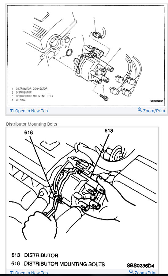

Okay. So if you have voltage going into and coming out of the coil then the next stop is the distributor. This is clearly what delivers it to the plugs so if nothing is coming out, I would replace it. Based on this info, I can't see where you would be wrong.
Nov 13, 2019 at 6:24 PM
APRIL MAPP

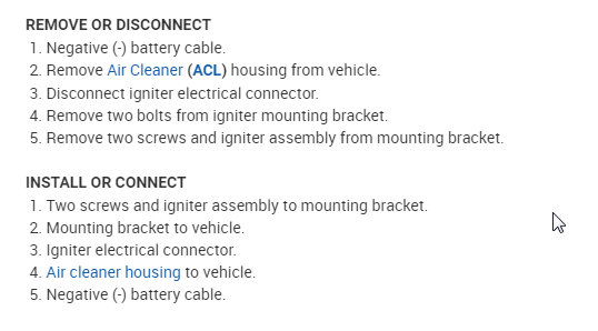

so i have replaced the distributor (new OEM replacement) assembly, new igniter, and new relay(firewall fuse box location). checked to insure that engine was getting plenty of fuel, still no start! Please help me.

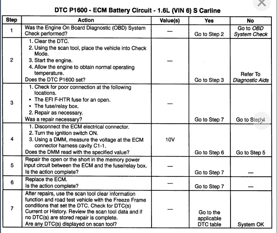

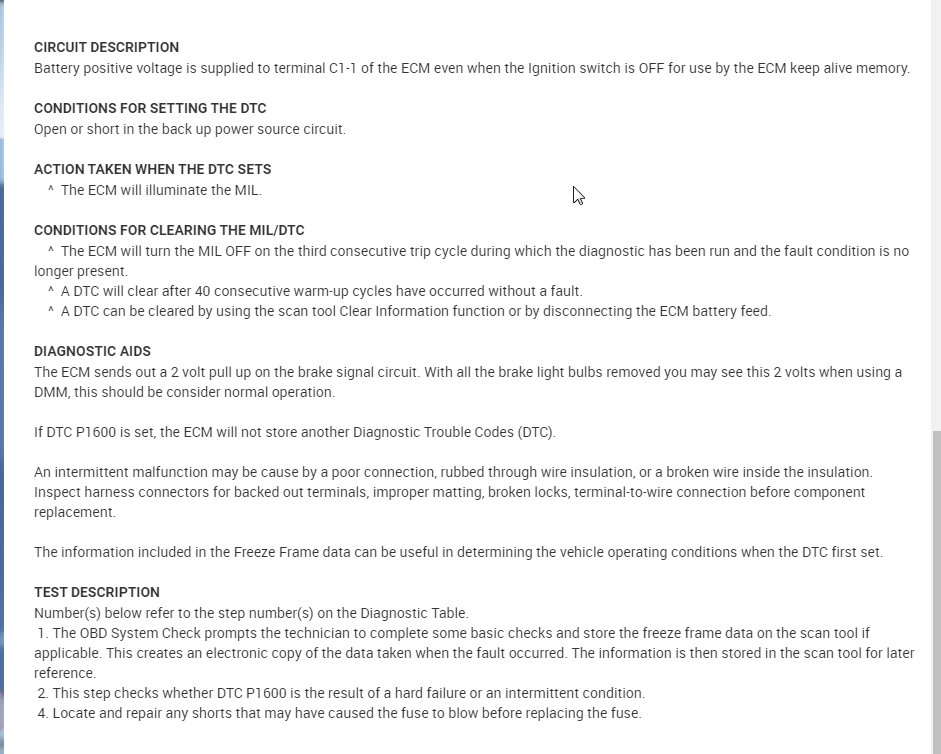

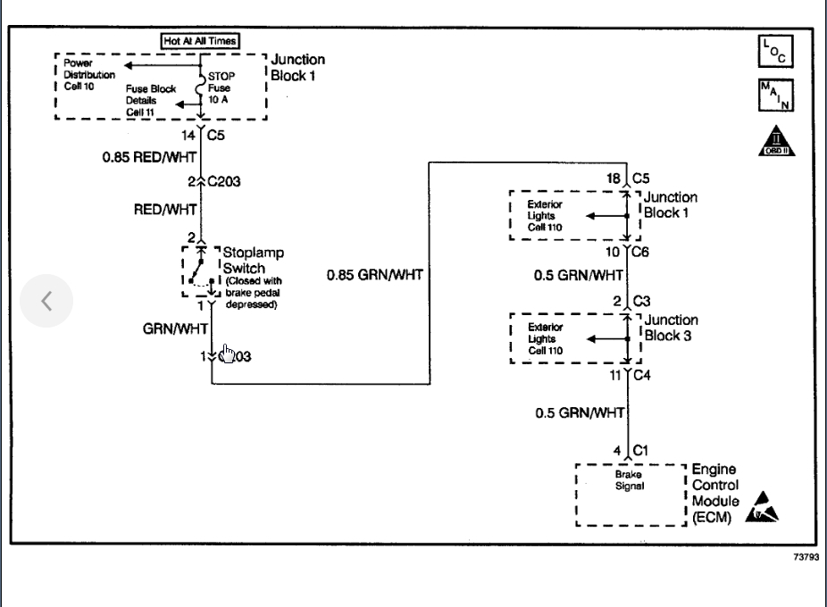

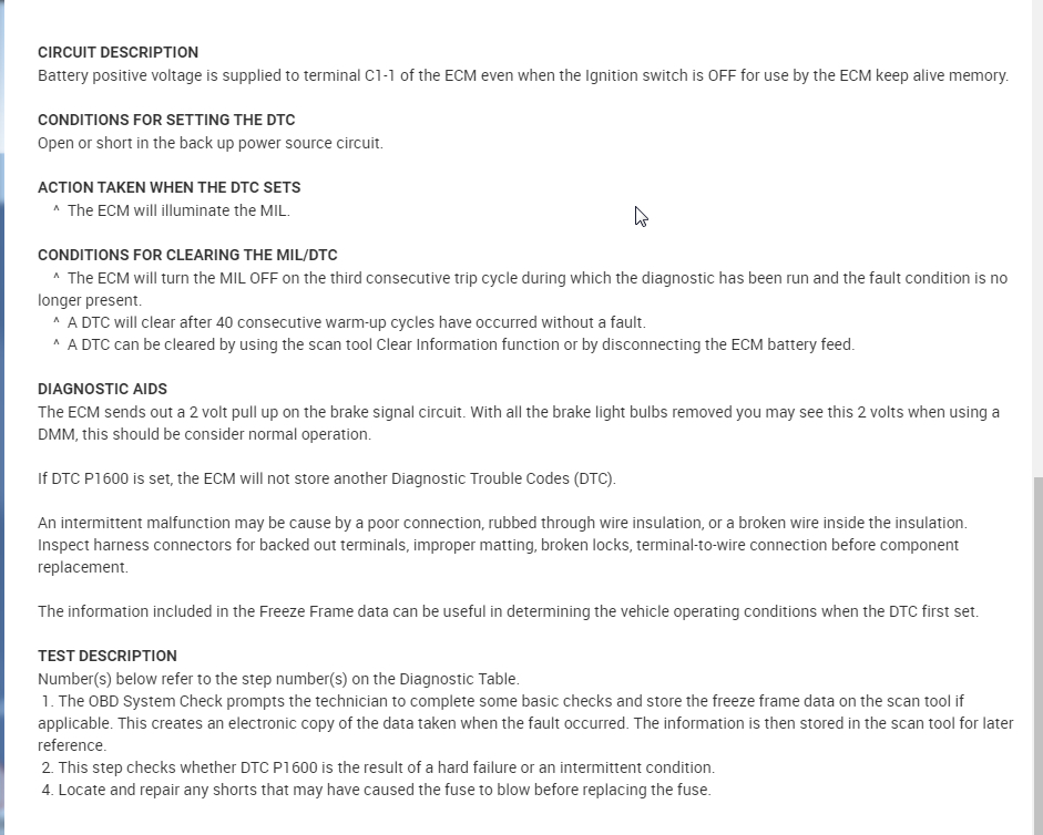

after purchasing a code scanner i checked to obd2 codes (under the dash drivers side). the code i get is p1600. help
Nov 20, 2019 at 4:41 PM
Here is the test for this code. We are going to have to go through it and see what we find.
Nov 20, 2019 at 8:35 PM
