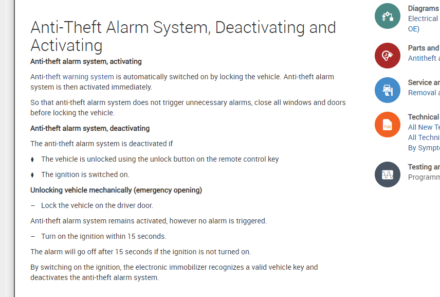

Changed over auto battery improperly and set off alarms, warning lights and no warned to have vehicle taken on flatbed to dealer.
Oct 4, 2021 at 2:01 PM
If the theft system is active, then we need to hook the battery up and disarm it. Here is a guide that will help with this. Clearly hooking the battery up incorrectly made the vehicle think it was being stolen.
https://www.2carpros.com/articles/how-to-reset-a-security-system
So, if we are not able to disarm it using these techniques then it will need a scan tool capable of going in and disarming it.
Please run through this material and let us know what questions you have. Thanks
