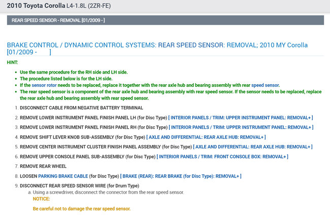

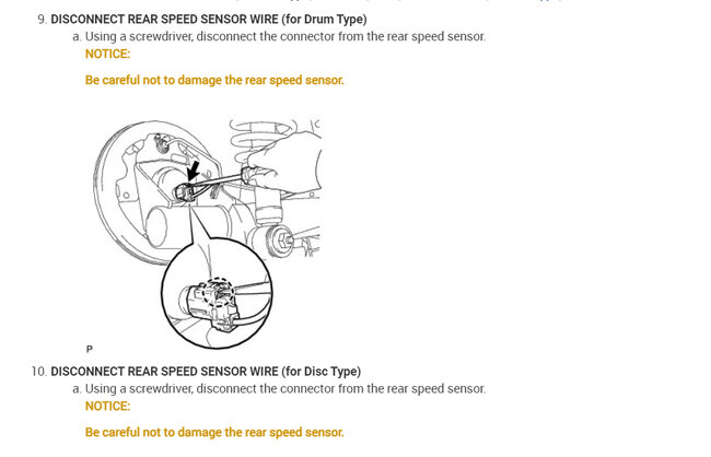

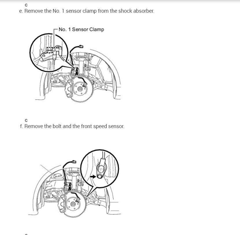

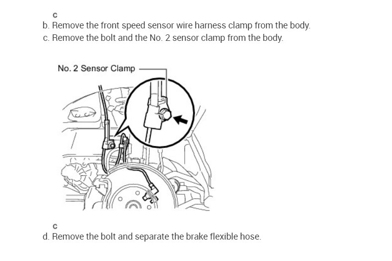

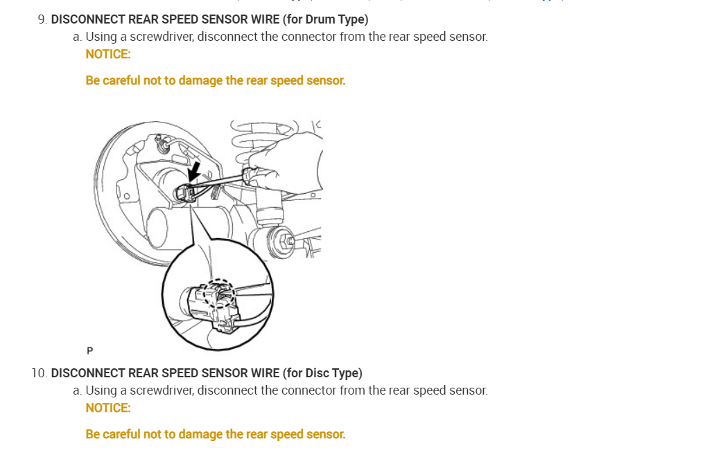

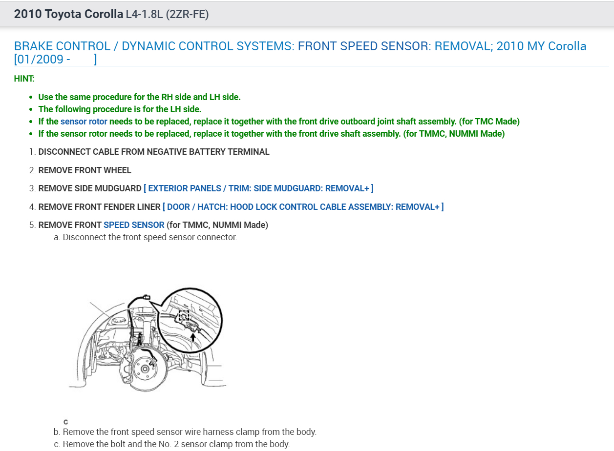

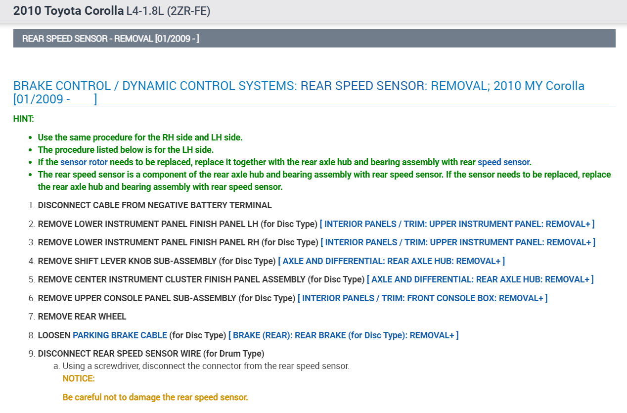

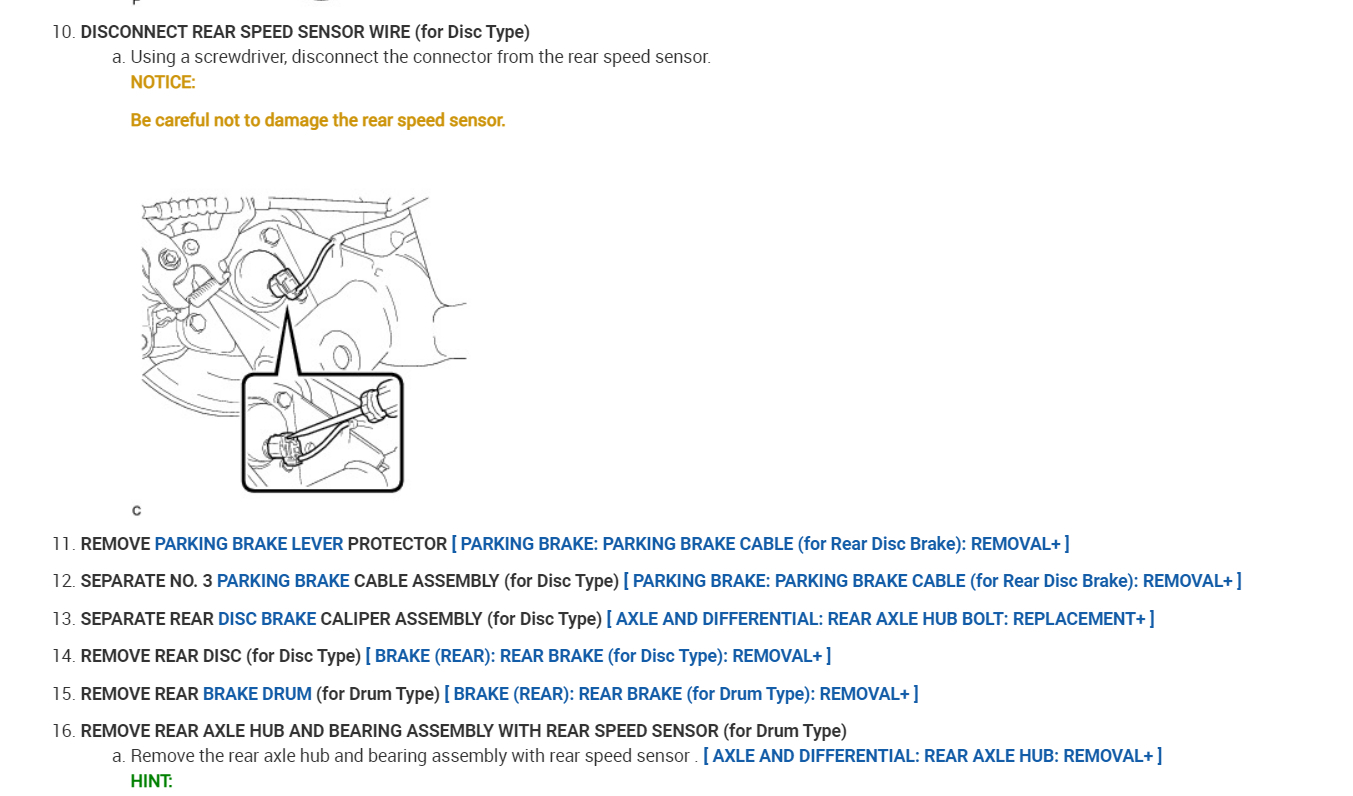

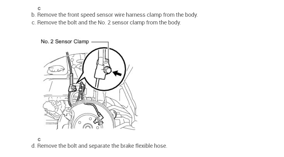

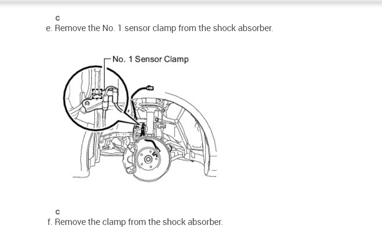

The first thing I would do is check the brake fluid and if low I would check the brake pads, if the fluid level is okay, I would run the codes for the ABS because it sounds like you have a wheel speed sensor that has gone out.
Here is a guide to show you how to get the codes:
https://www.2carpros.com/articles/anti-lock-system-testing-and-repair-abs

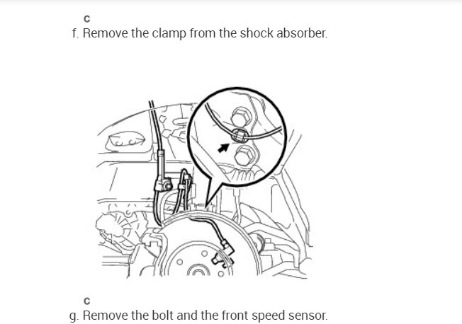

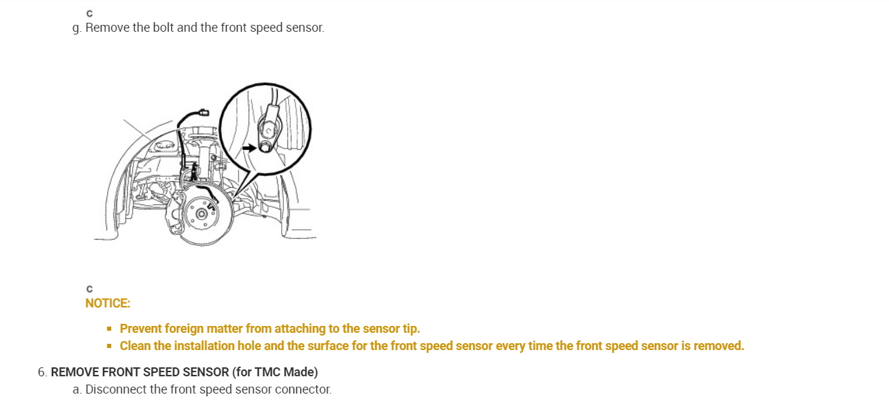

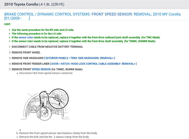

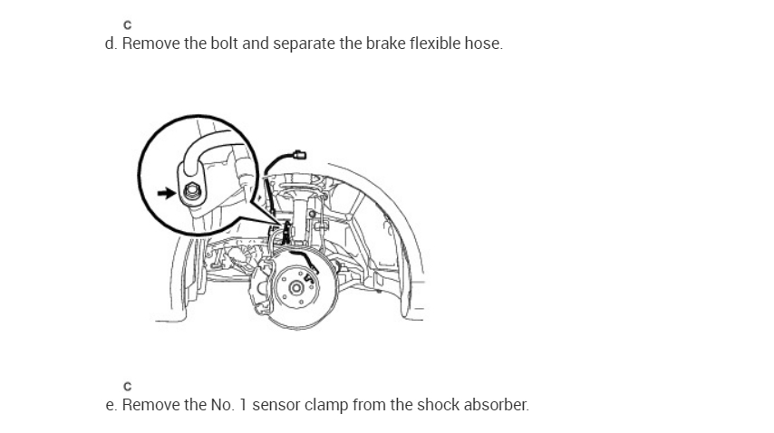

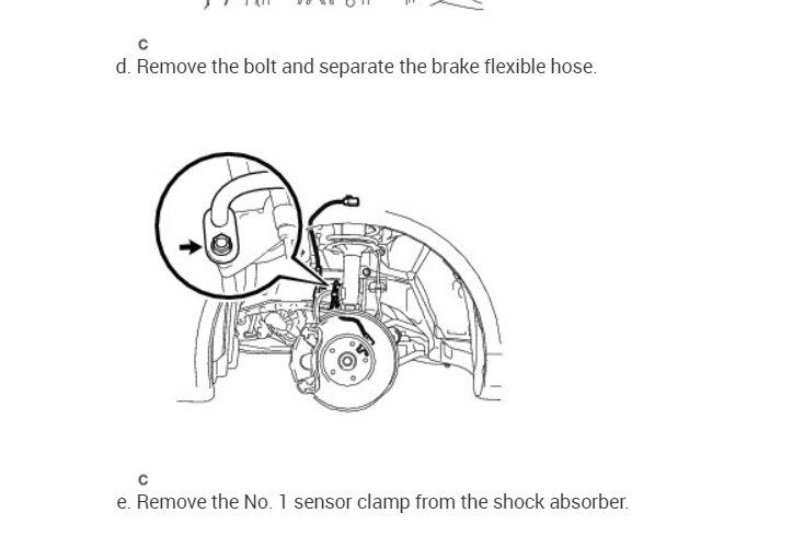

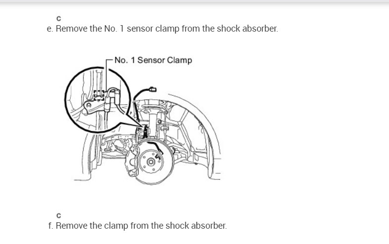

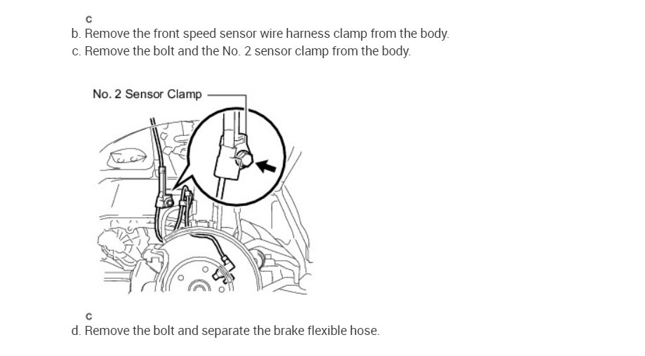

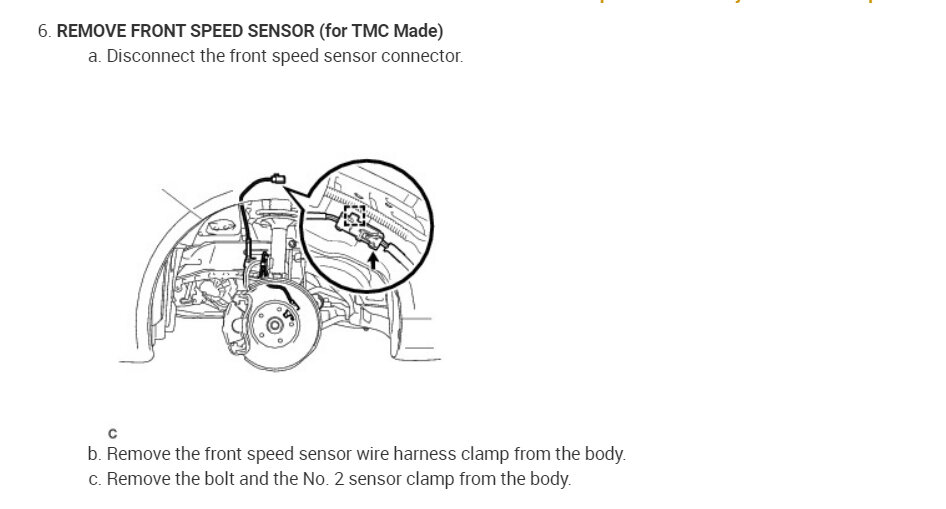

Here is how to change out the ABS wheel sensor in case you need it. Check out the images (below). Please let us know what happens.
