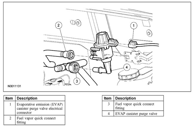

When I start my truck after about a minute a warning chime goes off. Seat belts are on, and the doors are closed. I turn off the ignition and start truck again the warning chime doesn't do it after the second start up.? At first, I thought it was maybe a seatbelt malfunction, so I unplugged them. no good still does it. Engine light on and codes 171 and 174 came up but I wouldn't think that would have anything to do with the warning chime. This has me puzzled.

I haven't been able to find any vacuum leaks under the hood. Is there a vacuum to the fuel tank or transmission under the truck? All my fluids are right where they need to be. I changed the fuel filter 2 years ago. I changed the oil and filter about 6 months ago. And put new brake pads on the front and rear a year ago. I had a plug misfire on the #1 cylinder, so I just replaced all the plugs and ignition coils a year ago. And that was real fun. I only had 2 plugs break. Bought a plug puller for the 5.4. for $125.00. Totally worth it.

There is the EVAP purge line that runs back to the tank, if it was stuck open it might cause lean codes. If you have a scan tool that can read live data you can test the valve without a lot of fuss. You would run the engine and watch the fuel trims. Then you block the EVAP line and see if the fuel trims change to compensate for the lack of air from the leak. If you don't have a scan tool that can do that there are some reasonable ones out there or look at FORScan and the proper dongle. The windows version is as powerful as the OE tool and is much less money.
