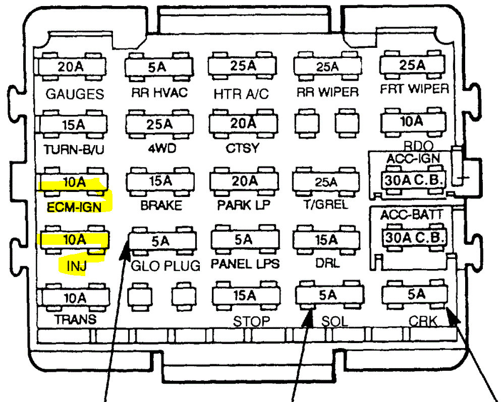

First, have you checked the ign/ECM fuse along with the injector fuse? See pic 1 below and let me know if you checked them. If you did, make sure there is power to them.

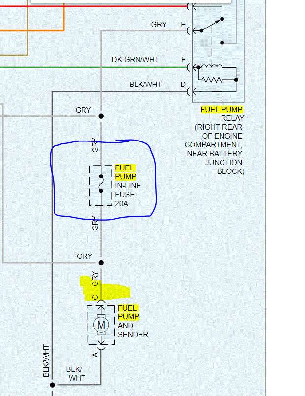

If you have, then I need you to check for power at the gray wire on the pump. Note there is an inline fuse that could be blown. See attached pic. Also, confirm there is power to the orange wire at the fuel pump relay.

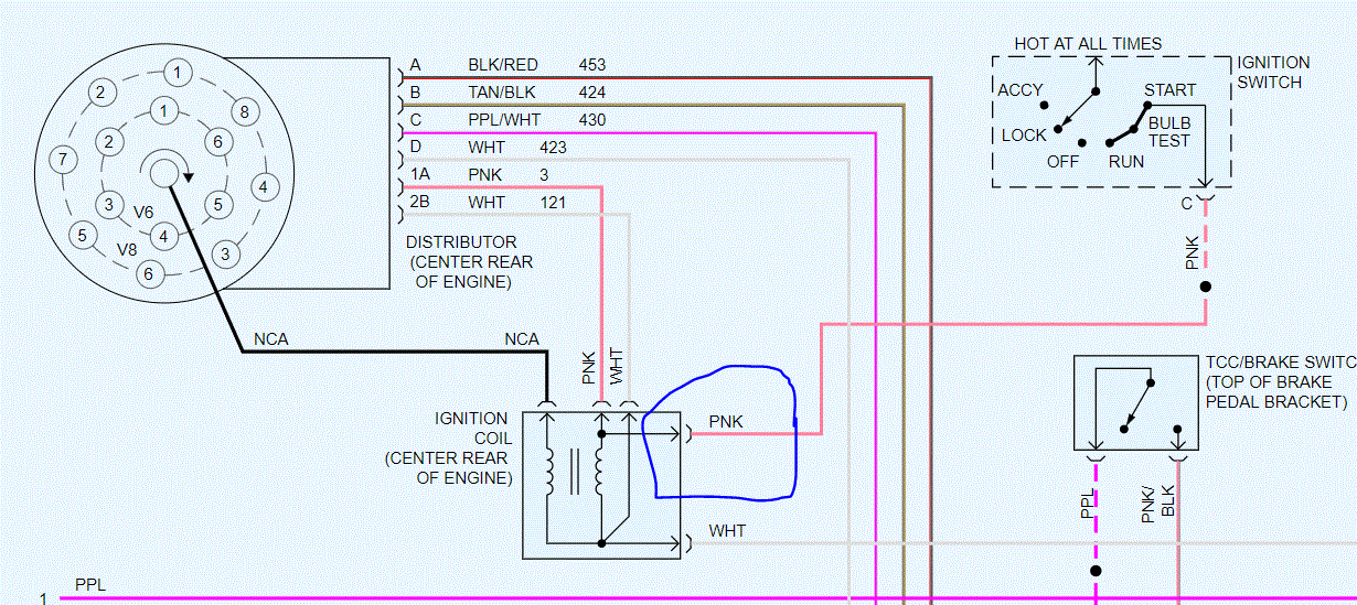

Next, confirm power to the pink wire on the positive side of the coil. It comes from the ignition switch. Check that when cranking. If it is lower than 10.5v, see if the battery is weak. (pic 2)
