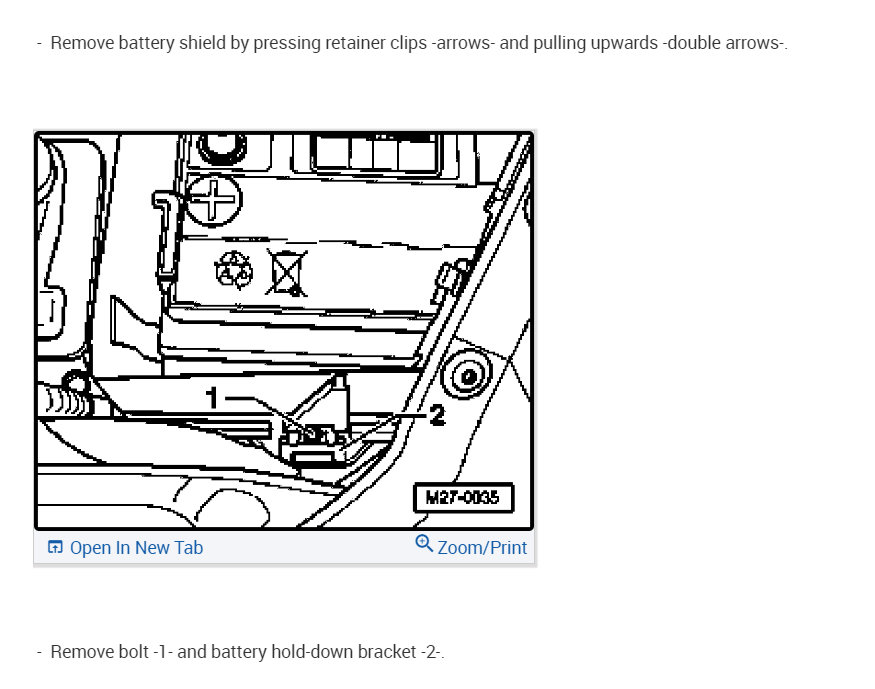

I went to turn on my car this morning and it completely shut down! The first time I turned the key and cranked the engine it sputtered a bit, so I attempted it again. Then it completely shut off. No lights, radio, milage, gas gauge, buttons--nothing.
It doesn't respond to a jump, any buttons on the doors or keys, and while I can turn the key as normal, absolutely nothing happens--not even sound.
I checked all the fuses and they're fine and the battery was replaced (brand new) less than 5 months ago.
Please help!
Jul 6, 2022 at 11:26 AM
  • 55,402 POSTS

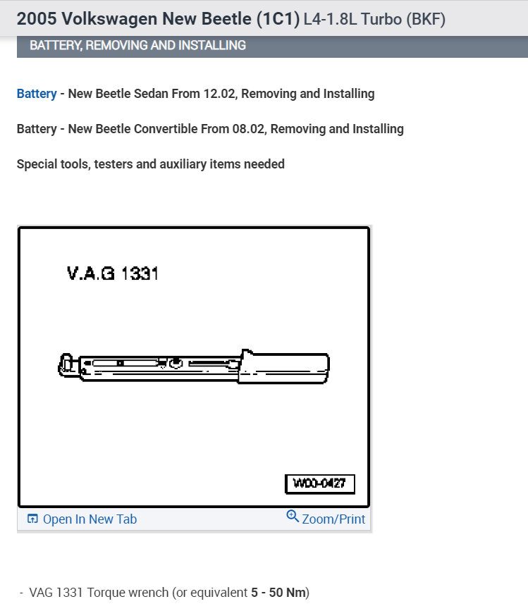

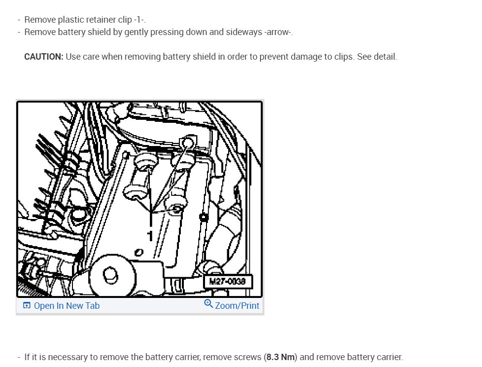

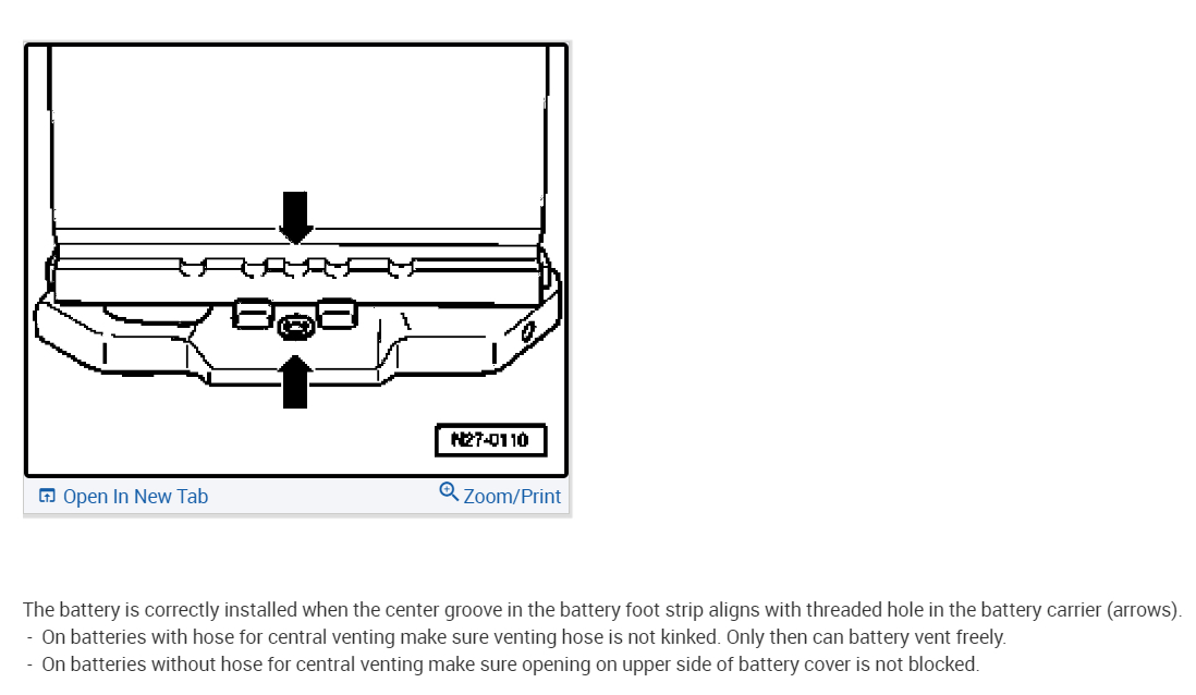

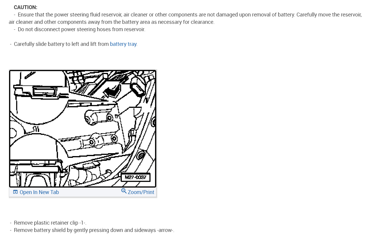

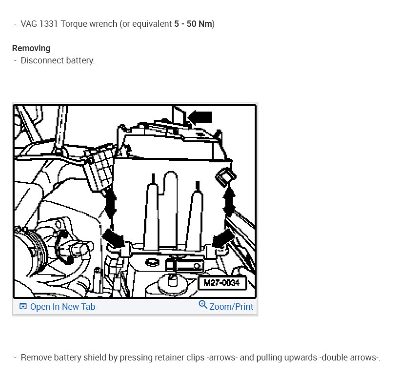

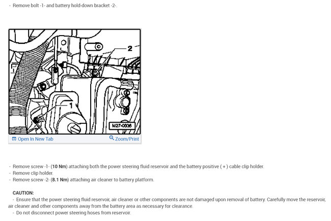

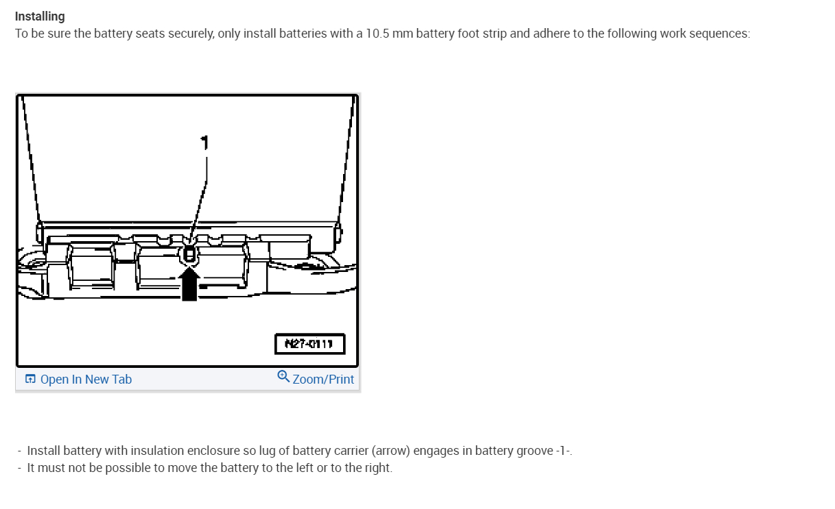

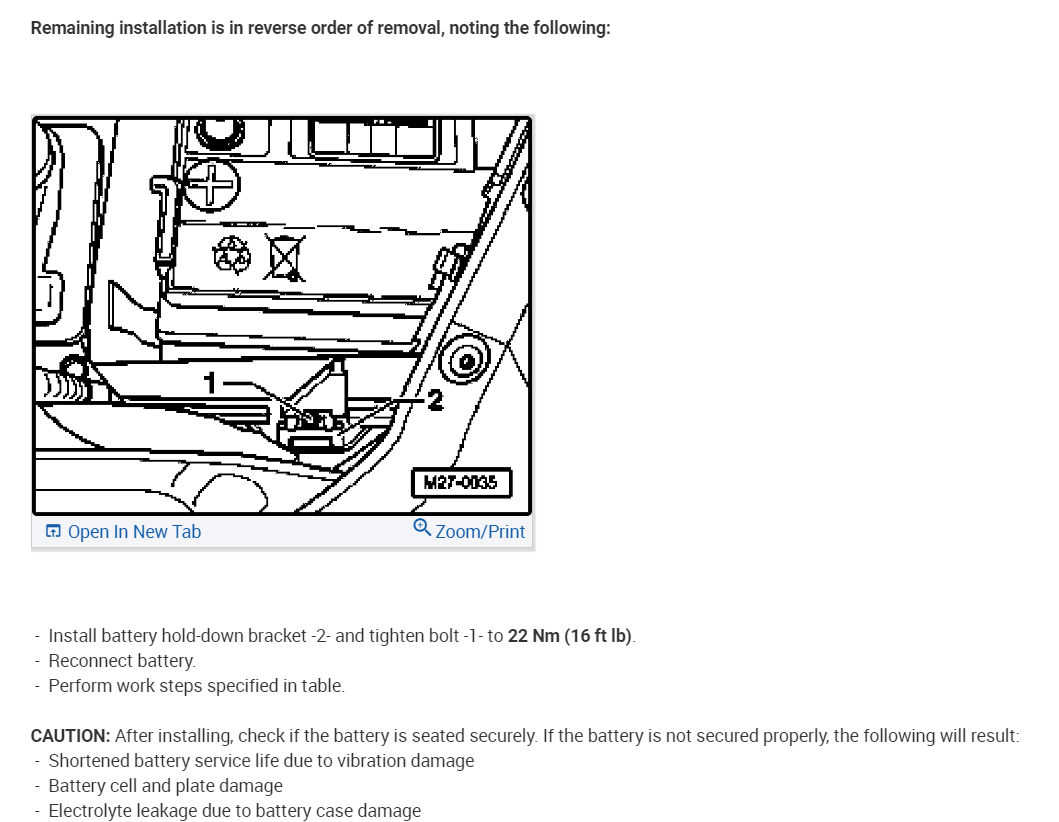

This will be one of two things either the battery shorted out or there is a bad connection at the battery, I would remove the battery and have it tested at an auto parts store and then clean the battery cables. There is an outside chance a main fusible link has blown but I would do the first two steps. Here are two guides that can help with instructions below for your car:
and
https://www.2carpros.com/articles/how-to-replace-a-car-battery
