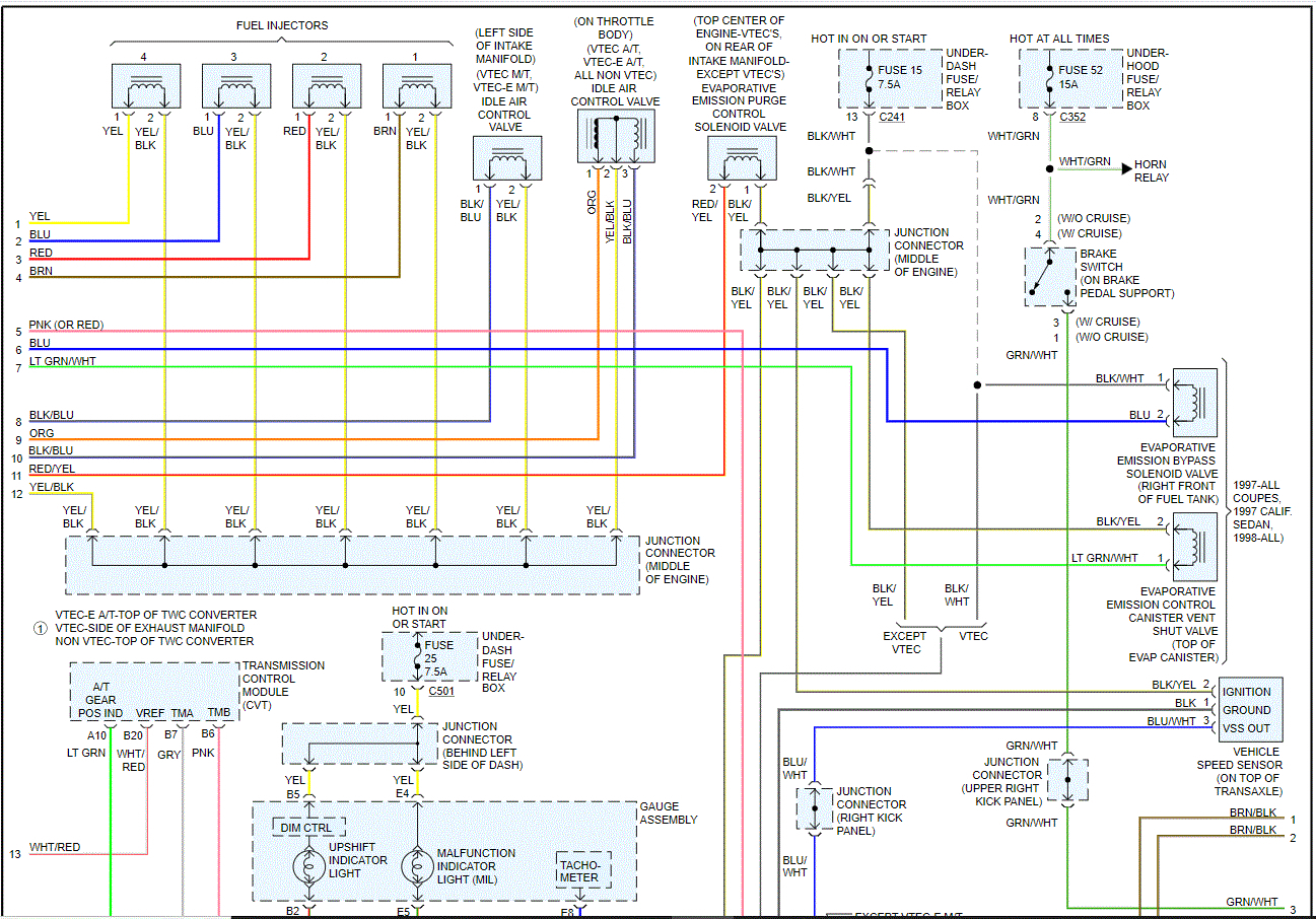

VTEC solenoid wiring diagram needed
1998 HONDA CIVIC
161,000 MILES • 1.6L • 4 CYL • 2WD • MANUAL
MINIWIKID

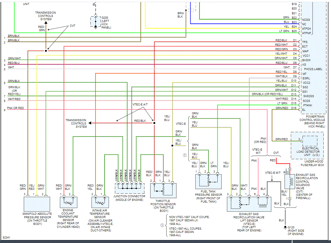

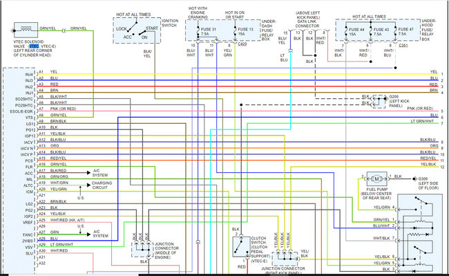

So the vehicle I just bought has the wires that go to the VTEC solenoid cut and I don't know what wires went there. like; what color they were. if I could get an engine wiring diagram for my vehicle that would help a lot and if it’s needed the motor is a d16y5 1.6 vtec-e 4 cylinder out of the car listed above hx. it is a manual but it has running like garbage because the VTEC solenoid isn’t wired up.

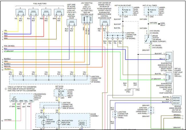

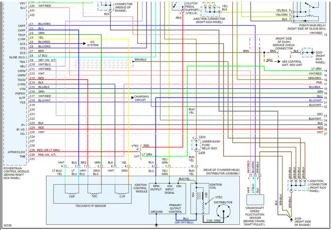

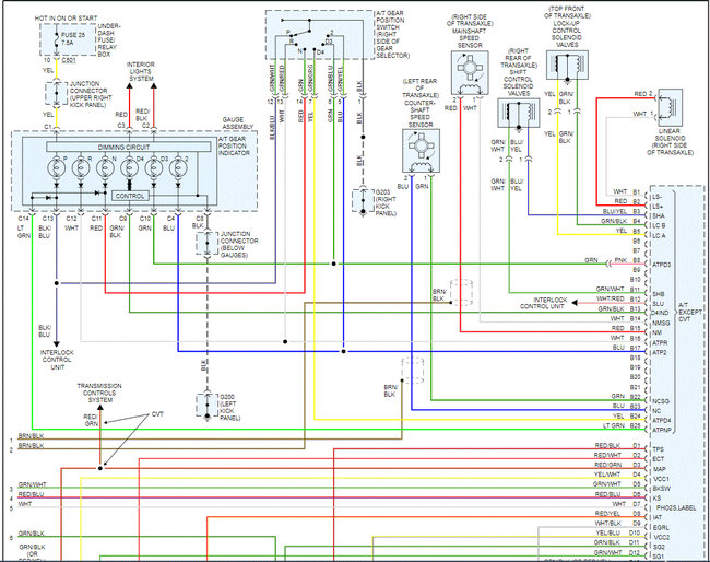

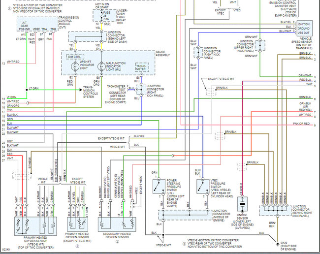

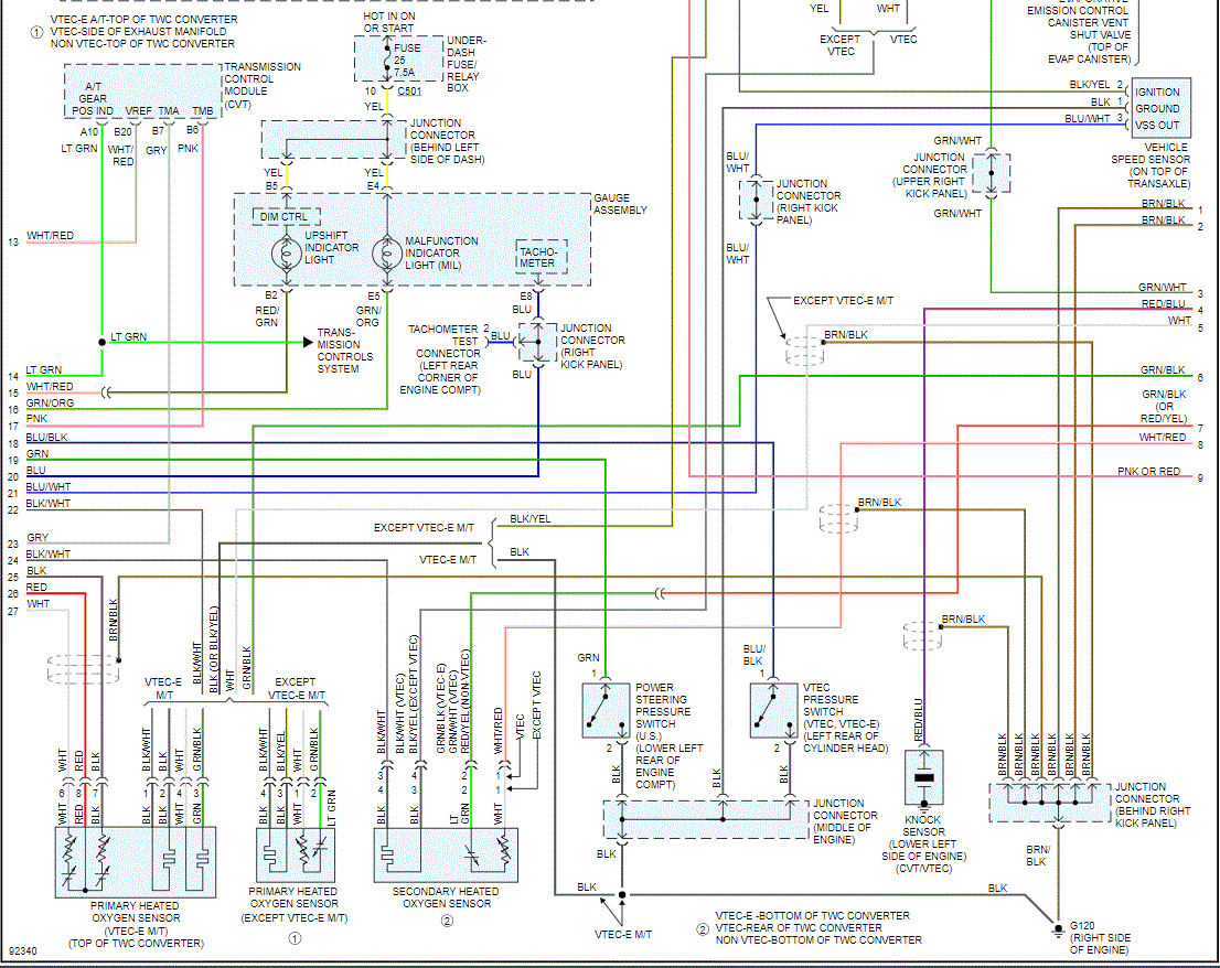

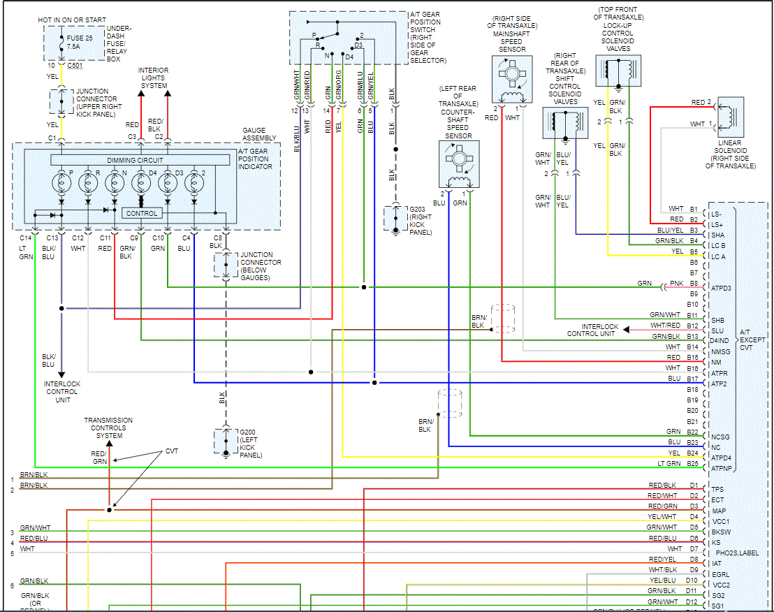

I attached the wiring schematics below for the entire powertrain management system. The wire colors are indicated. In the first pic, you will find the VTEC solenoid on the top left of the picture.
The schematics were 3 pages long, but I had to cut them in half to make them readable for you. I did overlap them so you can follow from one to the next.
Here is a link you may find helpful as well:
Let me know if this helps, if you have other questions, or if there is something I can do to help.
