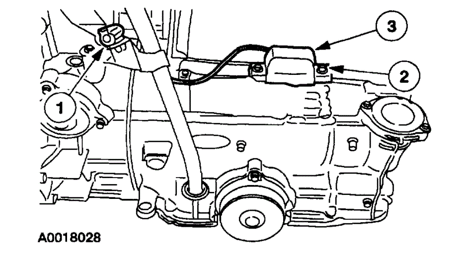

Where is the VSS located exactly?

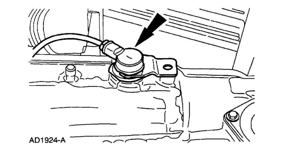

Good morning,
I attached pictures of the location of the speed sensor for you.
What is the issue that leads you to replace this sensor?

JAMES904
With the pictures you provided is that under the transmission?
