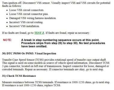

1999 Ford Taurus speed sensor shifting erratically
1999 FORD TAURUS
197,000 MILES • 6 CYL • FWD • AUTOMATIC
FIREMAN6
  • 10 POSTS
I bought the car and the front pump seal went out so had it and the torque converter replaced then on the test drive the speed sensor went out the guy put in used one, and it worked for a little bit then it went out. I put in new speed sensor and run ok for a little bit the she speedometer started jumping again around an the car would shift into low gear you can shut it off and it would work for a little while. So I replaced the pig tail connector on that speed sensor still the same problem. so i replaced the other speed sensor on the driver side of the car the car run good I drove it 50 miles without any problems the next morning the speedometer was jumping around again. So I rewired the there speed sensor on the back side of the motor that I put the new pig tail i did this due to the wires being so brittle. still the same problem. So thinking I may have got bad vehicle speed sensor I got another one and still the same problem speedometer jumping around and shifting erratically.

Hi fireman6,
Thank you for the donation.
Erratic shifting points to a fault in the VSS as it supplies signals to the PCM.
There are different models with different transmission installed and I would need to know what is the engine and transmission model code to get the correct data.

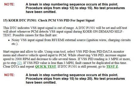

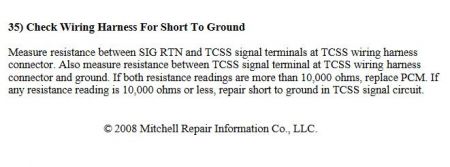

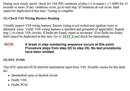

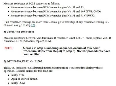

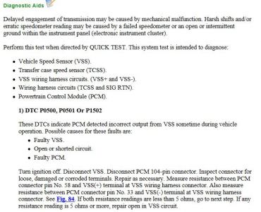

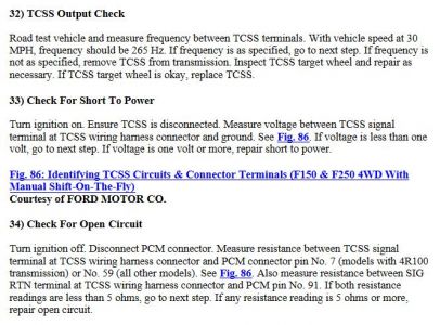

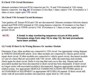

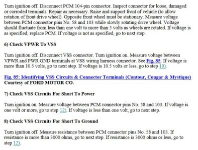

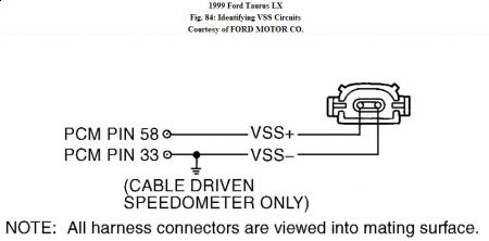

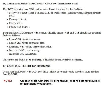

For the speedometer and trans to act funny, there should be DTC stored. Here are the diagnostic procedures. NOTE: After each service or repair procedure has been completed, reconnect all components. Clear DTCs and perform OBD-II Drive Cycle. After drive cycle is complete, repeat QUICK TEST procedures to ensure all EEC-V systems are working properly and DTCs are no longer present.
https://images.2carpros.com/forum/automotive_pictures/192750_DTCP0500_99Taurus01_1.jpg
https://images.2carpros.com/forum/automotive_pictures/192750_VSS99Taurus_1.jpg
https://images.2carpros.com/forum/automotive_pictures/192750_DTCP0500_99Taurus02_1.jpg
https://images.2carpros.com/forum/automotive_pictures/192750_DTCP0500_99Taurus03_1.jpg
https://images.2carpros.com/forum/automotive_pictures/192750_DTCP0500_99Taurus04_1.jpg
https://images.2carpros.com/forum/automotive_pictures/192750_DTCP0500_99Taurus05_1.jpg
https://images.2carpros.com/forum/automotive_pictures/192750_DTCP0500_99Taurus06_1.jpg
https://images.2carpros.com/forum/automotive_pictures/192750_DTCP0500_99Taurus07_1.jpg
https://images.2carpros.com/forum/automotive_pictures/192750_DTCP0500_99Taurus08_1.jpg
https://images.2carpros.com/forum/automotive_pictures/192750_DTCP0500_99Taurus09_1.jpg
https://images.2carpros.com/forum/automotive_pictures/192750_DTCP0500_99Taurus10_1.jpg
