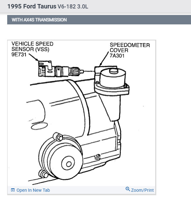

My speedometer was going crazy. The Ford dealership said it was the Vehicle Speed Sensor and Speed Sensor Gear. Is this two different parts or all-in-one piece? Can someone give steps on how to change this? Thanks...

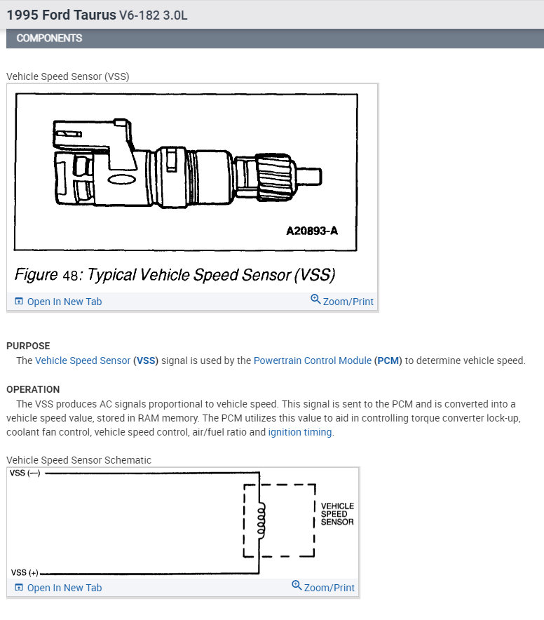

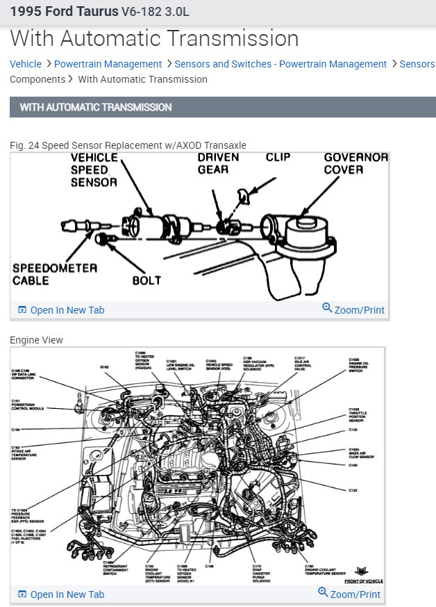

The vehicle speed sensor (VSS) is located on the transmission housing (see diagram below).

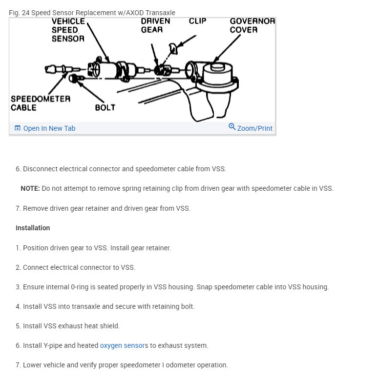

The VSS consists of a built-in gear, comes as a unit.
Replacement of the VSS is straight forward. You will have to remove the speedometer cable and the mounting bolt to remove the VSS.
