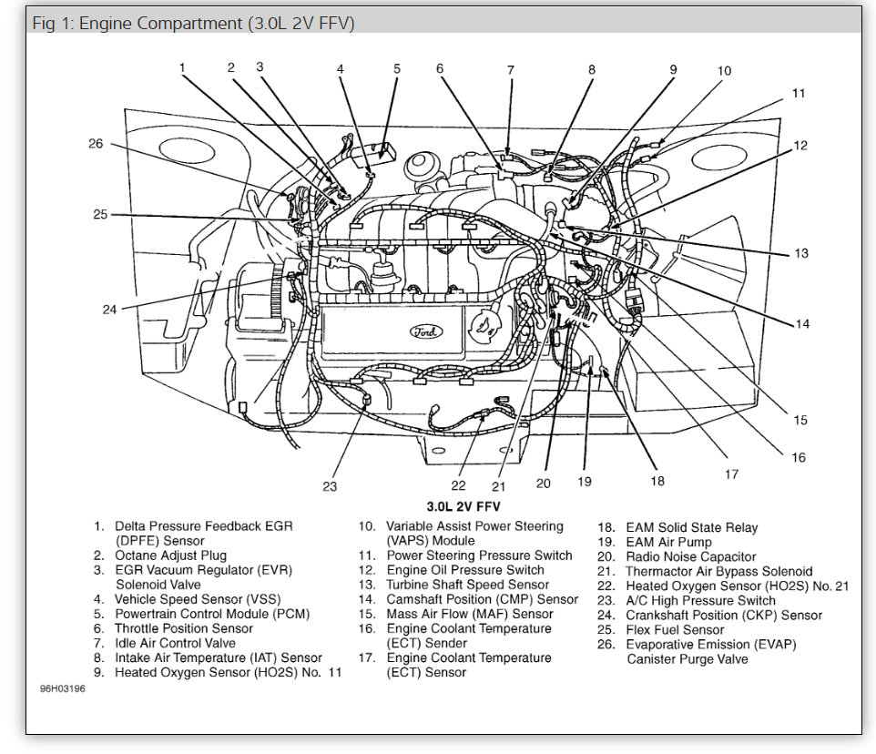

i just got a new transmission put in this car 2 months ago and now they told me my speed sensor is out. i am wanting to know where this is located and is it easy to change?

The vehicle speed sensor is located on the transmission near the CV axle input. Here is a diagram below showing you the location #4. Check out the diagrams (Below). Please let us know if you need anything else to get the problem fixed.
