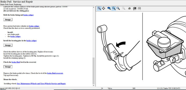

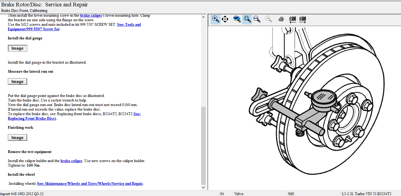

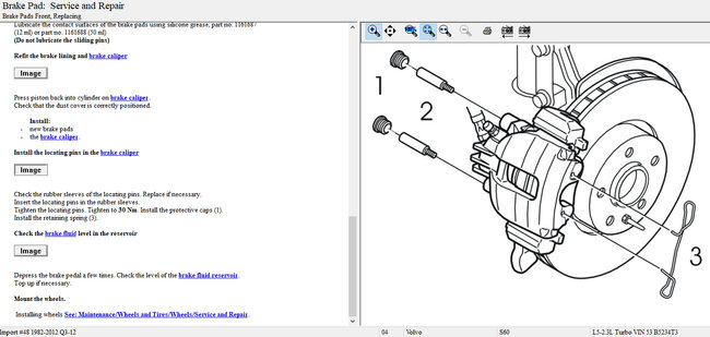

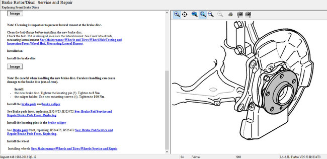

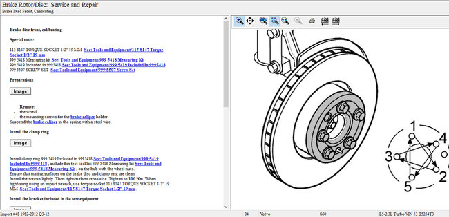

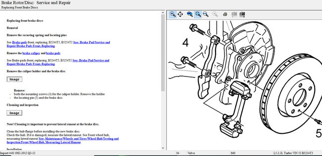

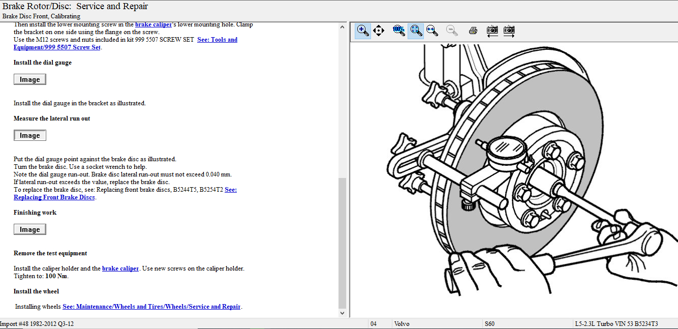

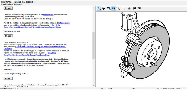

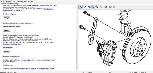

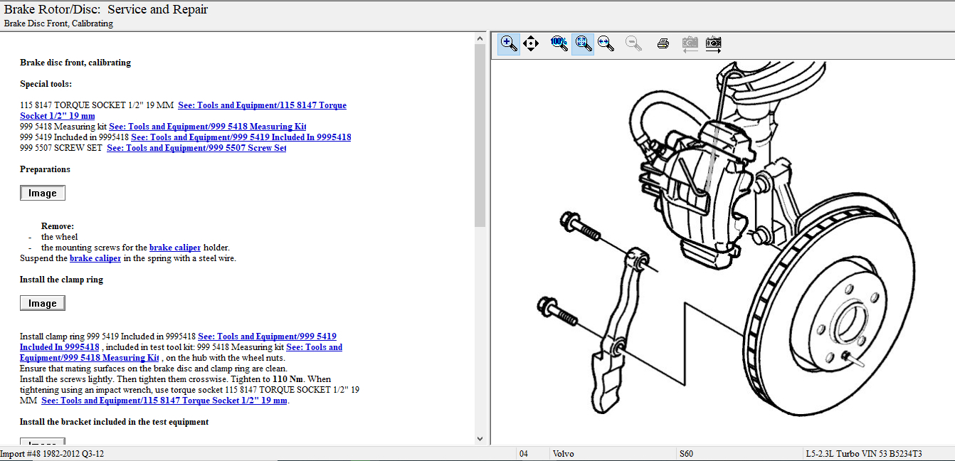

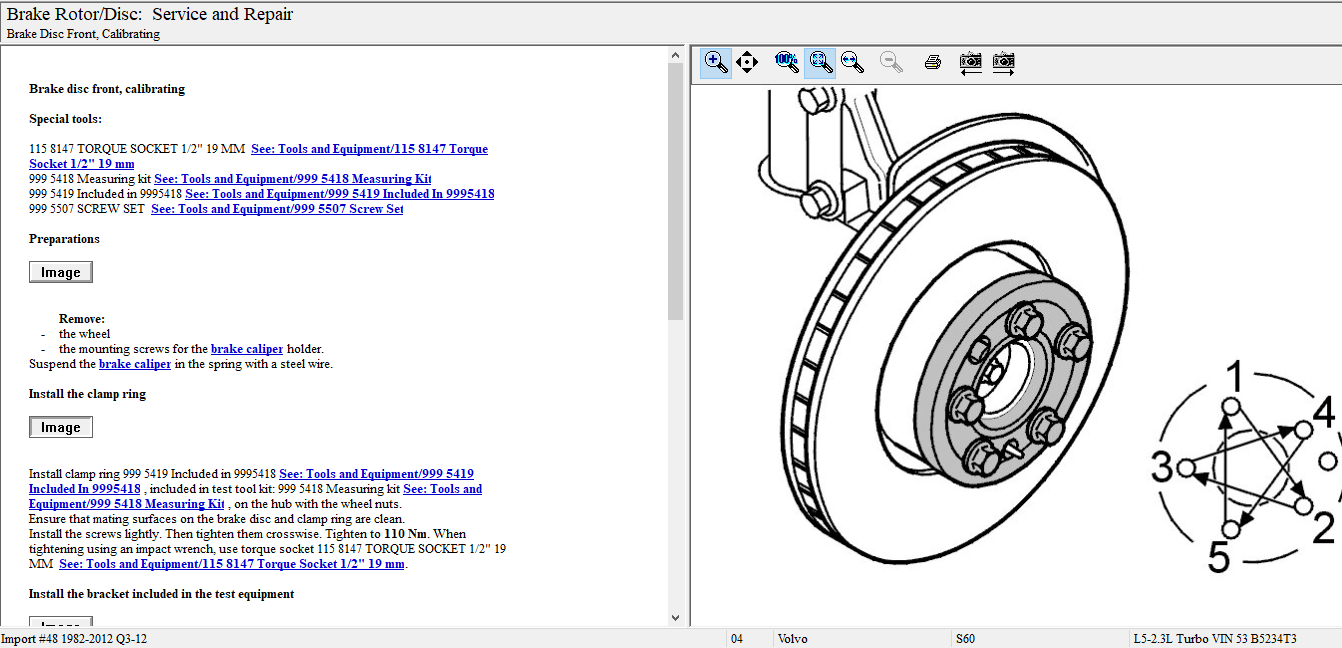

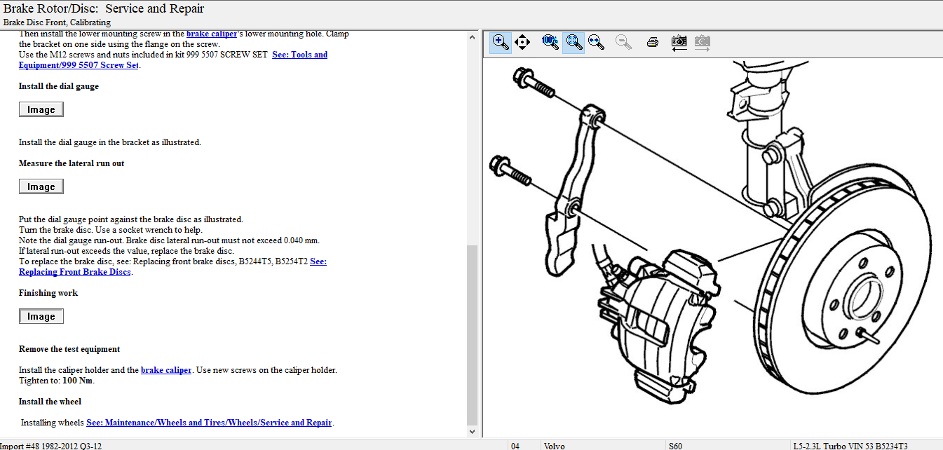

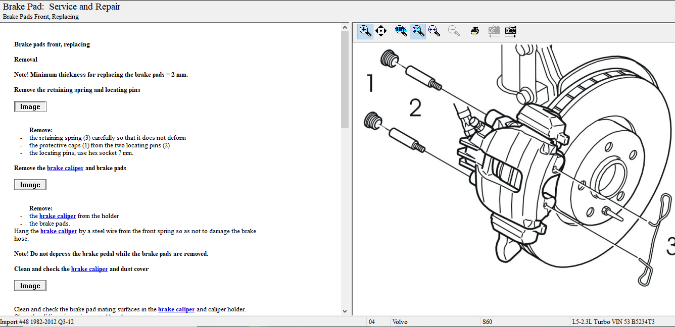

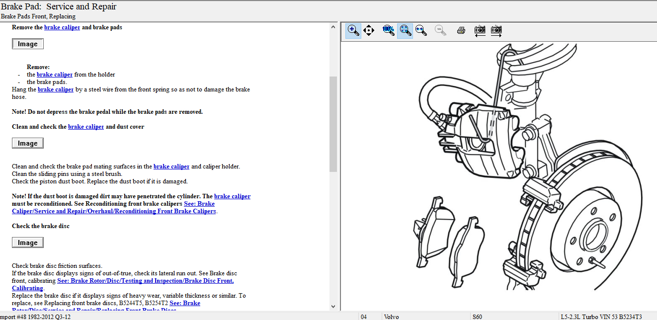

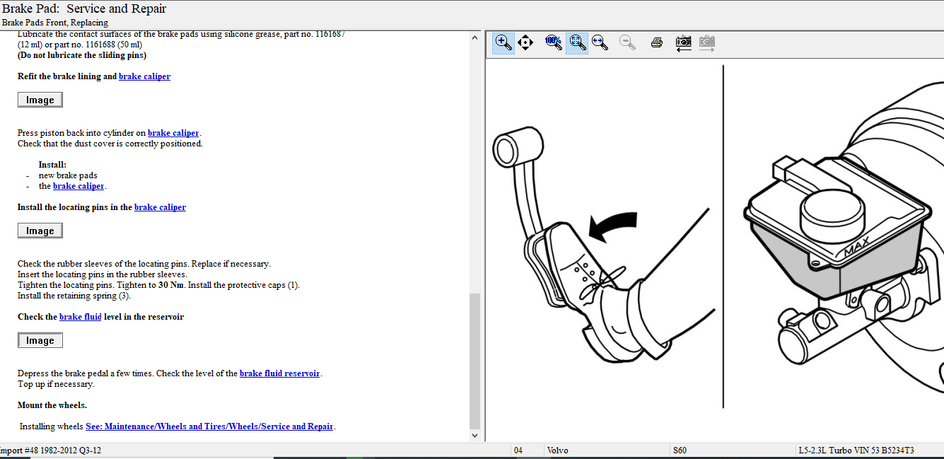

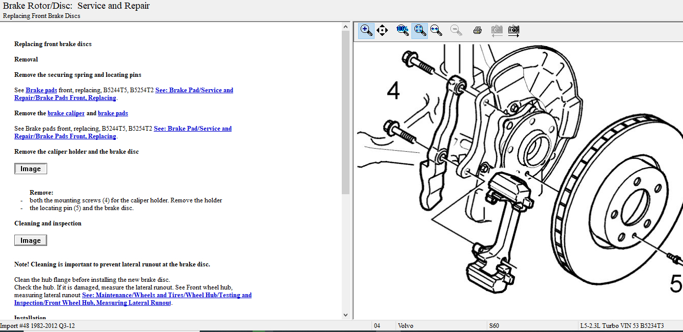

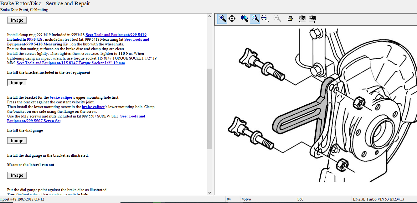

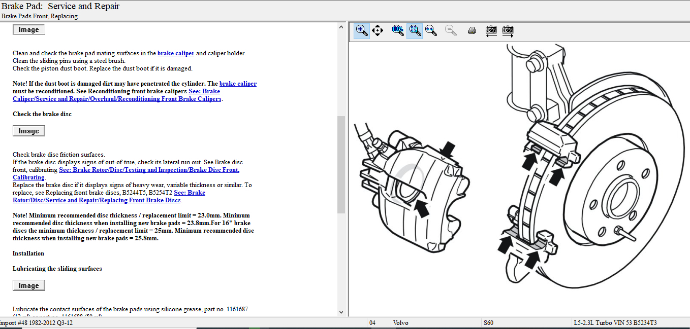

hello,

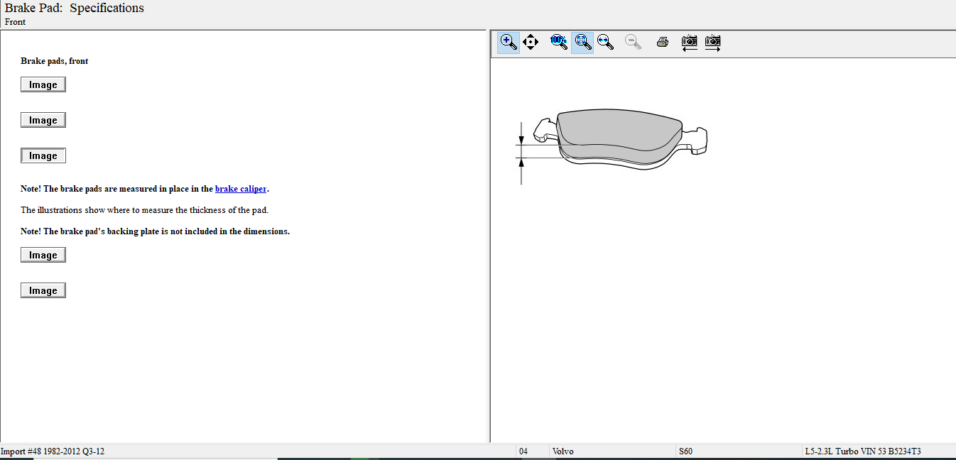

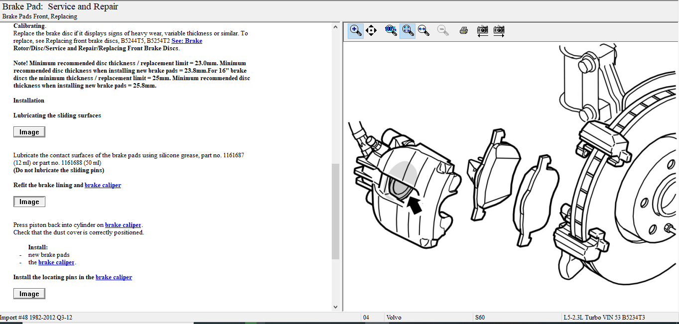

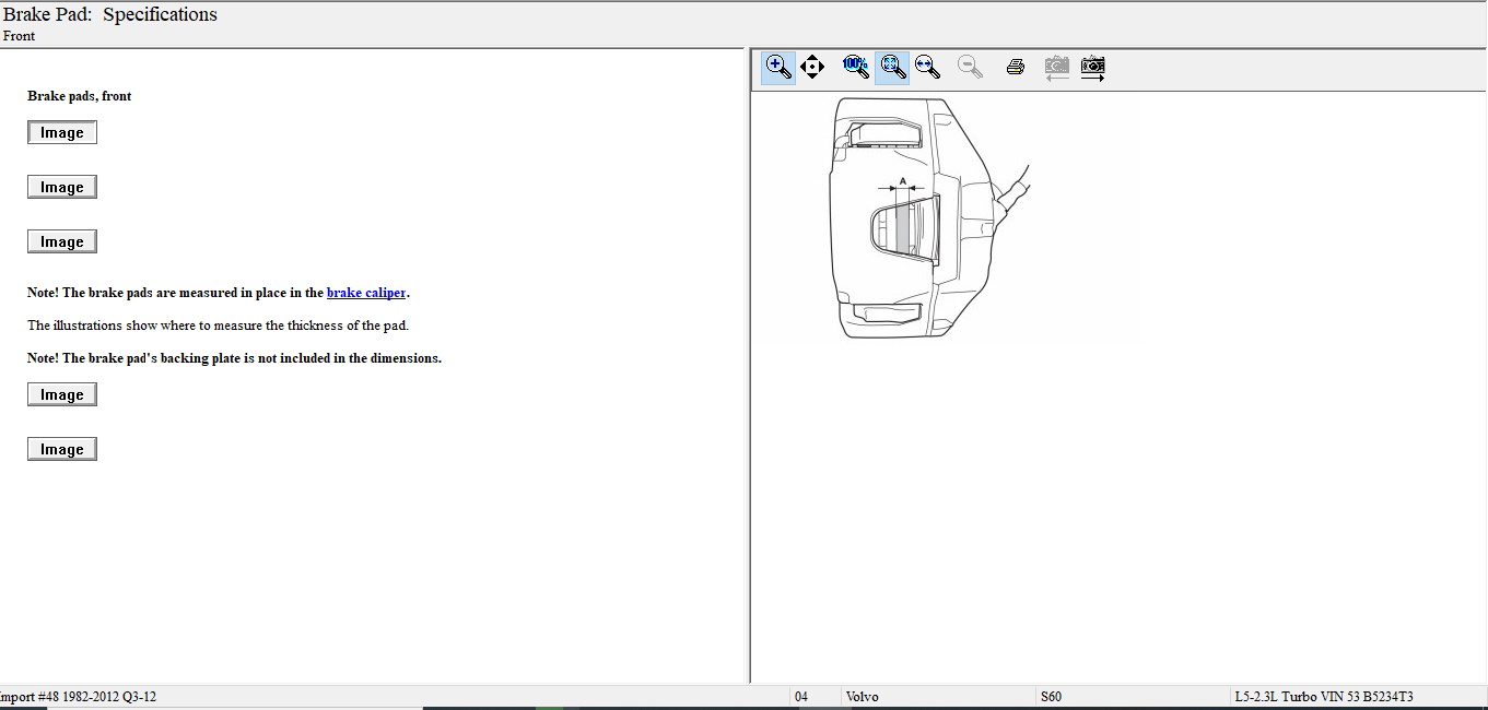

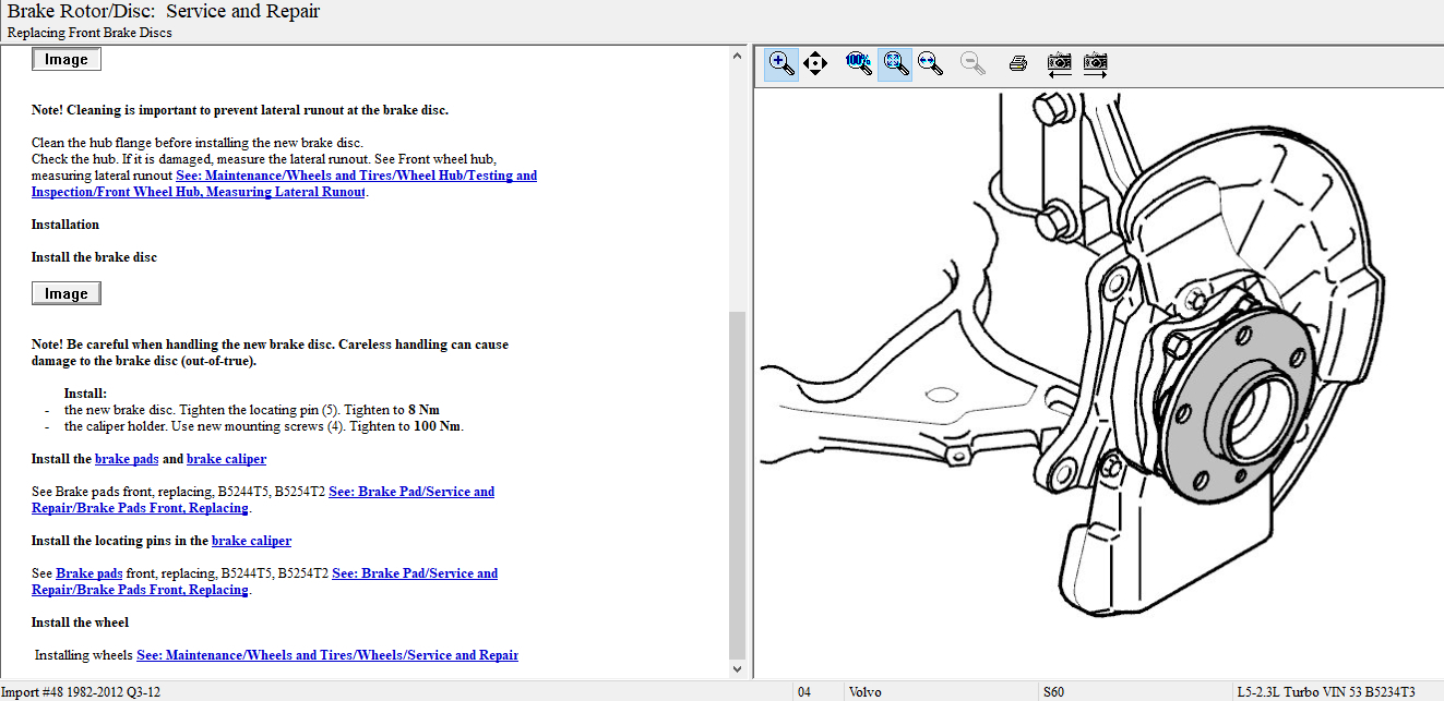

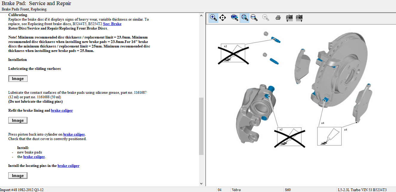

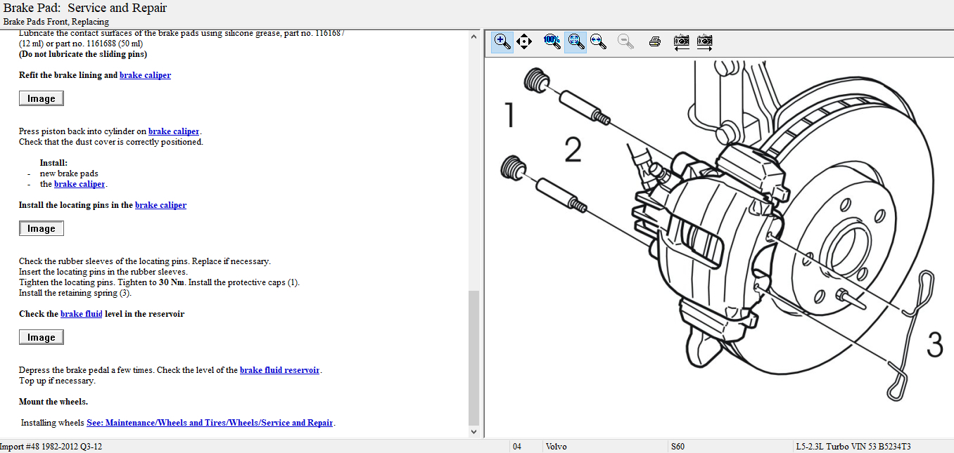

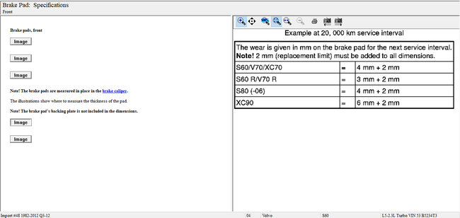

Vibration while braking sounds like front rotors has excessive runout must be replaced with front pads.
check our link below how to replace front brake discs and pads
Check the diagrams below how to replace the pads and discs with the calibration and the rotor lateral run out test.
hope these helps.
thank you.
