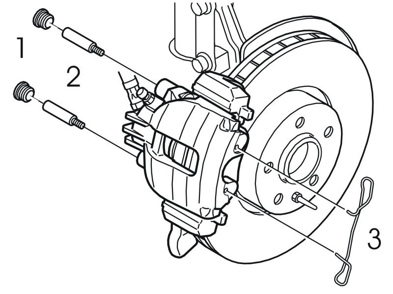

Remove the retaining spring and locating pins
pic 1
Remove:
- the retaining spring (3) carefully so that it does not deform
- the protective caps (1) from the two locating pins (2)
- the locating pins, use hex socket 7 mm.

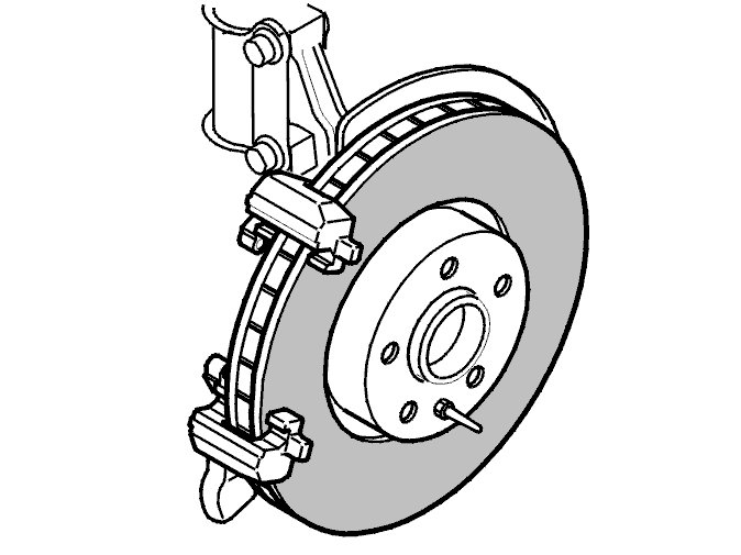

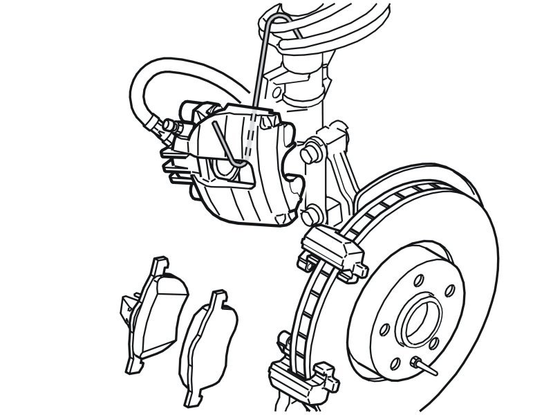

Remove the brake caliper and brake pads
pic 2
Remove:
- the brake caliper from the holder
- the brake pads.
Hang the brake caliper by a steel wire from the front spring so as not to damage the brake hose.
Note! Do not depress the brake pedal while the brake pads are removed.

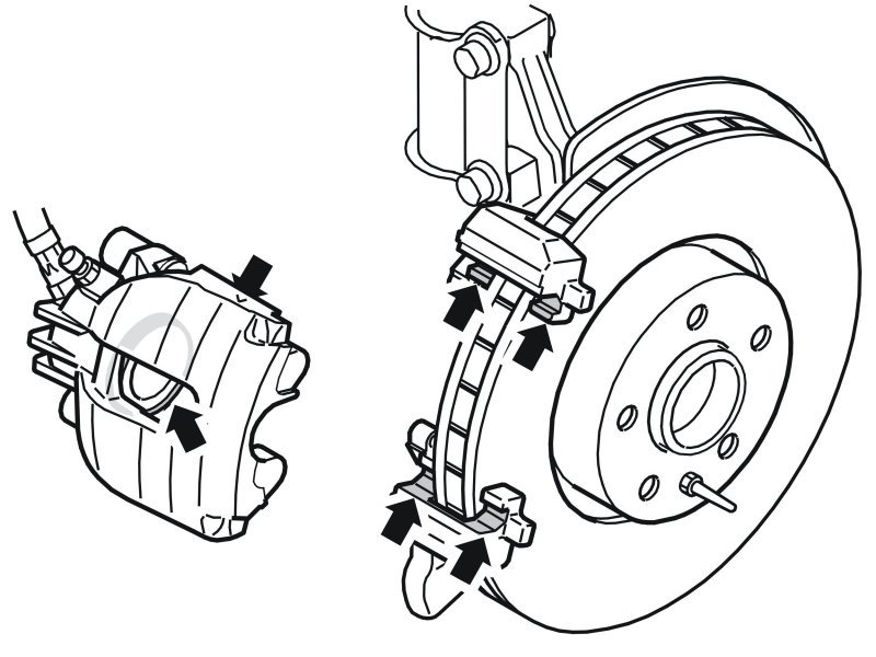

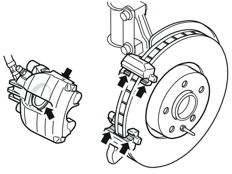

Clean and check the brake caliper and dust cover
pic 3
Clean and check the brake pad mating surfaces in the brake caliper and caliper holder.
Clean the sliding pins using a steel brush.
Check the piston dust boot. Replace the dust boot if it is damaged.
Note! If the dust boot is damaged dirt may have penetrated the cylinder. The brake caliper must be reconditioned. See Reconditioning front brake calipers See: Brake Caliper > Overhaul > Reconditioning Front Brake Calipers.
Check the brake disc
pic 4
Check brake disc friction surfaces.
If the brake disc displays signs of out-of-true, check its lateral run out. See Brake disc front, calibrating See: Brake Rotor/Disc > Component Tests and General Diagnostics > Brake Disc Front, Calibrating.
Replace the brake disc if it displays signs of heavy wear, variable thickness or similar. To replace, see Replacing front brake discs, B5244T5, B5254T2 See: Brake Rotor/Disc > Removal and Replacement > Replacing Front Brake Discs.
Note! Minimum recommended disc thickness / replacement limit = 23.0mm. Minimum recommended disc thickness when installing new brake pads = 23.8mm.For 16" brake discs the minimum thickness / replacement limit = 25mm. Minimum recommended disc thickness when installing new brake pads = 25.8mm.

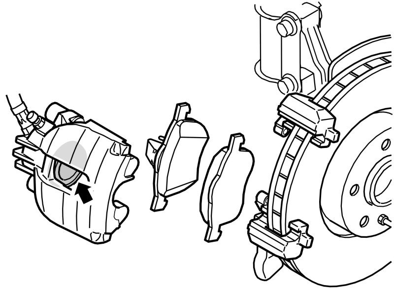

Lubricating the sliding surfaces
pic 5

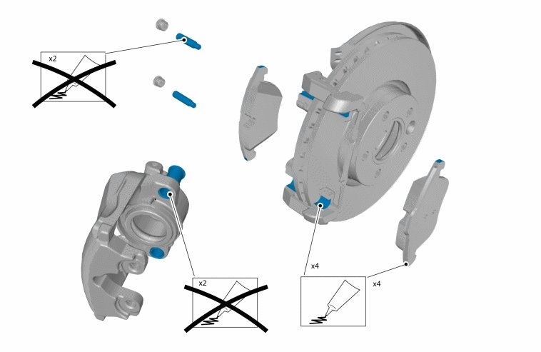

Lubricate the contact surfaces of the brake pads using silicone grease, part no. 1161687 (12 ml) or part no. 1161688 (50 ml)
(Do not lubricate the sliding pins)

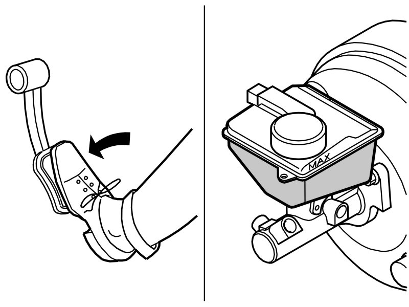

Check the brake fluid level in the reservoir
pic 8
Depress the brake pedal a few times. Check the level of the brake fluid reservoir.
Top up if necessary.

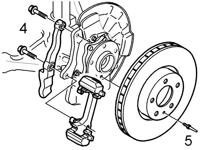

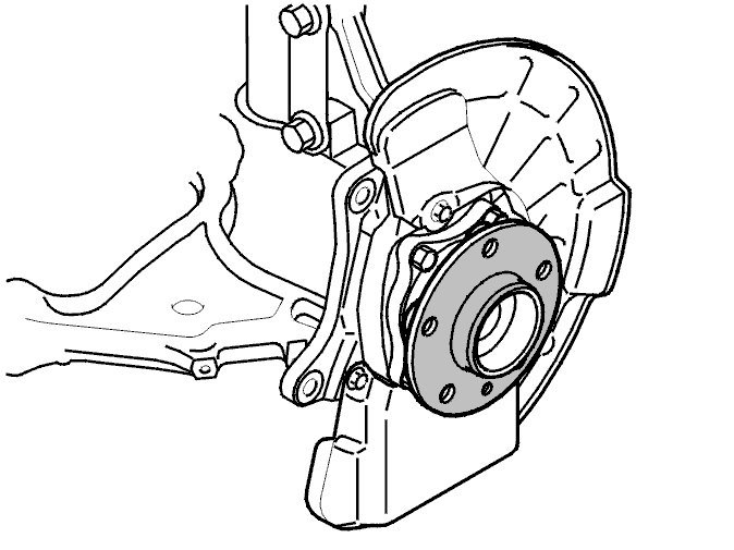

Remove the caliper holder and the brake disc
pic 9
Remove:
- both the mounting screws (4) for the caliper holder. Remove the holder
- the locating pin (5) and the brake disc.
Cleaning and inspection
pic 10
Note! Cleaning is important to prevent lateral runout at the brake disc.
Clean the hub flange before installing the new brake disc.
Check the hub. If it is damaged, measure the lateral runout. See Front wheel hub, measuring lateral runout See: Wheel Hub > Component Tests and General Diagnostics > Front Wheel Hub, Measuring Lateral Runout.

Install the brake disc
pic 11
Note! Be careful when handling the new brake disc. Careless handling can cause damage to the brake disc (out-of-true).
Install:
- the new brake disc. Tighten the locating pin (5). Tighten to 8 Nm
- the caliper holder. Use new mounting screws (4). Tighten to 100 Nm.
