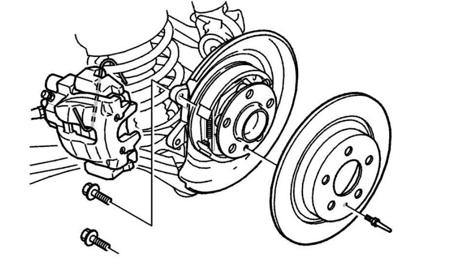

Removal
Removing the brake disc
Remove:
- the wheel
- the 2 mounting screws for the brake caliper holder. Hang the brake caliper from the spring using a wire
- the locating pin and the brake disc.

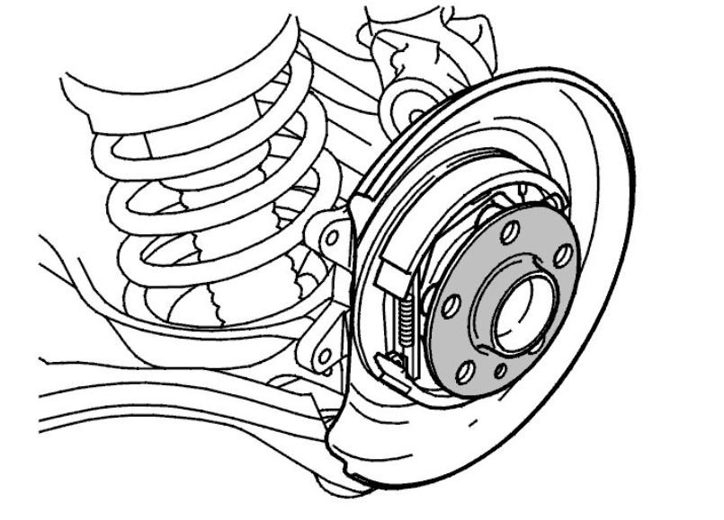

Cleaning and checking
Note! Cleaning is important to prevent lateral run out at the brake disc.
Clean the hub flange before installing the new brake disc.
Check the hub. If it is damaged, measure the lateral run out. See: Rear wheel hub, measuring lateral runout See: Wheel Hub > Component Tests and General Diagnostics > Rear Wheel Hub, Measuring Lateral Runout.

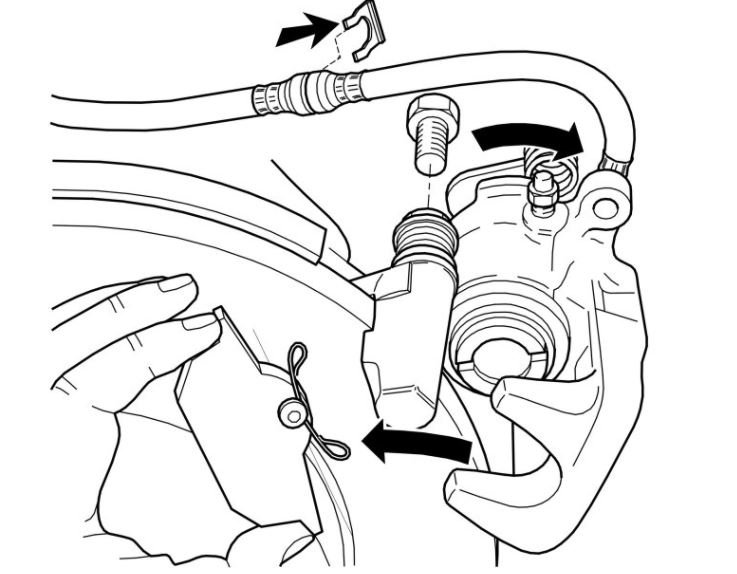

Brake pads rear, removing
Remove
- the hub cap and the wheel.
- the attaching clip and the brake hose from the support.
- the top bolt from the brake caliper's guide pin.
Turn the brake caliper backward and remove the brake pads.
Note! Do not press down the brake pedal when the brake pads are removed.

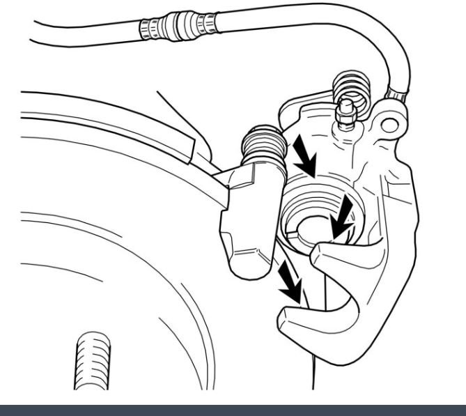

Brake caliper rear, checking and cleaning
Clean the brake pads' contact surfaces in the brake caliper and on the caliper bracket.
Check the piston's dirt cap.
Replace the dirt cap if it is worn. If the dirt cap is defective (broken), the brake caliper has to be overhauled. See Reconditioning rear brake calipers See: Brake Caliper > Overhaul > Rear Brake Caliper Reconditioning.
Note! If the dirt cap is defective (broken), dirt may have entered the cylinder. Therefore, the brake caliper has to be overhauled.
Brake disc rear, checking
Check the brake disc's surface. Check the brake disc's lateral run-out (warping) if the disc is uneven. Change the brake disc if it is very worn or if there is scoring. See Replacing rear brake discs See: Brake Rotor/Disc > Removal and Replacement > Replacement Of Rear Brake Disc.

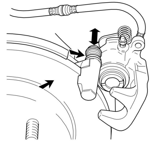

Guide pins for brake caliper rear, checking
Check the guide pins' rubber sleeves. Change these as needed. If needed, lubricate the guide pins with Volvo silicone grease (part number 1161325-4) and insert them in the rubber sleeves. The guide pins shall slide easily in the sleeves.

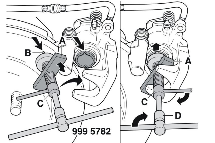

Turning back the brake piston
- Block the brake caliper against the brake disc. Use special tool 999 5782 Press tool See: Vehicle > Electrical / Mechanical Repair > 999 5782 Press Tool.
- Turn the plate (A) forward over the spindle and insert the tool.
- Install the pins (B) in the brake piston's slot.
- Turn the spindle (C) so that the plate (A) is pressed against the brake caliper.
- Turn the shaft (D) to the right and press back the piston and, at the same time, turn on the spindle (C) to the right, so that the plate (A) is in contact with the brake caliper.
- Turn back the brake piston completely and remove the tool.
