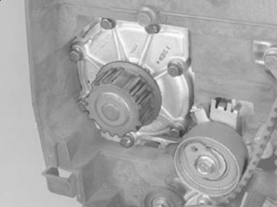

Removing the coolant pump
https://www.2carpros.com/forum/automotive_pictures/12900_waterp3_1.jpg
*Remove the screws
tap the pump wheel using the shaft of a hammer. *Remove the pump
*clean the gasket faces thoroughly.

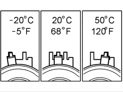

Tension the timing belt
NOTE: This adjustment is to be made with a cold engine. Suitable temperature is approximately 20 degree C/67 degree F .
At higher temperatures (with the engine at operating temperature or a high outside temperature for example) the indicator is further to the right.
https://www.2carpros.com/forum/automotive_pictures/12900_waterp6_1.jpg
The above figure shows the position of the indicator at different engine temperatures.

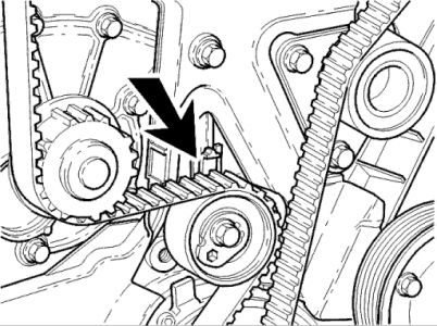

*Carefully turn the crankshaft clockwise until the timing belt is tensioned. The belt must be tensioned between the intake camshaft pulley, the idler pulley and the crankshaft
https://www.2carpros.com/forum/automotive_pictures/12900_waterp7_1.jpg
*Hold the belt tensioner center screw secure. Turn the belt tensioner eccentric counter-clockwise until the tensioner indicator passes the marked position.
Then turn the eccentric back so that the indicator reaches the marked position in the center of the window
*Hold the eccentric securely. Tighten the center screw. Tighten to 20 Nm .
Check that the indicator is in the correct position.

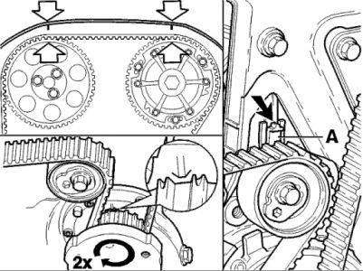

Check
Checking markings
https://www.2carpros.com/forum/automotive_pictures/12900_waterp8_1.jpg
*Press the belt to check that the indicator on the tensioner moves easily
*Install the upper timing cover
*Turn the crankshaft two turns. Check that the markings on the crankshaft and camshaft pulley correspond.
NOTE: Check that the indicator on the belt tensioner is within the marked area.

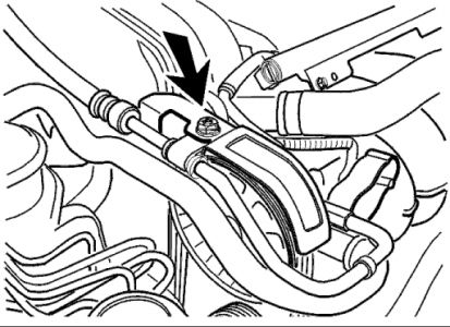

Finishing
Remove the lifting beam and lifting hook.
Install:
https://www.2carpros.com/forum/automotive_pictures/12900_waterp11_1.jpg
*the metal bracket for the power steering hose on the rotation protection for the auxiliaries belt
*the front wheel
*the auxiliaries belt.
